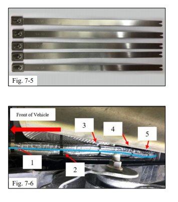

    I reviewed the instructions which are pretty clear overall. I have two questions. 1) Which area gets the metal wire ties? The photos are a little bit unclear. I was looking for a diagram with all of the wire tie locations, but if there is one, I've missed. 2) What kind of sealant is that? Is it a RTV sealant or something specific to Toyota?

    The portion of the harness which is wrapped in a tinfoil-like thermal insulation (looks a little space-suit-ish) would be where you use the 4 or 5 metal zip ties. It's fairly obvious, there's a muffler nearby. You won't have much of any trouble figuring this out once you're underneath the truck.

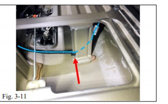

    The sealant is to prevent corrosion I believe, it's a 3m product and you only need a very small dab of it. I bought the tube but I sort of wonder why I did. I think it might have been better to do one zip tie on the strut itself, cinched pretty tight then two zip ties securing the harness to that zip tie, one at the top, one at the bottom. That would have accomplished the same thing but without the metal clip and probably would have looked cleaner too, though this is all inside the skin so who really cares.
    Not sure how clear my description is but my thought was a larger zip tie from the red arrow point directly towards the bed/front of the truck then two zip ties securing the harness to that primary zip tie at the two sides of this metal piece. Looking at the photo more closely, though, you might need 2 of the longer zip ties, one for entry, one for exit, since the blue dashed line would follow the harness path. And I suspect you'd probably need longer zip ties than what was supplied, though purchasing long zip ties seems as easy or even easier than that 3M sealant and most likely fairly cheaper / more general purpose.
    I haven't found any use for the 3M sealant since using it for this.
