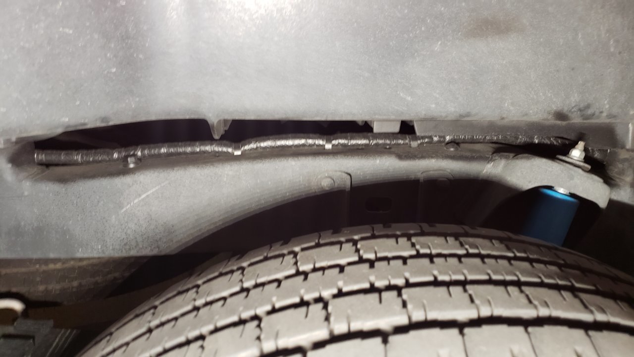

  10. Oct 23, 2020 at 12:56 PM
    #570
    3r3Taco
    3r3Taco Well-Known Member
    Jun 24, 2020
    #332440
    196
    So.Cal
    17 SR5 DCSB
    Factory Stock
    Here is how i routed and secured it to the frame. I didnt like the heat sheild so it hit it w some flat black paint.

  11. Oct 23, 2020 at 12:56 PM
    #571
    chstaco

  14. Oct 23, 2020 at 12:59 PM
    #574
    HisDad
    HisDad Well-Known Member
    Mar 30, 2015
    #152127
    2,521
    Texas at last
    2019 Cement Tacoma SR5 Double Cab
    That would make sense, I guess. Since mine is a SR5, it has no harness on the right side.
    I was just a bit surprised that no one mentioned it before. Not that it would have changed my decision to buy it. I always lock my tailgate and got sick of having to do it manually.
    deusxanime likes this.
  15. Oct 23, 2020 at 1:00 PM
    #575
    3r3Taco
    Jun 24, 2020
    #332440
    196
    So.Cal
    17 SR5 DCSB
    Factory Stock
    Yeah I secured using all pre existing holes.
  16. Oct 23, 2020 at 1:15 PM
    #576
    HisDad
    Mar 30, 2015
    #152127
    2,521
    Texas at last

  17. Oct 23, 2020 at 3:44 PM
    #577
    Tacodelphia
    Tacodelphia Well-Known Member
    Aug 19, 2020
    #338182
    105
    David
    Philly
    2020 TRD OR MT Cement
    I like the paint, the reflective foil section is pretty visible if you’re lookin.

    Follow up to my previous posts on installing the cable in trucks without a cable on the right side of the truck. The stainless steel wire ties showed up today and the weather was okay. The ones I got are a bit longer than the OEM ones. More importantly, they are also a bit more narrow. As a result, they fit neatly in the holes on top of the frame. I added three, including one at the front of the area where the foil starts. For that one, I used two straps end to end and went around the frame. Now, the cable is nice and secure and away from the exhaust.
