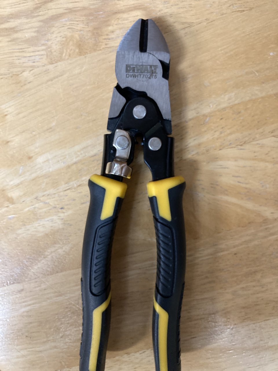

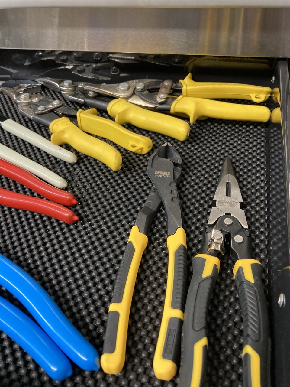

    Yes, I cut the metal ties after tightening them using tinsnips.
    I have since purchased some 8” wire cutters which might have made the plastic tie cutting easier. I’m not sure how they would fare with the metal ties. Tinsnips worked fine but the jaws are big so I have a bit of extra length.
    Also, I have no idea how I wound up with multiple sets of tinsnips. But figure others can have a fun laugh at my expense.

    Thanks Dave, I’d say that I have pretty much the same collection as you!

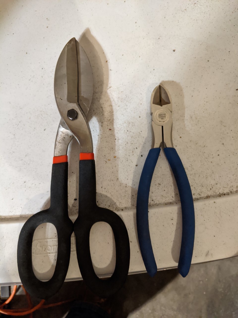

    I tried to cut the metal ties with my bigger pair of dikes (on the right), but could not get through them, especially since I was having a hard time getting in there to get a good angle and leverage. I ended up digging out these massive pair of snips (on the left) and was able to cut them with that. The angle wasn't perfect but they were so big they powered through anyway!
    And yes I have a pile of various dikes and snips too! Not sure where most of them came from even.
