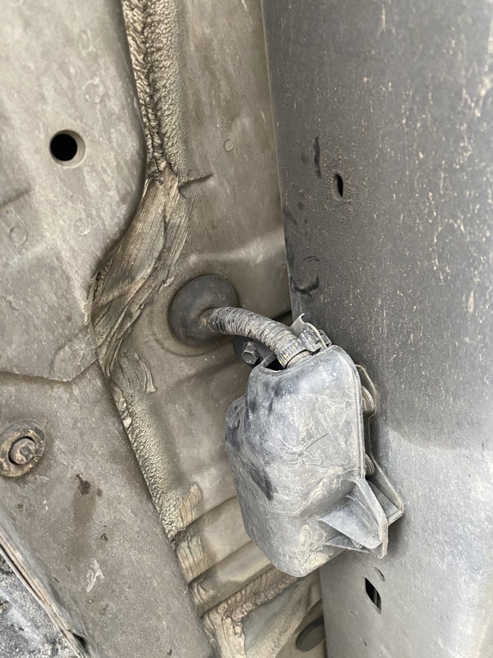

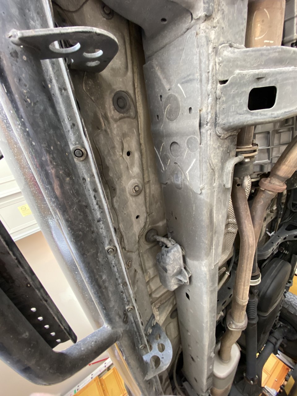

    FC010CB2-DDAB-42B4-AF85-D82D3AF430CC.jpg Anyone know what this harness is? Body grommet is occupied with that. Cut a slit next to it to feed tailgate harness through?
    That grommet is larger than the one preinstalled on the tailgate harness but the one pictured is the one near the passenger seat unless I’m missing something

    Wrong hole.
