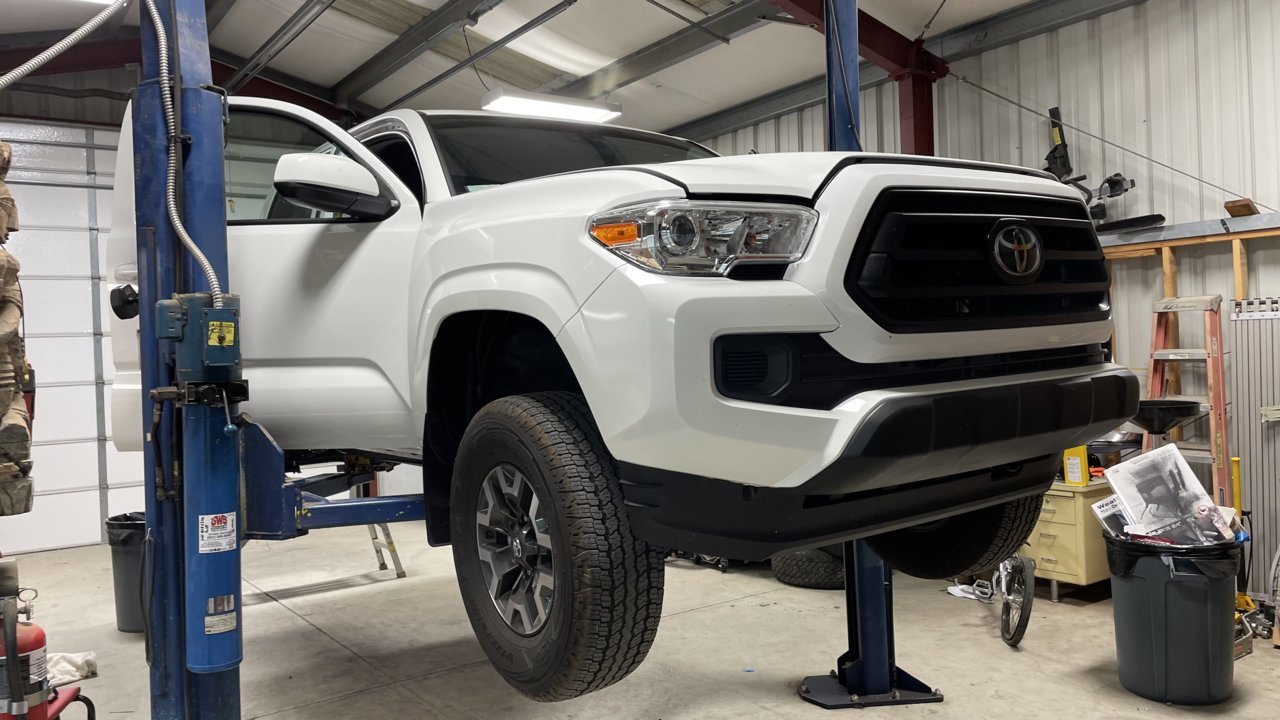

    OK this video was a HUGE help! I’m off to go do mine on my lift……ok well after the Caps and Bruins game is over!
  16. May 19, 2021 at 9:48 PM
    #676
    andersen24
    andersen24 Well-Known Member
    May 1, 2021
    #364429
    131
    Andy
    Pismo Beach, CA
    2021 Tacoma SR DCSB V6 4X4
    OK well my Caps lost, but hey - with the help of my lift, I got the locking tailgate installed in about a half hour. You guys weren’t kidding about the quality of the kit. Literally everything was spot on! Was nice to be able to sit and roll underneath to run the wiring. I didn’t have any wiring on the passenger side, but went ahead and tucked it all in the frame. 78B0EA06-1577-4D2D-B28E-320E3AC72D79.jpgDE78EC3B-567B-4D38-B487-C63853F07DDD.jpg
