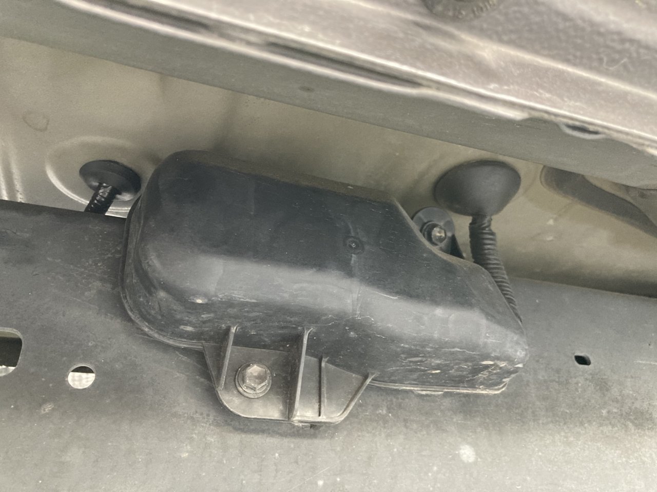

    Is this the grommet under the passenger seat that everyone uses to run wires into the cab? I can't find it for the life of me and I've been searching for a pic. Jackpot??

    The one to the rear of the truck, left in the pic looks like the correct one.
    When you feel under the carpet it's just under the passenger seat 2/3 of the way front to back. I popped out the wrong one first on my SR5. I had two grommets the larger one that's more forward is the wrong hole. You want the one that is smaller and a bit more to the rear and inboard a little. Hope that makes sense.

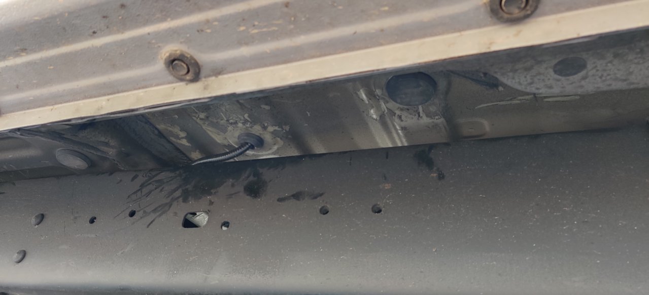

    Here
    Look where mine has the wire coming out that is the spot. Not the larger hole. IMG_20210623_130943.jpg

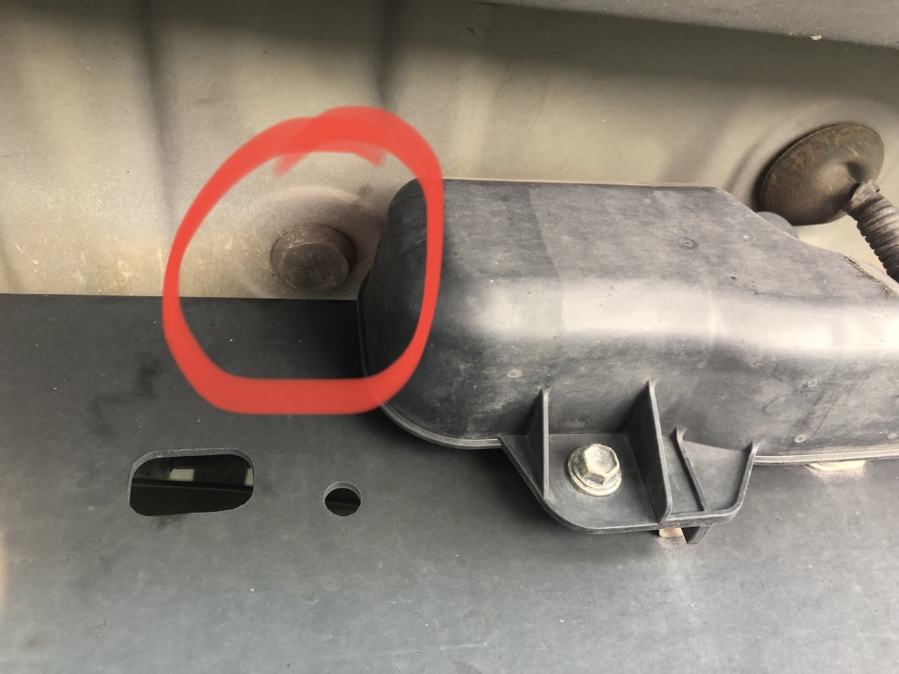

    Cool. Thought I found it but it’s not what I circled, it’s the smaller one to the left of what I circled (left if looking at the passenger side of the truck).
    Just pop it off with a flat head? Cut an X, run wire through, reattach grommet?

    That's the grommet that the OEM tailgate kit uses. If you run your lighting wires through that grommet you will have to move your wiring if you ever decide you want the OEM power lock.
