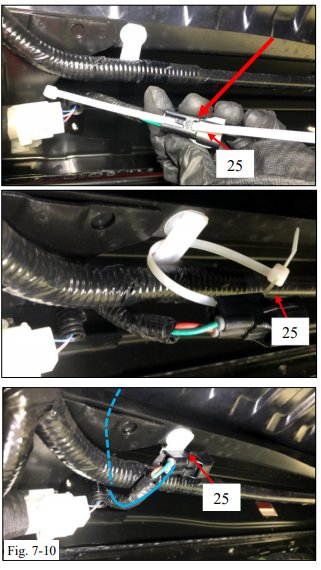

  16. Dec 13, 2022 at 8:50 AM
    #716
    Comm_Guy
    Comm_Guy Well-Known Member
    Oct 24, 2022
    #408791
    102
    Brian
    Vero Beach, FL, USA
    ‘22 Tacoma TRD Sport DCSB
    All about making it more useful, Bed Lights, Power Tailgate Lock, Flat Aluminum Tailgate Cover, Leer Topper with added lighting, Ham Radio, 12V Outlets in bed, 400W Anytime Outlet, Meso Customs Stealth Shifter Knob & Dual Color Cab lights, and bed mounting and organizations.
    Ok it's not just me! After I finished the install I was like "Toyota put these connectors on backwards!" since then I've been reading though pages and pages to see if it was only me. Unfortunately I didn't notice till after it was installed but I'm going to cut them off a few inches back and swap them or my OCD will drive me nuts. I looked at ordering new connectors but it seems like a huge PITA so swapping them with marine grade butt connectors and putting the split loom back over will have to do.

  17. Dec 13, 2022 at 10:39 AM
    #717
    daveeasa
    daveeasa FBC Harness Solutions
    May 14, 2020
    #328079
    7,484
    David
    PNW
    2016 Tacoma OR DCSB 6MT, 2005 RC 5MT PreRunner, 2002 Tundra SR5 RCLB 4x4
    That’s the easy way.
    I have since acquired all the tools and terminals so cut and re-crimp would now be how I’d do it today. Terminals are cheap, seals and connectors aren’t expensive either but can also be reused.
