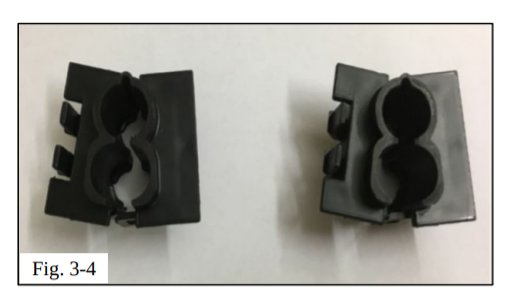

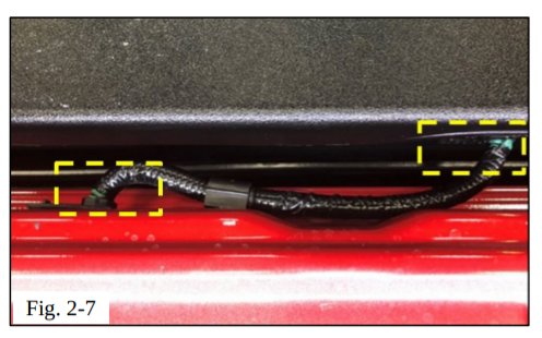

    @Bertw192 These clips fit okay as well? No modification to tail gate or bumper panel? Thanks.

    No modification needed. They fit as designed.

    I emplore you to take a look at my lesson learned here. I broke one of them installing them in upside down by following the Tacoma directions to the tee. This was the one step that lacked specificity.
