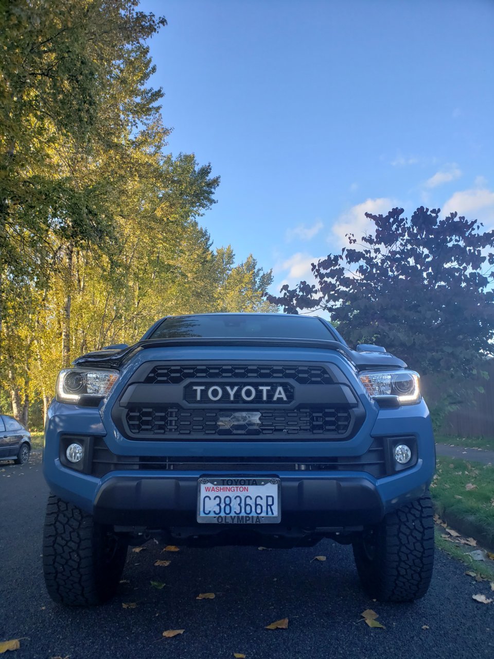

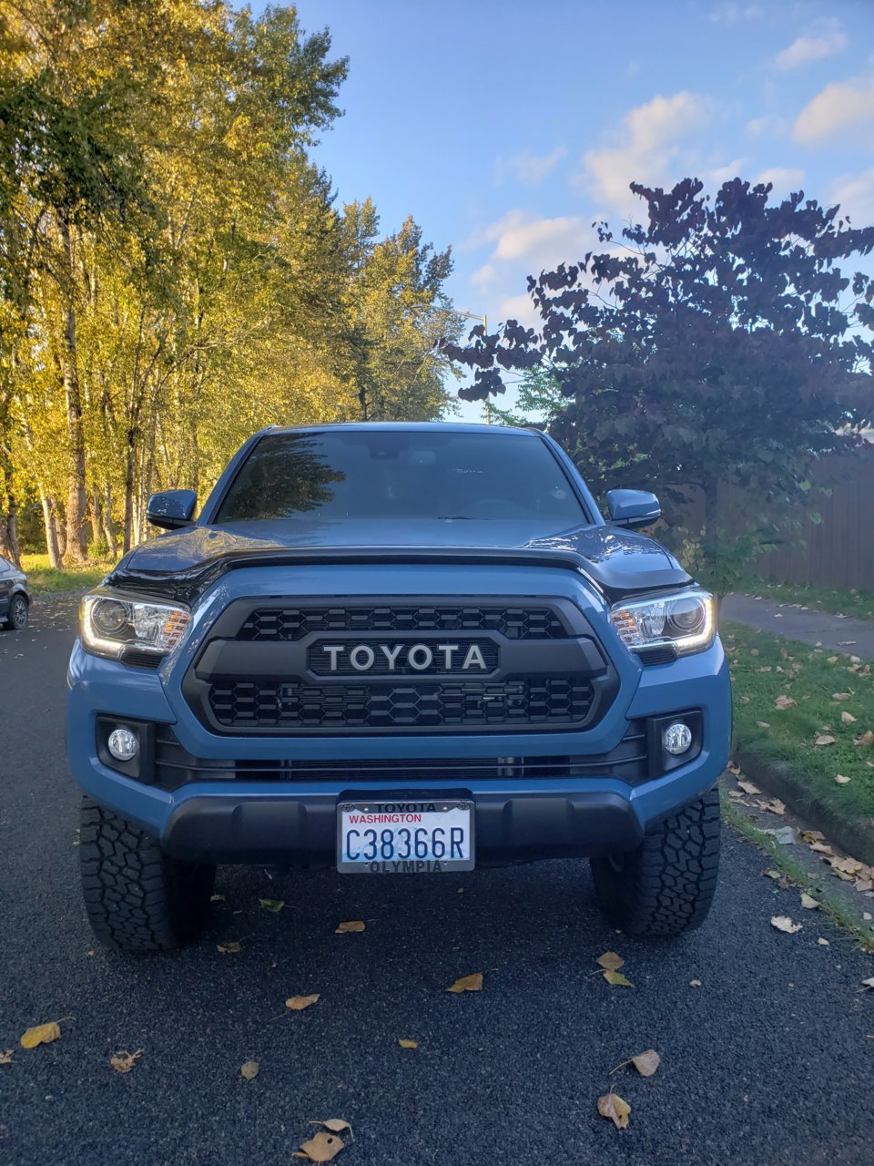

    I literally ordered the cheapest PRO one I could find on ebay, and bought a 45 garnish https://www.ebay.com/itm/Genuine-OE...e=STRK:MEBIDX:IT&_trksid=p2060353.m2749.l2649
    no issues, just make sure the TSS is secured.. any flopping, flexing or movement between it and the garnish will through an error. Initially, I only screwed it in with one screw(top screw.. because youtube) and it would throw an error after about 5 miles of driving. The TSS should be bolted on with 3 fasteners and not an error since.
    good luck!

    Heres a photo of it

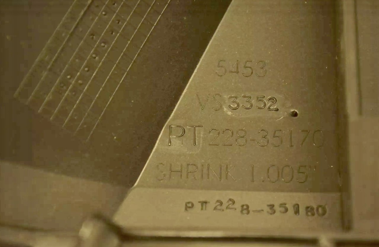

    I had the same issue as you and ended up purchasing and installing the ‘17 pro grille after purchasing an 18 grille from eBay that arrived damaged. The 18-19 grille is literally the same grill except for the garnish. In fact the 18-19 grill has the Base P/N PT 228-35170 stamped in the grille.
