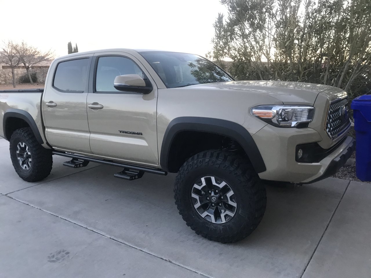

    Thanks, I got them from a local 4x4 shop here in town. Rock sliders with removable steps.

    All steps are removable if you use them as sliders :thumbsup:

    Lol, that’s definitely the harder way to do it though. I’d rather use a socket wrench... :cheers:

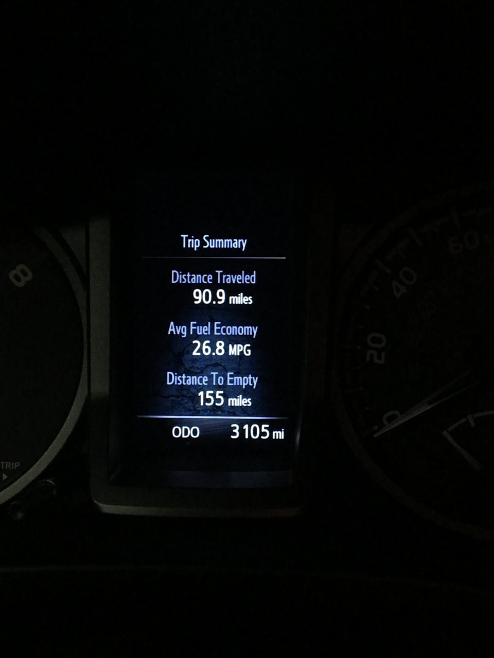

    19 2wd TRD sport DCSB with a bed cover, 91 mile drive doing 70, cruise on, flat ground with calm winds. Couple occasional overpasses in which it would downshift, clicking it over to S causes it to do that less often I noticed. Beyond that, as you can see, I can’t complain.
    Had a bit of a rough up shift In the beginning I noticed when cold and took it to the dealer. I suspected low tranny fluid as I’ve had a vehicle behave like that once and that was the issue. Got the usual, “Uhh, it’s normal at the dealer. So I went to the parts department and bought a quart and latter added it the next day with it cold while doing the temp check mode thing with the shifter and the overflow bolt. It took almost 3/4 of that quart. Not a single harsh shift since, imagine that
