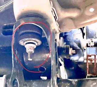

    Front frame bushings go out on these vehicles (search the 3rd gen forum) and they generate a metal to metal clank noise. I can only guess that our rough dirt ranch road driving beats on these bushings 2018 Sport I previously owned experienced the same issue at 95K miles.
    (Borrowed this pic from another posting)
