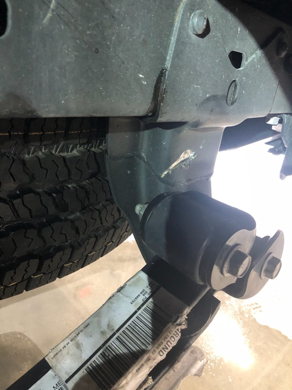

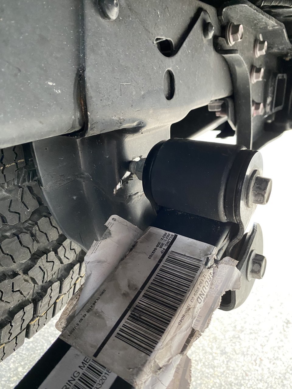

  10. Feb 6, 2021 at 1:45 PM
    #30
    Saltysack
    Saltysack [OP] Well-Known Member
    Jan 9, 2021
    #352199
    60
    Richard
    Loads of yotes
  11. Feb 6, 2021 at 2:01 PM
    #31
    don74
    don74 Well-Known Member
    Feb 3, 2017
    #209552
    47
    Donald
    2016 TRD Sport DBLC 4X4
    Fox / TRD
    try put the bolt on the reverse position (means opposite position)

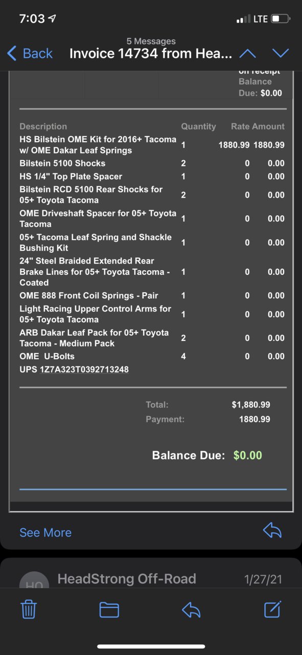

  19. Feb 6, 2021 at 4:07 PM
    #39
    Saltysack
    Jan 9, 2021
    #352199
    60
    Richard
    Loads of yotes
  20. Feb 6, 2021 at 4:10 PM
    #40
    Saltysack
    Jan 9, 2021
    #352199
    60
    Richard
    Loads of yotes
    Yes..complete kit. See reciept
