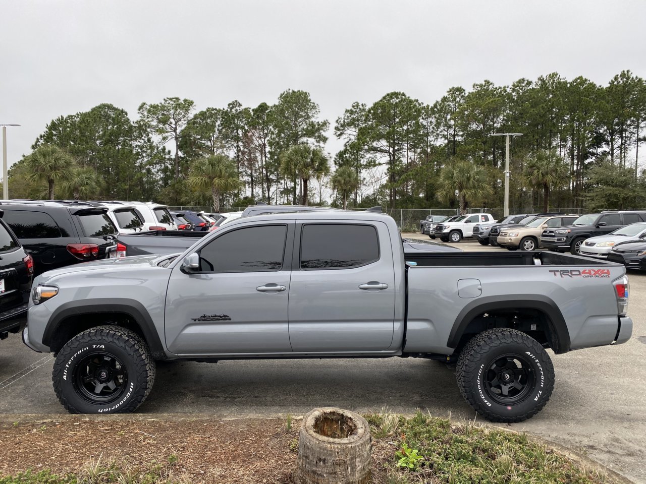

    Already spoke with them, being 50 miles away mid day Saturday couldn’t, why I went to closer dealer. After seeing this shitty work I don’t trust them fooling with my brakes! Toyo dealer said if outside company messes w abs they will not cover any future brake issues shall they arise. My company spends a lot of money with this local shop who has 12 locations so assuming they will make it good.

    Verdict...as many said!
    both abs sensors were stretched and rear leaf bolts backwards. Dealer r/r abs cables and recalibrated steering angle sensors..$633.00
    the shop who installed lift will pay the abs portion of the bill ($450.00) and fix bolts as well as realign. Rides great can’t imagine how the HD Springs would be as the med are stout!
