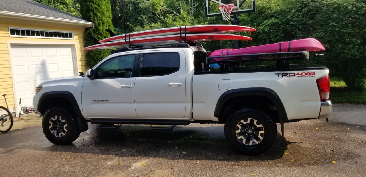

    60
    Update: I went with the Wheelers Progressive add a leaf out back (no helper spring) and moved the front to the top clip on stock coils. Moving to the top clip produced vibration after 3K miles in the front but the dealership correctly recognized it as the diff bearing TSB and authorized swapping the entire differential. I asked them if they would do the ECGS for me while the differential was on the bench and they did it for free ( I bought the bearing and the tools). This fixed the issue 100%.
    I don't have anything in terms of diff drops or carrier bearing drops and the truck drives absolutely fine (smoother/better than stock) at any speed and is completely smooth on the street and works well beach driving and light off roading.
    No rubbing anywhere. Perfect set up for me.
    20210726_090940.jpg . I even loaded it with a pallet of cobblestones a few times (overweight I know) from Home Depot and it handled it fine on the way home.
    It has a very slight rake to the front and I love how it drives. 10K miles later it has all settled in and sits just how I want.
