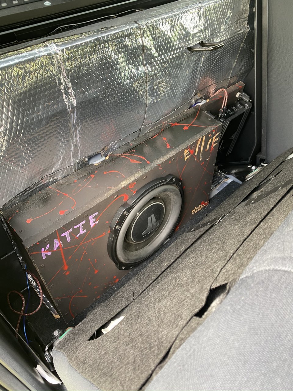

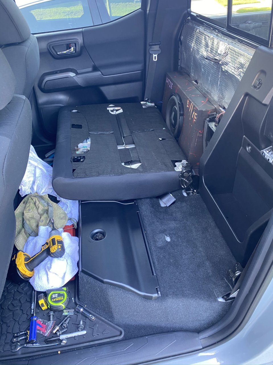

    Rear wall too. Super easy and made a big difference.

    I wanna quiet the rear wall. What exactly did you do?

    Was putting in a sub so I had the rear of the cab apart anyway. (Taking it apart is super easy). Just apply this Noico sound deadening mat. It sticks to the walls. Cut holes where need be with a razor. 10 ft.² is perfect for the rear wall.
    Noico 80 mil 10 sqft car Sound... https://www.amazon.com/dp/B01KZ5X7KO?ref=ppx_pop_mob_ap_share

    Chastaco, Thanks for the pics. That will definitely be my next project.
