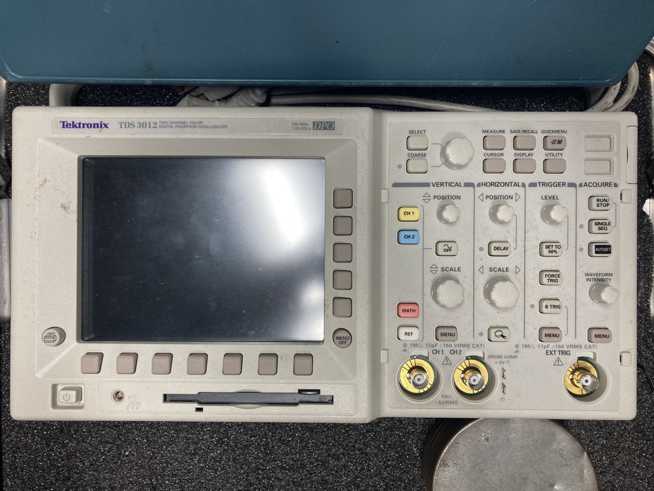

    Man that’s a much cleaner looking oscilloscope screen than my little handheld luimy I bought. What do you use for an o scope Dolby?

    It's a Tektronix TDS 3012, two channel color digital phosphor. It's so old it has a floppy drive!
