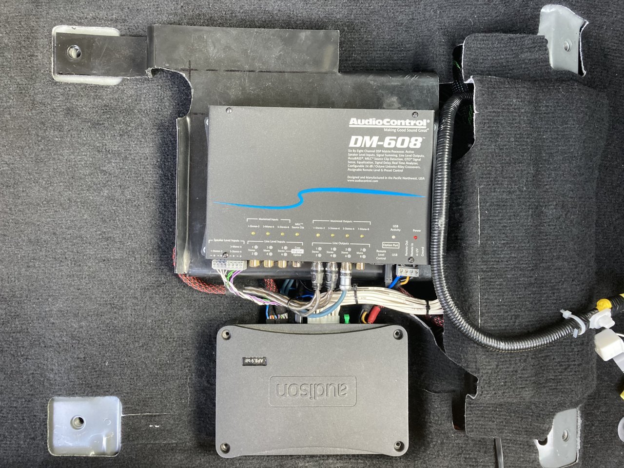

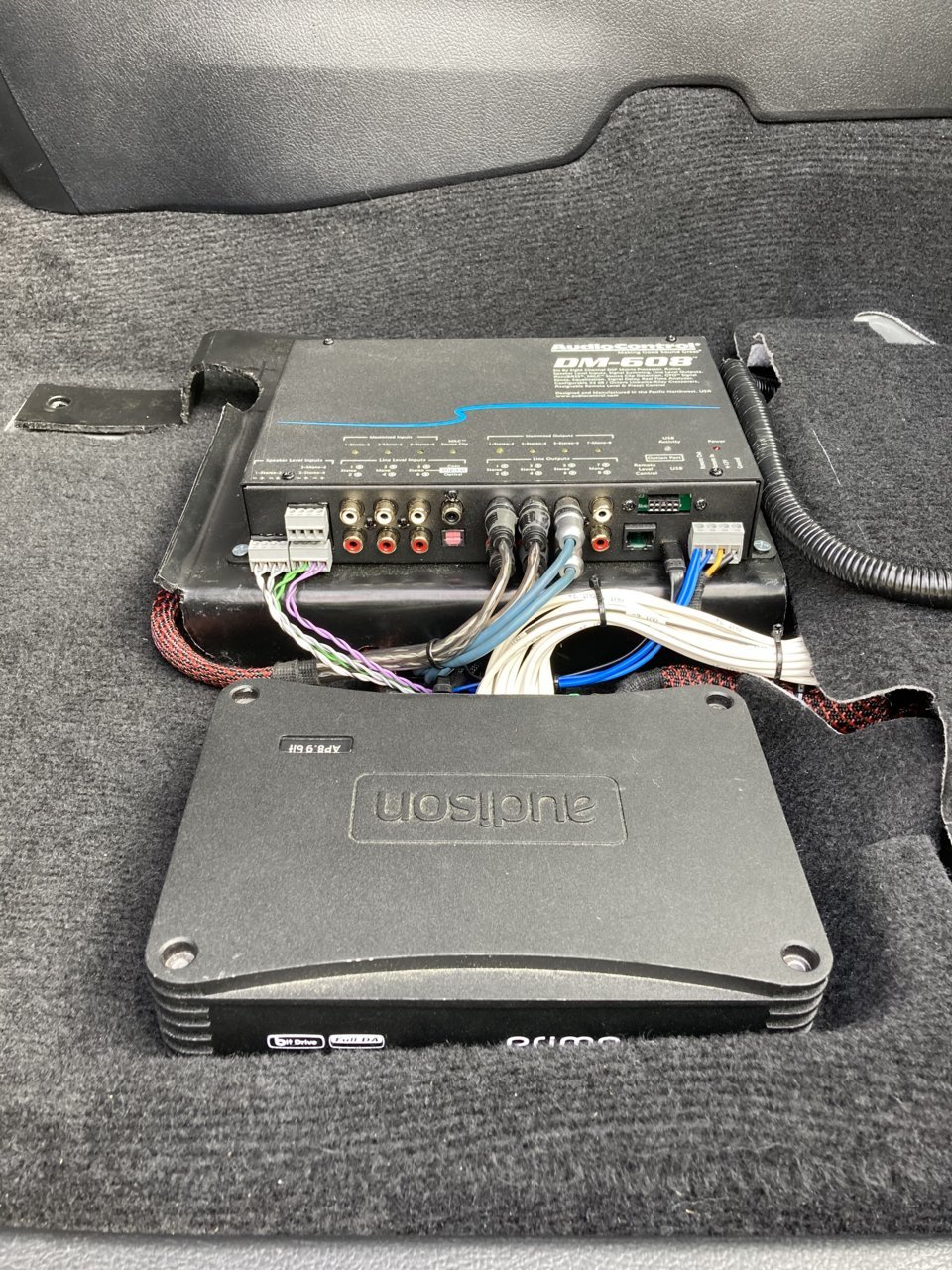

    I thought I had taken a picture of this installation but I can't find the stupid thing on my FONE so /shrug, maybe another time I'll have the front passenger seat out and I can take a picture then. I was pretty sure I took one while all the wires weren't crammed in there so it would look promising in terms of neatness and I planned to show it here so you all could be like damn that's gonna be NOYCE, and I could feel all kinds of glory and stuff. No glory.
    So, suffice it to say the 4Runner is using not one but TWO DSPs because that Audison BIT kept nagging at my brain with it's stupid input stage de-EQ opacity and I just NEEDED to see what the factory radio's output signal looks like, but also the parametric EQ is maddening to use (just let me type in my damn numbers shit! I hate rolling my finger on the mouse pad to try to get to a specific spot and constantly yo-yo past where I want to be, then give up because it's not going to happen), so I added a damn Audio Control between the stereo and the AP8.9BIT. Thinking behind this is, at some point you have spent so much money already so % wise what's another fucking $600...
    Anyway... getting them both to fit was tricky, the DM-608 has a larger footprint than the Audison 8 channel amp (?? wut ??) it's true, and having them mounted on a piece of plastic, and then getting that piece of plastic under the seat without worrying about any moving seat interference wasn't going to happen. I had to raise it off the floor so it doesn't interfere with the air vent that's there and I puzzled on it for probably two decades, AKA about 3 hours before realizing I only had to raise something directly above the vent, and the other device could sit on the floor, because there's more width available (between the seat struts was at least 2" less) and I ended up making a shelf for the DSP above the vent, and the amp sits basically under the seat rail on the door side. It all worked out great, wish I had that picture...
    So here's the result of poking around for a little bit, I took screens of the Input stage of the DM-608 so you could see what you are sending to your amplifier from the factory radio. It's very sad but good to know.
    Front L/R Factory Stereo output spectrum response.
    Rear L/R Factory Stereo output spectrum response.
    Initial thoughts on the Audio Control DSP primarily concern my utter surprise that the EQ is not independent channels, but L/R channel pairs unless I haven't figured something out yet. I mean for the money you should at least get all of the features of the JL which is $200 less as well as the input analyzer but so far as I can tell, nope. It also has its own GUI quirks that are annoying, but that's mostly about how it displays on your computer screen, forcing you to scroll up and down to see the entire page. The channel mapping isn't very intuitive, mostly because the labeling is confusing on the input/output pairing function. I do like the EQ, but I wish you could toggle between graphic and parametric depending on your preference.
    I don't have an actual tune in yet but for now it's all up and running and sounds fine. I'm looking forward to screwing with the ACCUBASS. I moved the sub amp signal from the Audison to the DM-608, and already there's a noticeable difference in terms of low volume presence.

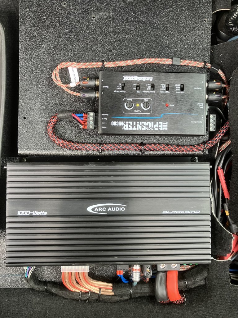

    So now this system is pretty finished. I remade the plastic mount for everything under the front passenger seat. My original one was not adequate after all of the changes. I mounted the DSPs all there and moved the amplifiers to the rear.
    Final piece ended up being the Epicenter Micro. GET AN EPICENTER!
    It’s been hot, I’ve been sick. It’s been pretty hard to get the motivation to bust out the rig and EQ this system so right now I’m running with levels and crossovers and no EQ. It’s been weeks and I’m thinking this is actually really good already.
    Bottome line, here’s the stuff installed. This is a fairly powerful setup. The sound quality is excellent. The subwoofer just really kills.

    TOSLINK digital optical out of the FiX into the TwK. Analog 2 channel out of the FiX into the Epicenter. Epicenter output into TwK. TwK 8 channels out to the three amplifiers.
    I didn’t know until I tried it, but you can concurrently use the digital output and two channel analog output of the JL FiX, which was really nice because that gave me the full range signal for the Epicenter loop while keeping everything else in the digital path. Just as convenient, the TwK enables you to use two analog inputs on channels 7/8 concurrently with the L/R digital optical input so I was able to still loop sub through the DSP. I thought I was going to have to run subwoofer around the TwK directly to the sub amp and use the crossover there, but nope, full DSP functionality on all channels. Two thumbs up to JL.
