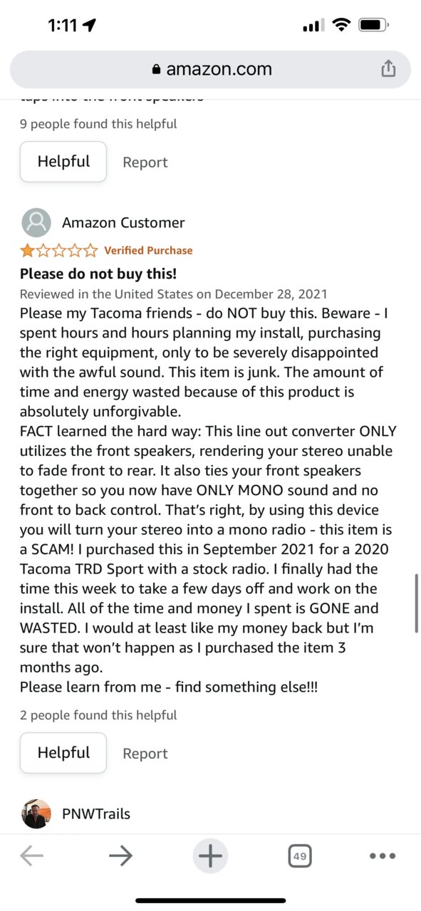

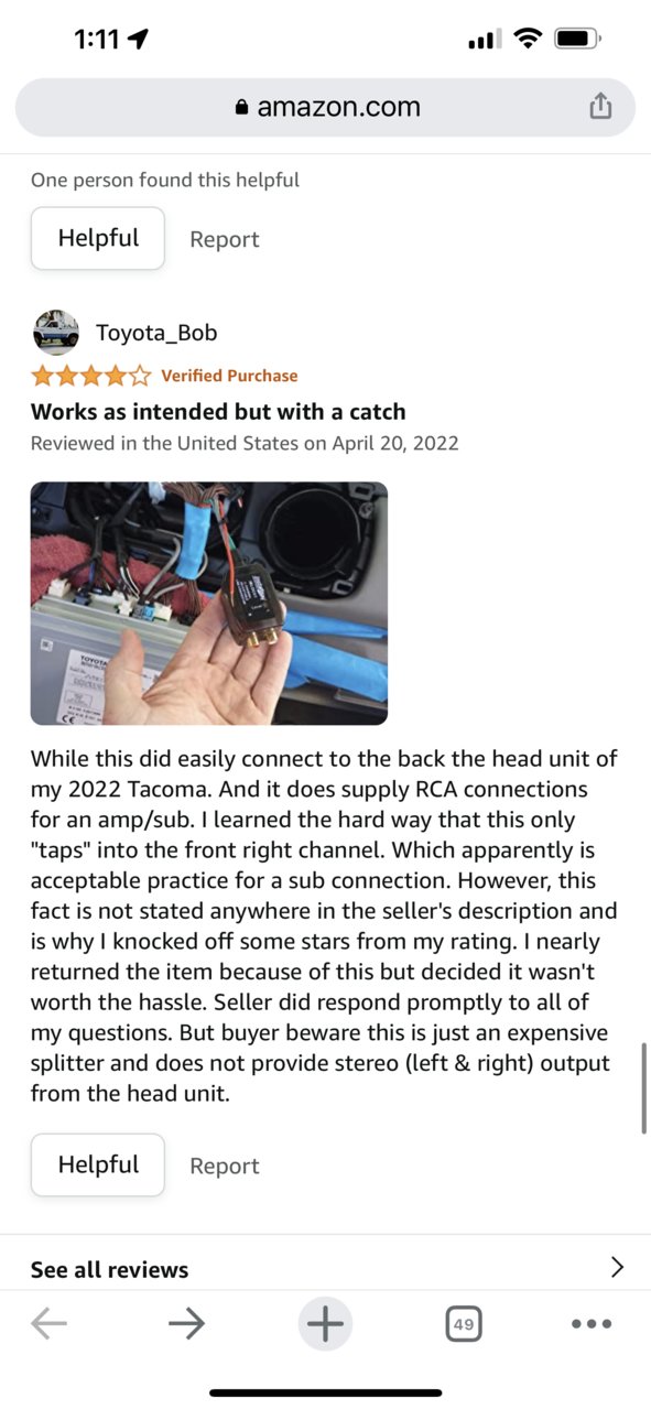

    I don’t understand why this one says it’s for a subwoofer… I bought the red wolf harness which is a lot cheaper which says it’s for speakers to add amp.

    Any credence to these reviews?

    I bought one similar off eBay I wouldn't use it as it looks a little sus. What ended up doing was using it to make a t harness. Maybe a Line output converter from a reputable company (Kicker audio control).
