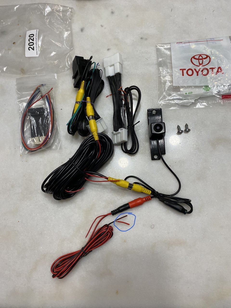

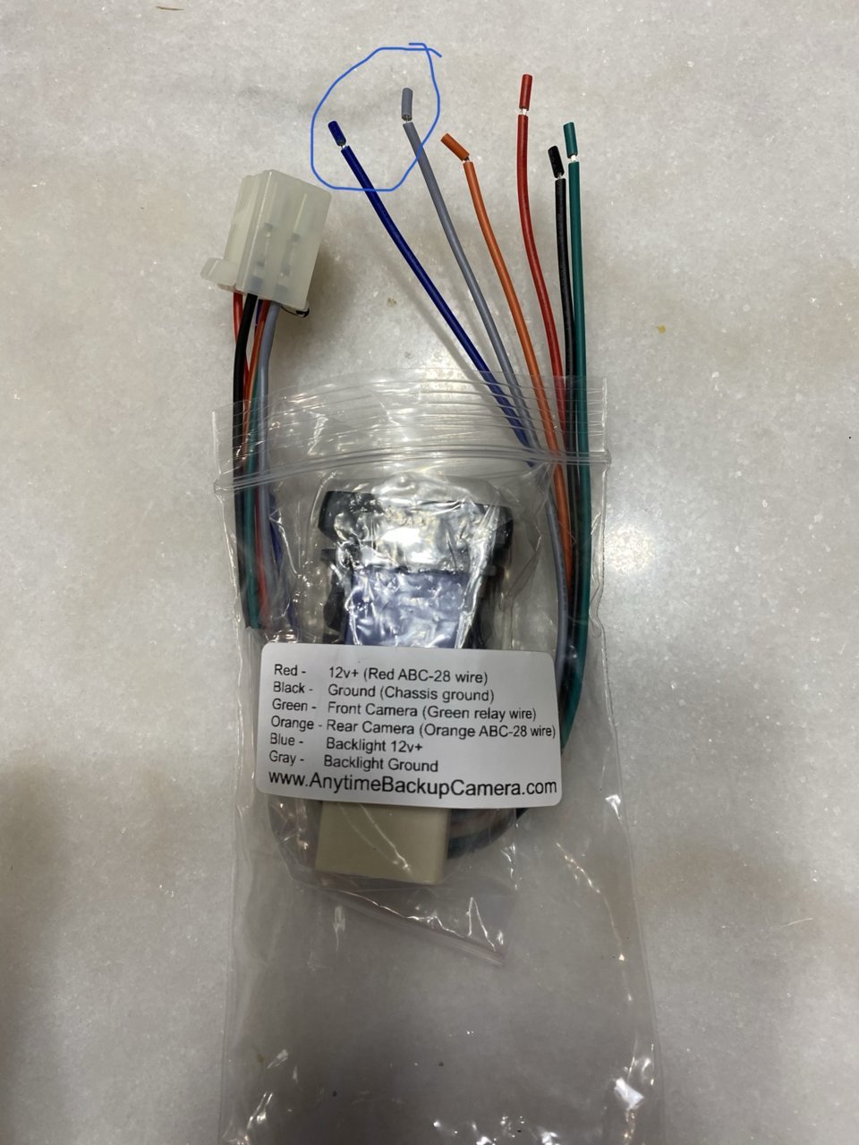

    3017C634-17B8-4C5B-8DFD-F39D6D7C5EE1.jpg E32D87CB-CF2A-48D3-A8B7-1057C11C1F1A.jpg
    Been busy with work but I’ll install it this Tuesday. I want to install it as close to factory looks as possible so here is my set up with anytime camera kit. Can you tell me where to connect the red and black wires to coming out of the red RCA and the gray and blue wires to illuminate the switch?

    The red is soldered/crimped to the red on the long RCA harness. The black goes to any ground point on the truck. Mine goes to a ground located on the inner fender by the fuse panel under the hood. If you look under the hood you'll see a 6mm bolt (I think) that attaches a ground wire to the inner fender. I just unbolted it and added the camera ground using a ground ring I soldered to the wire.
    The red on the cab side can be spliced to the green coming out of the relay. It will turn the camera on when the relay is activated.
    The Blue/Grey on the switch will connect to the Blue/Grey on the radio harness. These are for the switch backlight.
    Hope that makes sense...

    I thought about red on red at the camera's RCA end or Add a fuse option. I'll just crimp the red wires. Do you think it is a good idea to cut the long RCA harness and solder it together? I'd hate to zip tie a bundle of excess wire harness anywhere within the engine bay. Thanks for the help!

    You can cut and solder the ends including the power wire. If you search the interwebs, you'll find several companies that make a nice soldered RCA end. I have made my own. Depending on your soldering skillz, a safer option might be to pull the excess into the cab and zip tie there.
