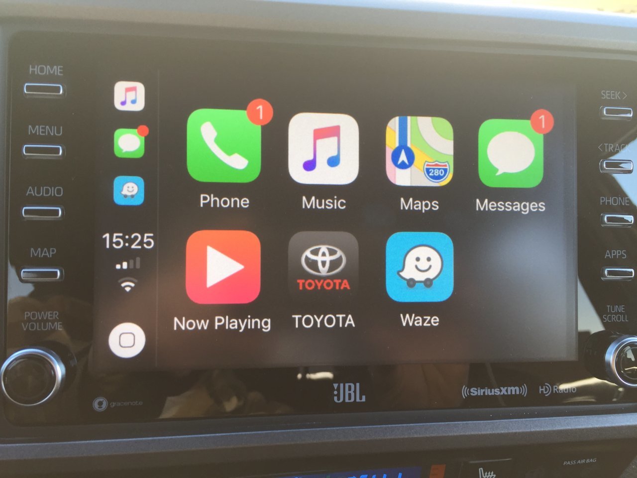

    I had CarPlay in my BMW M240i and that was one of the things I refused to give up. I use Waze and listen to podcasts daily, both of which are integrated into the CarPlay software. It was one reason (among others) I waited for the 2020s.
