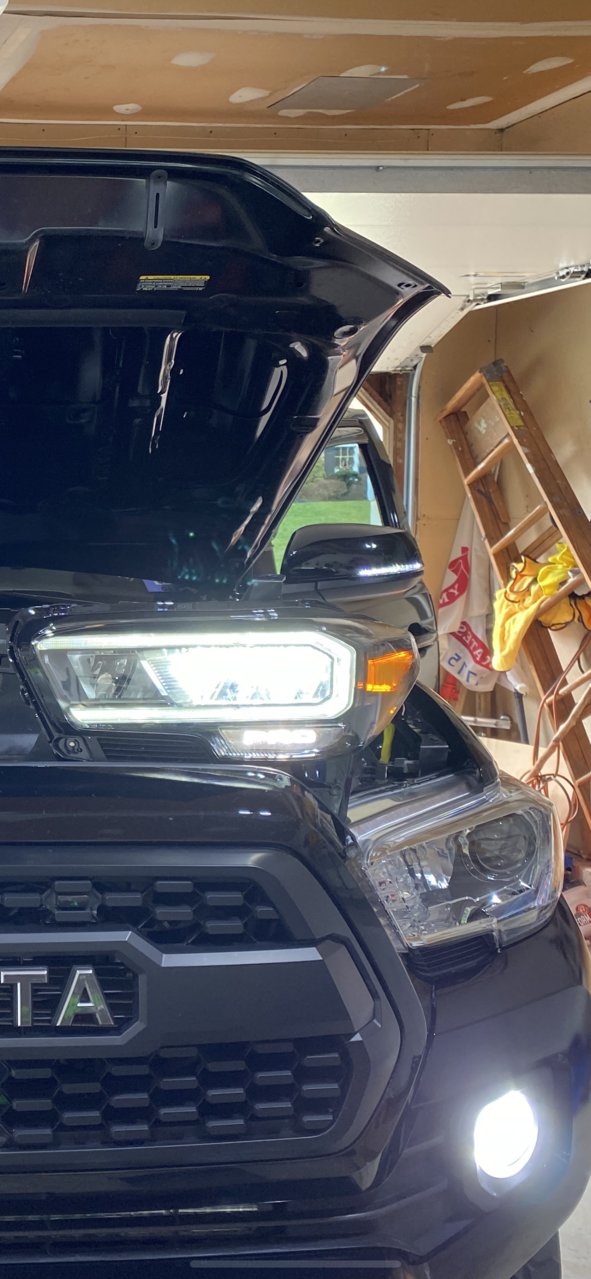

    It’s been a month since the install and everything is perfect not one single issue or complaint. I can definitely see a lot better with these. The halogen’s where ok but these LED’s are awesome. They provide just enough uplight to read street signs and I am amazed by the width of what is illuminated in your field of view.

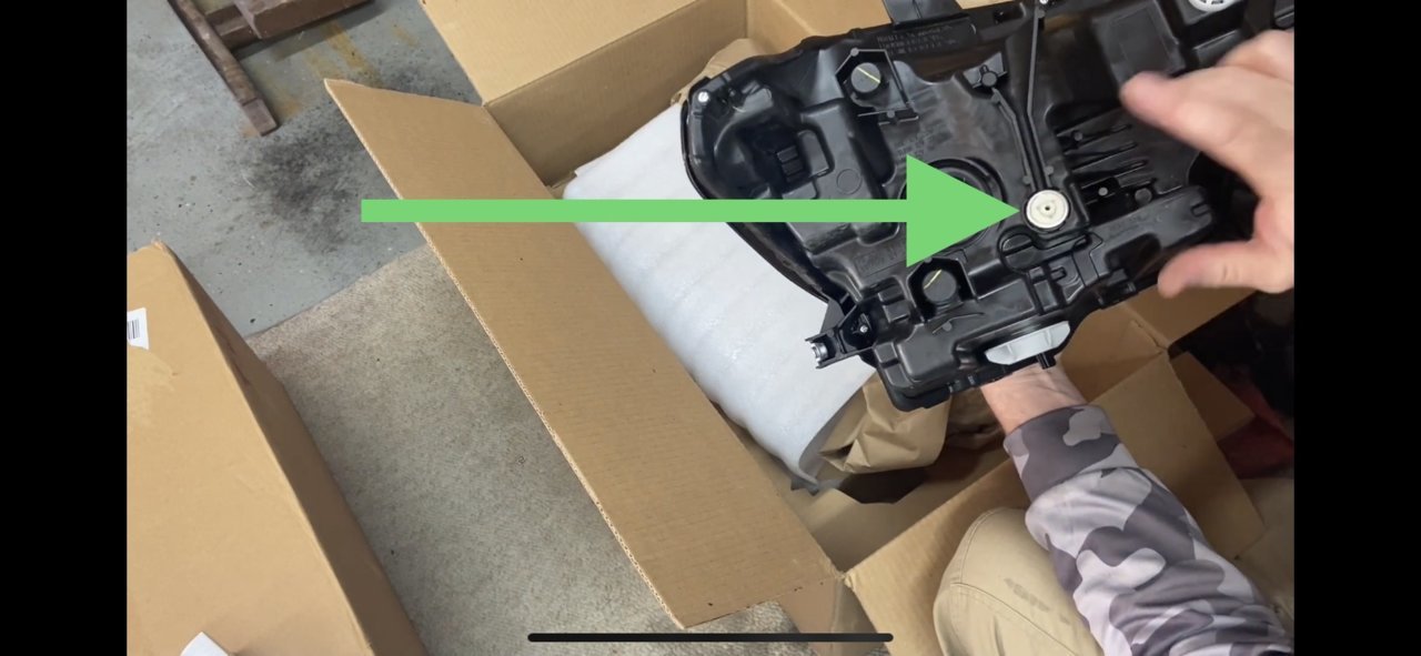

    Where is the beam adjuster ..?
    19cement4xor[OP] likes this.

    Back of the headlight run a Phillips screwdriver down the slot and turn CE8DB536-8BB0-4F97-B8E5-04BA474FA55F.jpg
