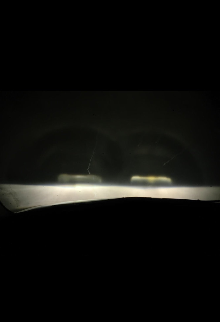

    If you look at @crashnburn80 testings, no drop in LED bulb will come close in performance to the OEM LED headlights. Hikari Ultras are the best option if that is your only route.
    That little bit of light up there is the factory designed uplight. Even the stock halogen projectors have them. They are meant to illuminate Street signs, since they since above the cut off of most headlights.

    Ye, the low beams are not as wide up close. There also seems to be three hotspots, not sure how to explain it.
    Not as clean as the cutoff from my HIDs, but i like them better than the Halogen projector headlights.

    With the two HID retrofits I’ve done, neither set of projectors had that “feature”. Street signs and the like were illuminated as good as ever. That’s even with my lights aimed lower than normal.
    Not sure if that feature is necessary.

    HID projectors usually do not have uplight. I think HIDs with uplight would be far too blinding.
    The uplight is necessary for less intense lighting, like halogens or these LED headlights.
