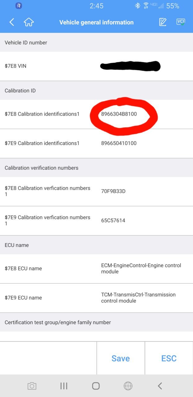

    Can't say which OBDii readers have that info for sure but most likely any more modern one should have your ECU ids. Drop by Autozone or Advance and see if they'll let you scan your truck. Take note of the Calibration Ids (example of mine attached). The tsb PDF shows the previous/current calibration ids after applying the update.

    What app is that? It doesn't look like Carista or OBD Fusion. Those are the only two that I know of that show the ECU ID and both require a purchase to do it.
    Thanks!

    Autel (or better known as no-tell) AP200. It can read generic OBDII even if you don't have a vehicle unlocked which gives you even more pids.

    Unfortunately not (at least not for Hyundai); I don't remember seeing that as a recent update or original coverage so you'd still need TS or Carista. It does however support all the different modules on the network and show associated PIDs. Supports some of the special functions like key learning, abs bleed, steering wheel angle calibration (probably more) but you cannot do more advanced things like reset adaptive, change customizations... etc. It's a handy little dongle and you can use your phone or tablet to view data. Update rate isn't bad but its definitely not as fast as TS or higher end scantools.
