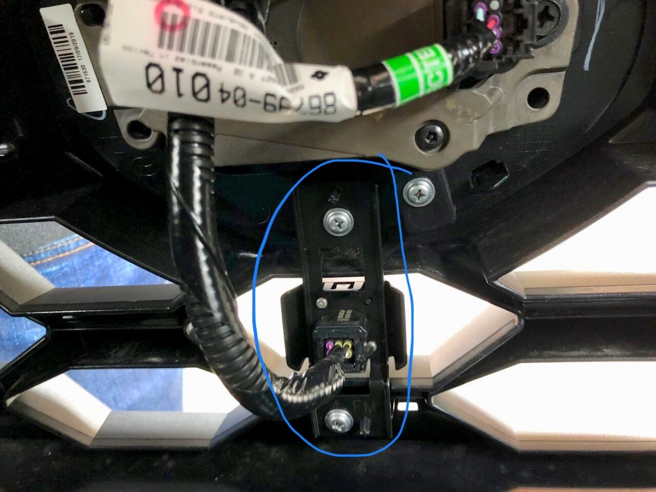

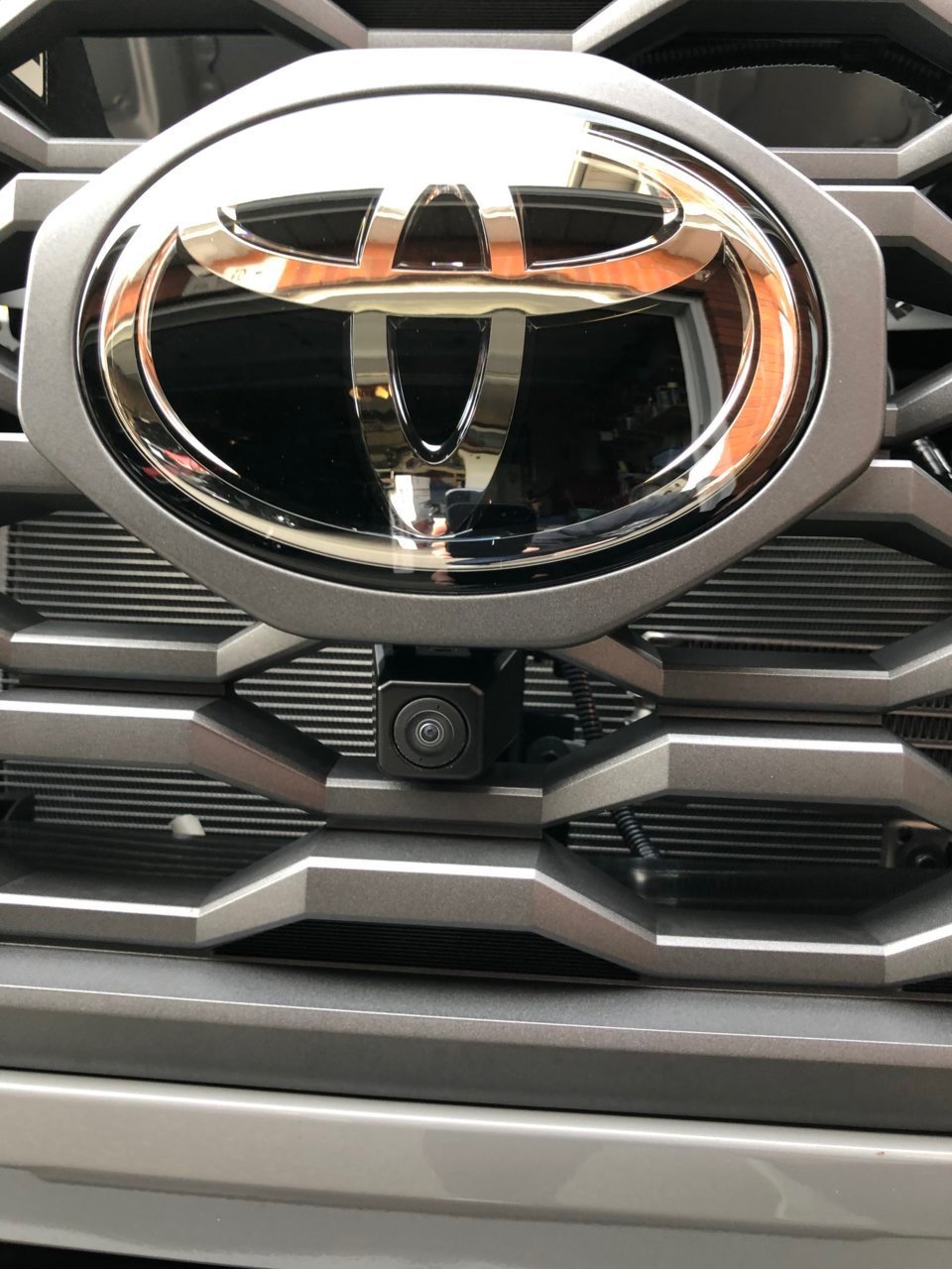

    6D7BCD66-5D62-4C89-90A1-06B172C2829F.jpg 2CE3AE21-1F8C-4F15-85DC-29C30FFCF9C6.jpg Hi Jeff,
    Saw these perfect pictures taken by another TW member. I have the same front grill and am looking for the camera mounting bracket highlighted above. Do you have the part number for it and happen to know where I can order one? Thank you in advance!
