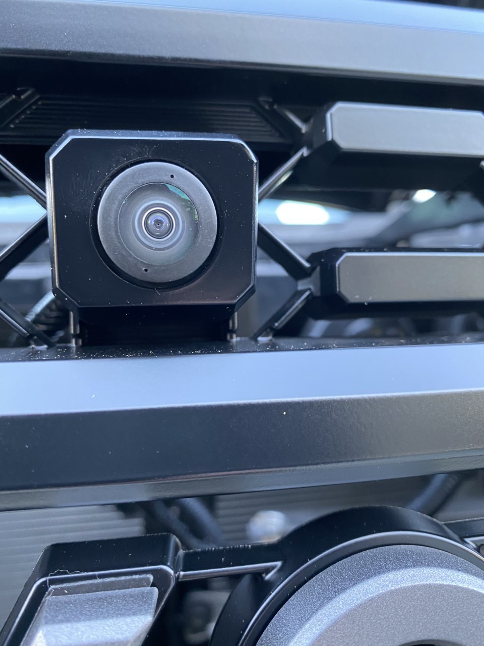

    [​IMG] I might be the first- I converted my 2020 Off road Grille to a 2020 Grille. Was able to get factory TRD grille insert and Garnish for under $300, the process is straight forward until you get to the camera. The only thing that did not plug and play was the camera bracket, we had to modify the bracket to get it to work. Not a 100% bullet proof mount but it will work. Tested the camera and it all seems to be the same to me. Sorry no pic but in my 51 yrs of life I have never understood how to up load my Mac.

    Pretty much as expected. Would be nice to see pics, but I’m sure more people will experiment with it.

    I’m glad to hear that you got everything to work. Hopefully someone will develop a aftermarket bracket soon to make this a clean swap. I would love to see/hear more details about how you got the camera/MTM set up.
    If anyone with a 2020 Pro would be willing to post pictures of their camera/bracket it would be greatly appreciated.

    I don’t see any way the camera picture can still be the same if mounted several inches higher, and especially if re-using the OEM Off Road bracket which puts the camera at a different angle than the OEM PRO mount does. But I’m not sure it matters. As long as you are happy with how the camera functions in the new position then that’s all that matters. I’d be interested in a photo of how the camera picture now looks. If it lines up with where the front bumper is in the OEM screen, etc.

    The new grille comes with the camera housing, I cut the bracket in half and turned it upside down then put some foam tape around the camera then screwed it to the grille with the bottom part of the bracket I cut. The camera housing is molded at the angle the camera needs to be. I would love to post pics if someone can tell me how!
