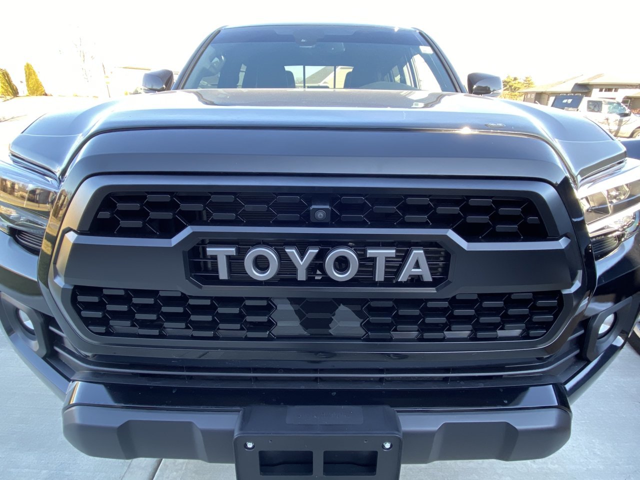

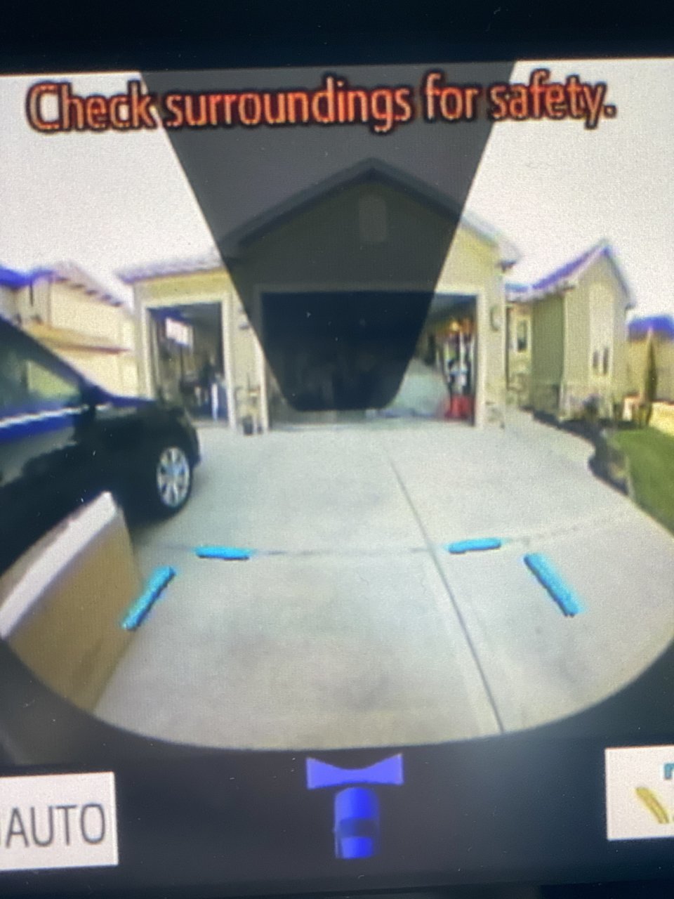

    At the end of the day if my camera angle is off I am ok with that as there is a 2% chance that I will ever be off roaring where this will matter. Maybe once my lease is up I will off road where I need the camera but for now it works for me!

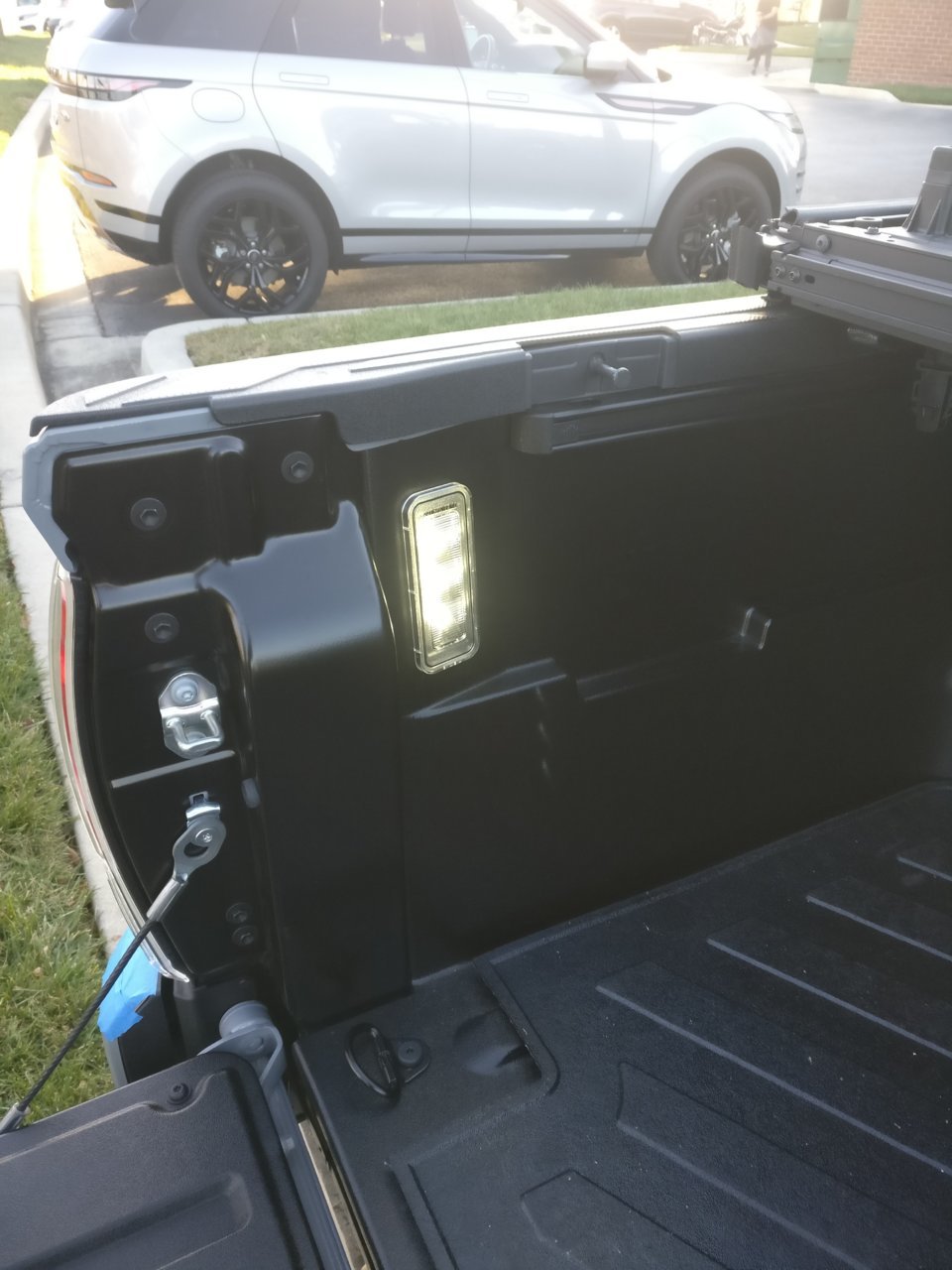

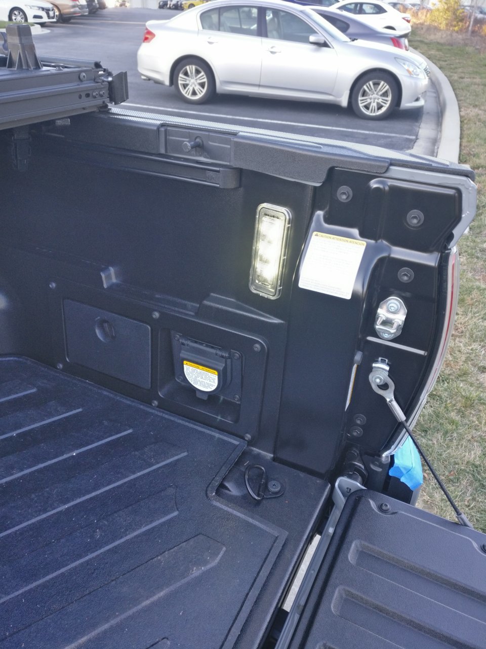

    I received my Bed lights today. It took about 15 minutes to install. Everything works perfectly. You just connect them to the empty plug behind the tail lights and you're good to go.

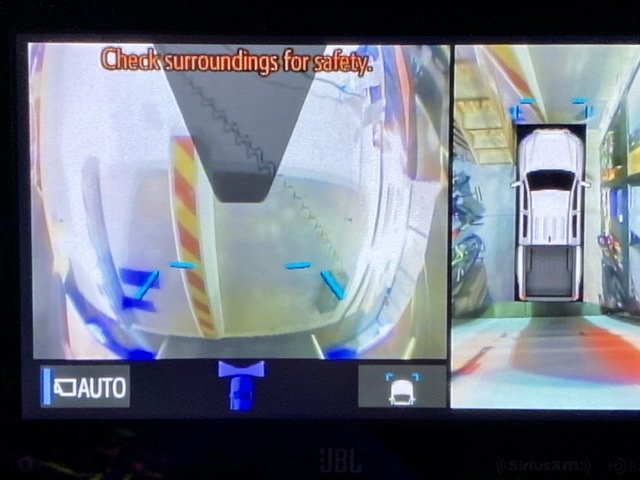

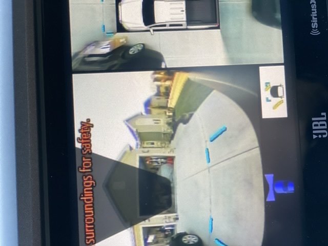

    Awesome. Thanks for posting. I can tell right away that’s a different perspective from mine because I can always see the front license plate frame/front bumper at the bottom of my front cam. I use that to get my truck very close to the wall in my small-ish garage. I can post a photo later to show the difference in perspective. But like I said earlier, as long as the cam works I think that’s the main thing and it looks fine to me in your photo.
    I’m curious how the view is from an OEM PRO front cam. Is the grill itself visible at the bottom of the screen like that on OEM?

    I just checked mine and the grill is visible on the OEM Sport as well (never noticed that before!). Now I’m curious if the front bumper is visible from an OEM Pro camera. If so, then perhaps your camera is just pointing a bit high which is maybe why the bumper isn’t visible? I was thinking the camera perspective could be fixed by just pointing it down a bit, but that would bring more of the grille into view. Hmm...would probably need to move it forward as well. But hell, maybe that’s how the OEM PRO front perspective looks and the bumper just isn’t visible? Now we need someone to post a shot of that. :)

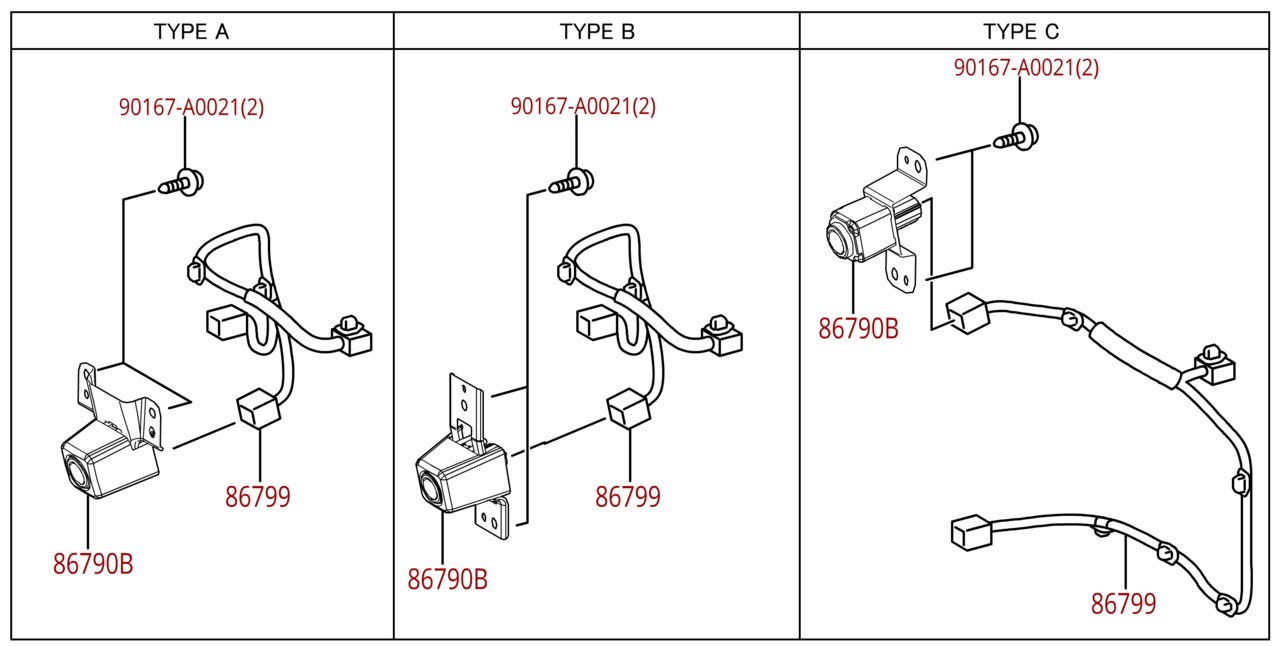

    For reference.
    Camera:
    867B0-04010 - Type A: Limited
    867B0-04020 - Type B: TRD Sport / TRD Off-Road
    867B0-04030 - Type C: TRD Pro
    Wiring:
    86799-04010 - Type A and Type B: Limited / TRD Sport / TRD Off-Road
    86799-04020 - Type C: TRD Pro

    Roadkill...couple of questions...
    What turns these lights on? Do they come on with the parking lights...cargo light...other?
    What year is your truck? I’m wondering if all 3rd gens have the empty tail light plug you’re referring to.
    Did you have to cut the bed material?
    thanks!

    I'm not Roadkill, but I can answer these questions.
    1. These lights are connected to the cargo light. (Switch is on the dash).
    2. His truck is a 2020 TRD Sport. Only 2020's have the connector.
    3. No cutting is required on 2020's to install the lights.

    The 2020+ have pre-cut holes for the new style bed light kit. My sport had caps over those holes, which you pop out to install this kit.
