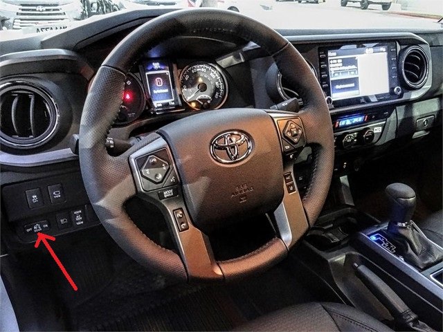

    Where does the switch go? The bed light instructions include installation of the relay, but references repair manual for the switch (84267-0C020).

  20. Dec 15, 2019 at 9:15 AM
    #380
    DeusExMachina
    DeusExMachina Well-Known Member
    Oct 1, 2019
    #306810
    273
    Denver, CO
    2020 Tacoma 4x4 Sport 6MT access cab
    That's what I thought! If I don't have that switch, is there likely a harness behind there? I have a 2020 AC.
