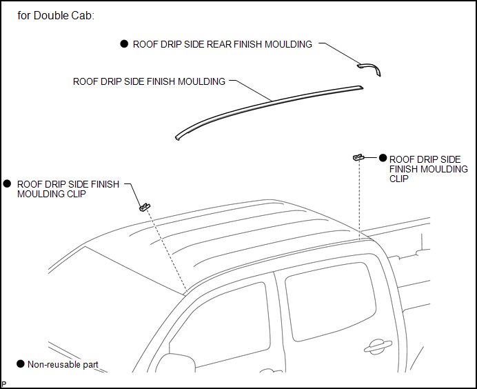

    The factory mouldings are removed and discarded when the roof rack is installed. That said, what the arrows are pointing to in the photo retail for about $20 each.
    75553-04020 - Moulding, Rear Roof RH
    75554-04020 - Moulding, Rear Roof LH
    75561-02020 - Clip, Roof Moulding (Qty: 2)
    Jeff

    I just ran to the dealership by my house, they gave me:
    75551-04081 - Right Hand - MOULDING, ROOF DRIP
    75552-04081 - Left Hand - MOULDING, ROOF DRIP
    Looks like the parts you listed are just the rear clip (which is fair because thats what I pointed to in my photo). I am looking for the full rubber strip, front to back, which uses double stick tape to adhere to the roof channel where the OEM rack bars sit.

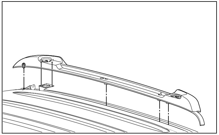

    The mouldings are 2 pieces, a long section that runs almost the length of the roof starting at the windshield, and a much shorter rear section. The part numbers you provided are the long section. The rear section that the arrows are pointing to, is what I priced in my last post.
    That said, I began to doubt my second post and have updated it. I am now going back to what I said in my original post, because when the roof rack is installed the entire drip rail mouldings (front and rear sections) are removed and discarded and the roof rack rail itself covers the entire area. That moulding section of the roof rack is not sold separately, and you must buy the roof rack rail or the entire roof rack to replace it.
    PT278-35170-RH - Rail, Roof Rack RH
    PT278-35170-LH - Rail, Roof Rack LH
    PT278-35170 - Rack, Roof (Complete)
    If you really want the entire drip rail moulding part number information (or for others looking), here it is, for a double cab:
    75551-04081 - Moulding, Roof Drip, Front RH
    75552-04081 - Moulding, Roof Drip, Front LH
    75553-04020 - Moulding, Roof Drip, Rear RH
    75554-04020 - Moulding, Roof Drip, Rear LH
    75561-02020 - Clip, Roof Moulding (Qty: 4)
    The front of the moulding is held with a clip only, then there is double sided tape about half way down the roof. The rear moulding has a clip near the front of it and double sided tape near the rear.
    But again, if you are able to take a picture showing the issue, there's a chance something else may be up with it.
    Jeff

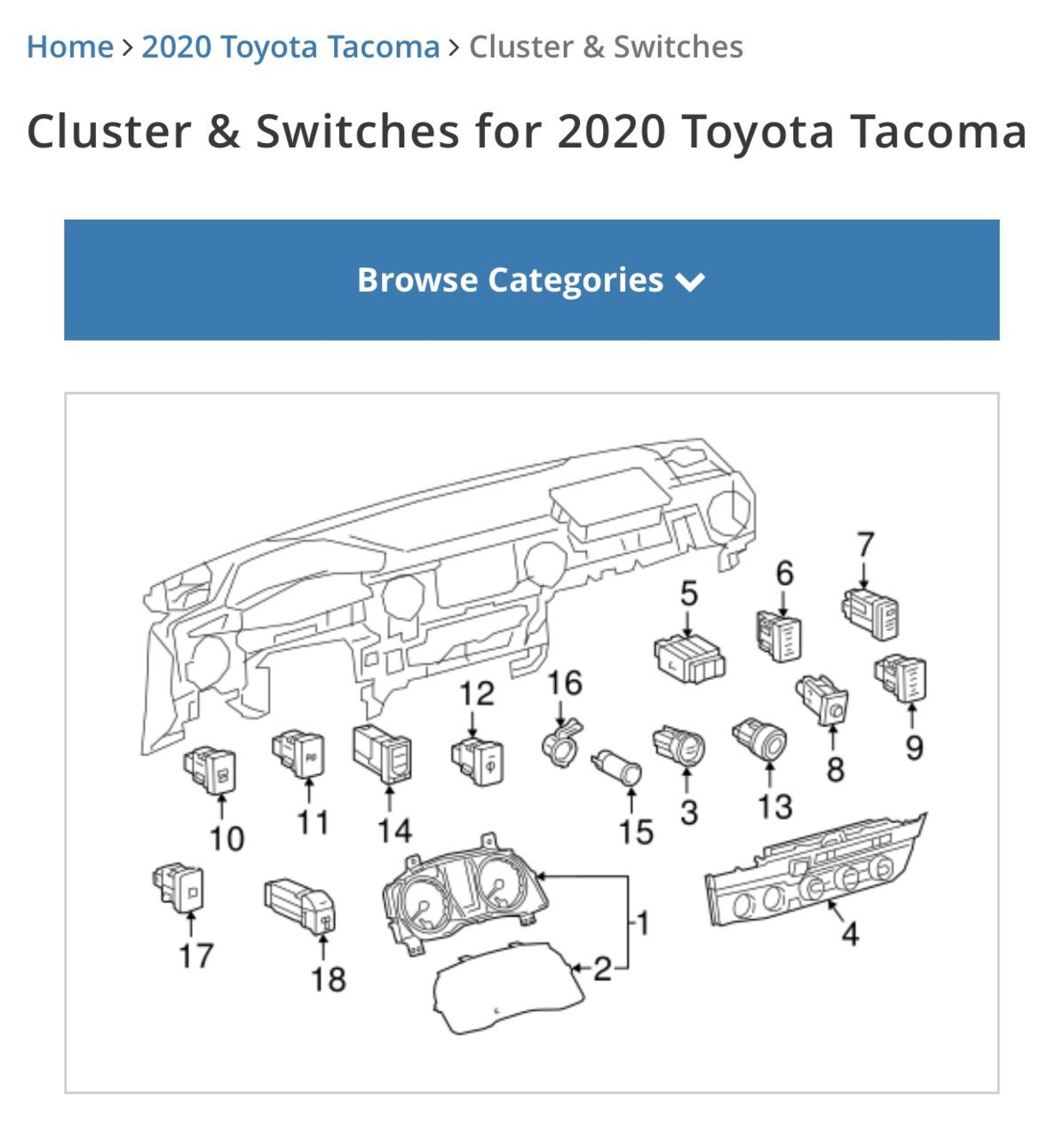

    Does anyone have the part number for the Mtm/pano switch? Can’t seem to find it.

    TacoBuffet
    TacoBuffet Well-Known Member
    Jun 9, 2018
    #255903
    9,271
    AL
    Taco #13, 2022 OR DCSB Cemint
    5100s, TE37s, Toyo RTs, Tint, Bedmat, LEDs
    Gonna need more than that, there is also cameras in on the underside of the mirrors.

    I found the post where Jeff listed off the required part numbers, including the side mirror cameras you're talking about, but can’t find any info on the switch. Do they just not sell it yet?

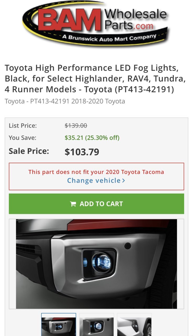

    BAM has them for $104, that’s where I got mine.

    84721-08010 - Switch, Wide View Camera
    Toyota Canada MSRP is $455.00 for PT413-42191.
    Jeff

    @Jeff Lange do you know if this part number works for every trim? I know the sport doesn’t come with the multi terrain monitor so just wanted to verify.
