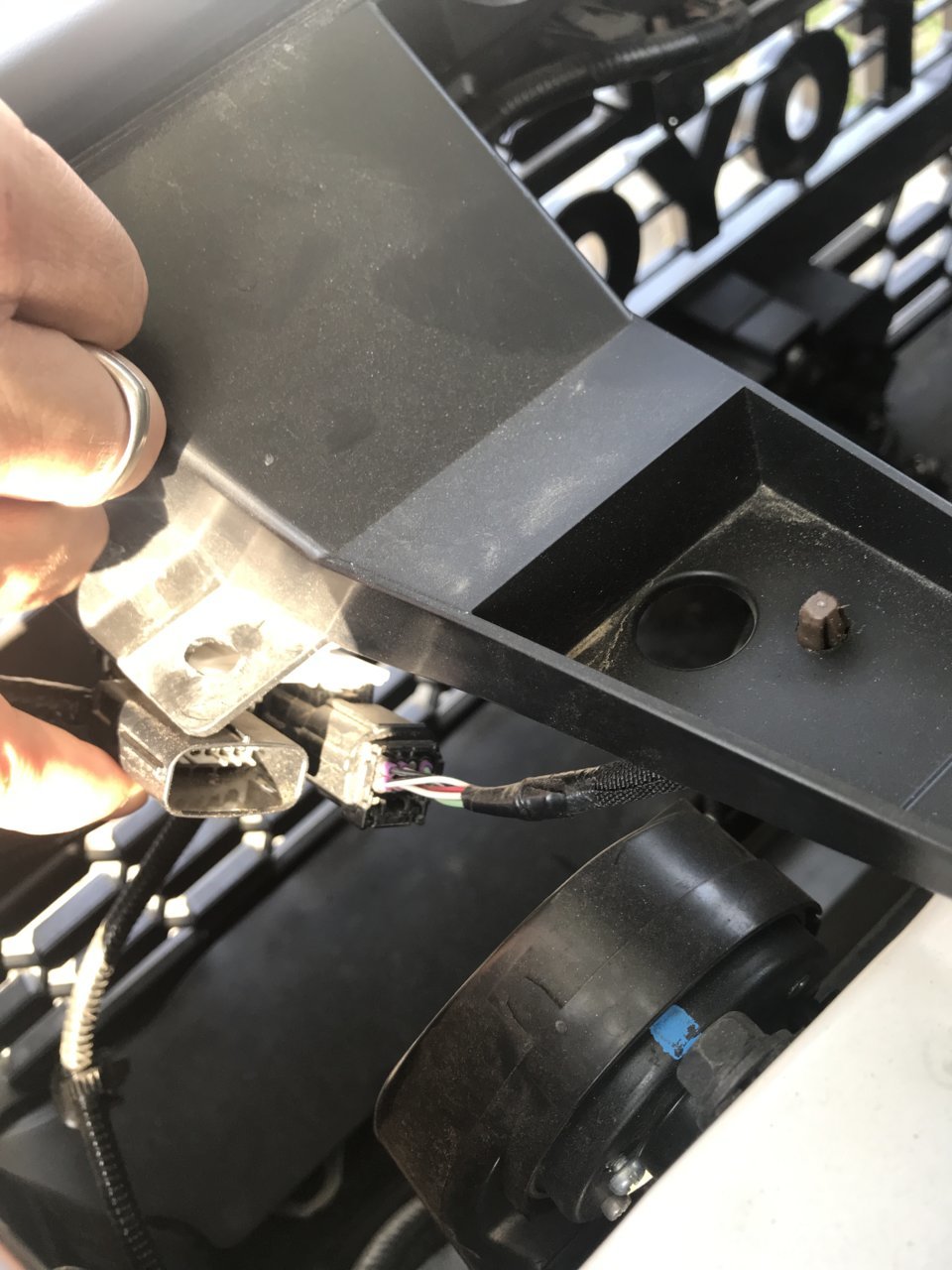

    @Jeff Lange you are a real asset to us all, thank you! Hoping you can help with this. Here is a pic of a 2020 TRD Pro grille and two harness ends. The one that is connected is 88214-04020, from the radar sensor. And cable 86799-04020 goes from the camera to the empty oval connector. But what is empty is the cable that connects to the oval connector that would then carry camera signal from here to the head unit. As you can see I'm missing the cable that would go from here to the HU. Would you happen to have a p/n for that? Thank you.IMG_9670.jpg

    The wiring from that connector to the head unit is part of the body harnesses.
    The connector that plugs into that is 90980-12326 and the terminals for it are 82998-74030 (Qty: 13).
    For a 2020 TRD OR, the engine bay harness that would come with the connector on it is 82111-04K90 for vehicles with halogen headlights and 82111-04L00 for vehicles with LED headlights.
