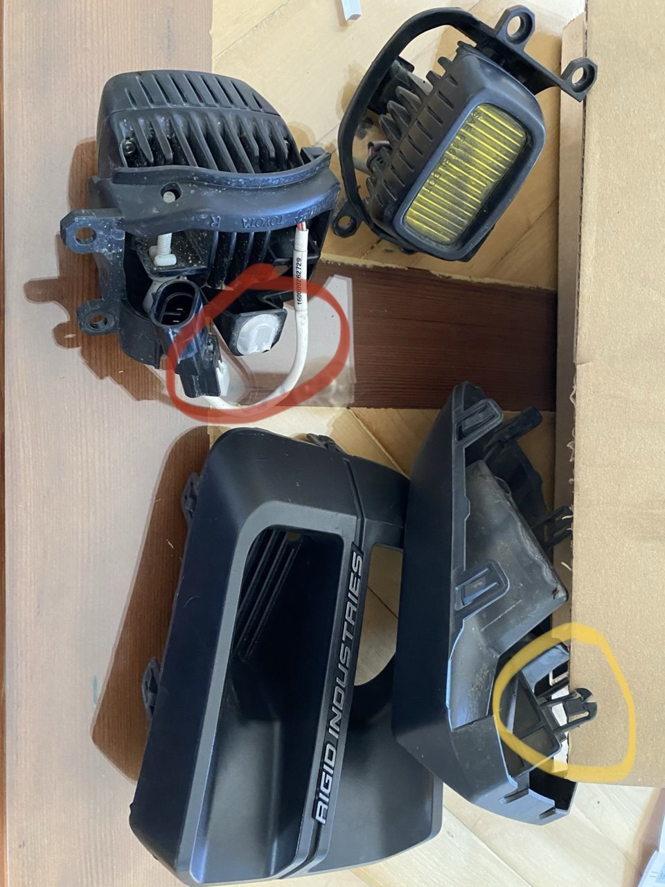

    @Jeff Lange do you happen to know the part number for the clip on the ridgid foglights? The one circled in red. I lost one of the clips when I was fiddling with the wires.
    Also, is it possible to retrofit the 2021's power seat into prior year models?

    It's pretty hard to tell, and not something listed separately I don't think, but I'm pretty sure 82711-1E360 should work.
    17801-0P100 - Filter, Air
    Jeff

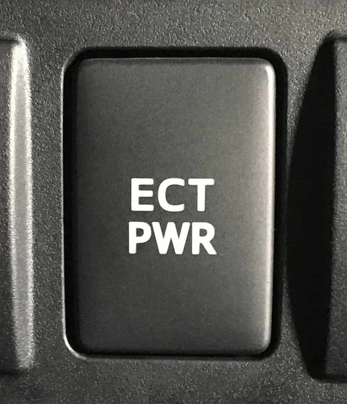

    Jeff Lange
    Jeff, can you find out what the part number is for the ECT PWR switch? thanks!
  17. Apr 9, 2021 at 11:08 PM
    #877
    Jeff Lange
    Jeff Lange Well-Known Member
    May 19, 2015
    #155616
    2,267
    Calgary, Canada
    '86 AE86, '05 NCP13, '11 GSE21
    84721-04010
    markram[QUOTED] likes this.
