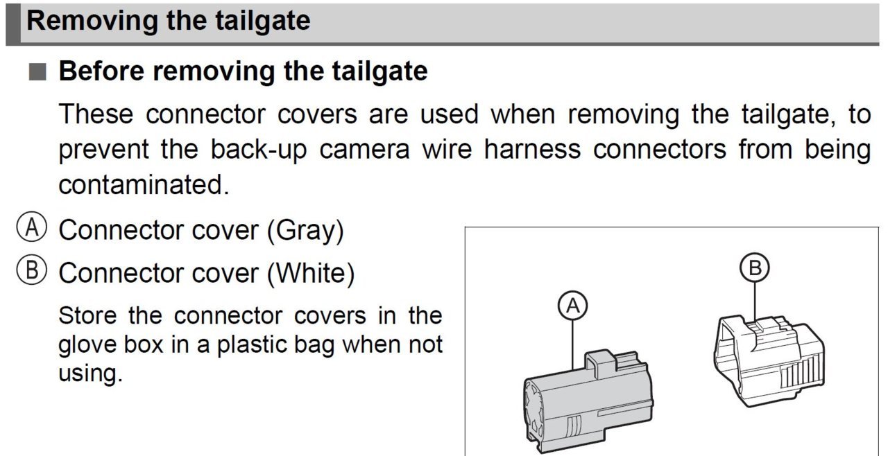

    Do the attached picture of the plugs/covers for the tailgate camera harness have a number or do you or anyone else know how one would go about getting a set?
    Apparently, I either lost them or did not get them with my new truck and discovered it today when removing my tailgate to install the auto lock tailgate mod.
    If anyone has them and if they could look and see if they have numbers on them and post them if so, I would appreciate it. Thank you !

    I have some knockoffs of these if you want caps to seal. They are the same as the license plate intercept. See the DIR DIY thread for the part numbers.

    Thank you, and excuse my ignorance, but those look like for the backup lights and have 4 connections on the inside, the backup camera has 8... but then again I have a hard time understanding Caribe Makaira's posts because I am but a simpleton.

    Thank you Sir! those look like it, and looking at the pictures I am sure I did not get those with my truck...Hmmm.

    The FleaBay is correct. They come in a bag with instructions telling you how to simply do what should be obvious. Mine were in the right-rear well, with my jack kit. I have heard others say it was in glove box. Either way, pretty straight forward. I’m happy to pull mine and look them over if needed.

    aaand part number: 82824-0C070

    That part is clearly it. One thing, when I search on toyota parts.com, it tells me it is only through 2019 for some Tacomas. However, it is $8.00 and I am pretty sure the camera has not changed between 2017 - 2021 so the connectors should be the same... I am gonna get one and I will update the results.

    When I look up the same thing for 2021, I get 82824-04050 I’m not sure if there is a physical difference, but there you go.

    82824-0C070 is for 2009-2019
    82824-04050 is for 2020-2021

    No, the camera is the same, the connector between the body harness and tailgate harness changed though.
