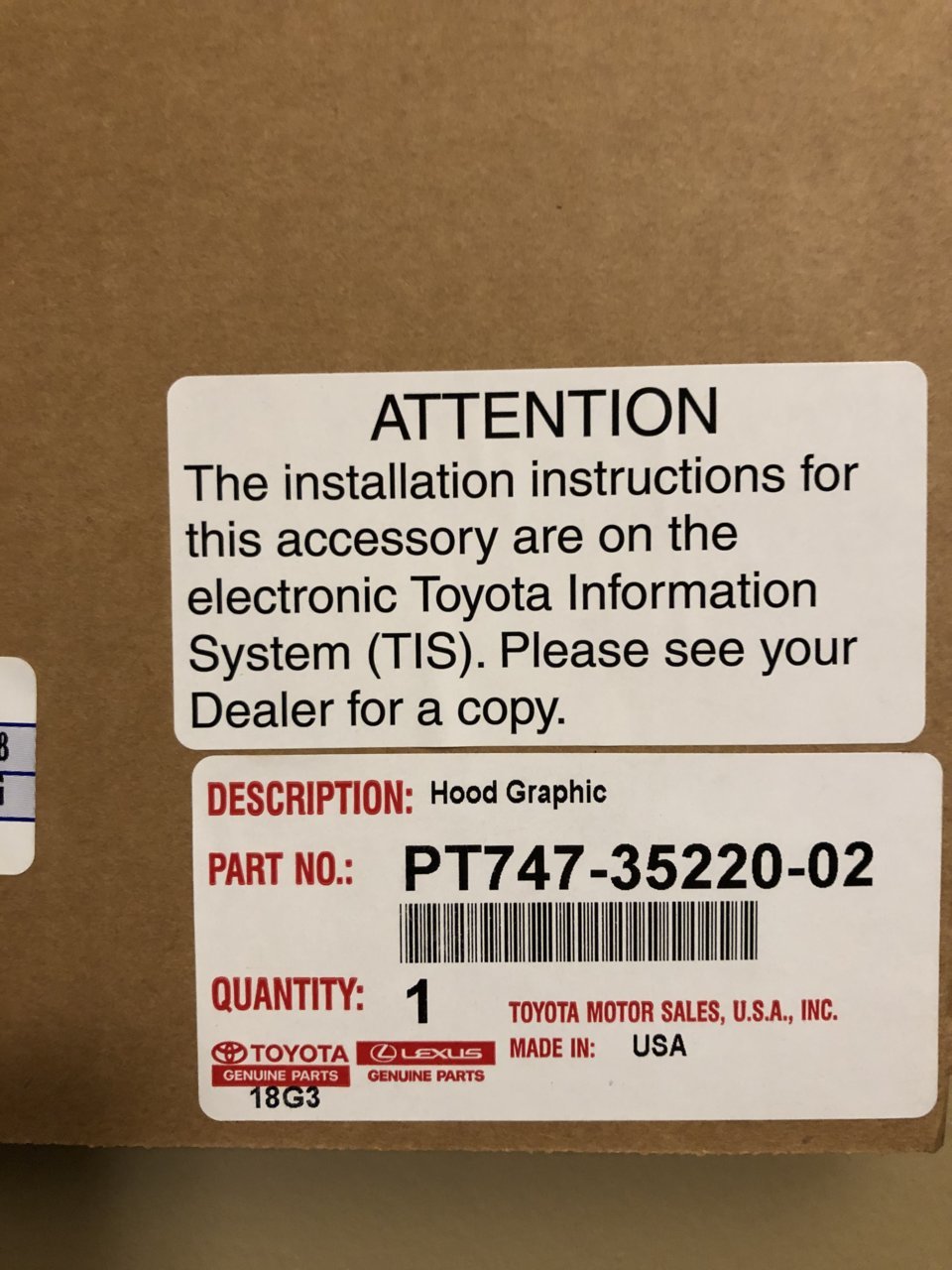

    would any kind soul with a TIS subscription be able to provide the installation instructions for this?
    Hood Graphic PT747-35220-02

    See attached, I think this should provide the information you need.

    Thank you Jeff! That will work.

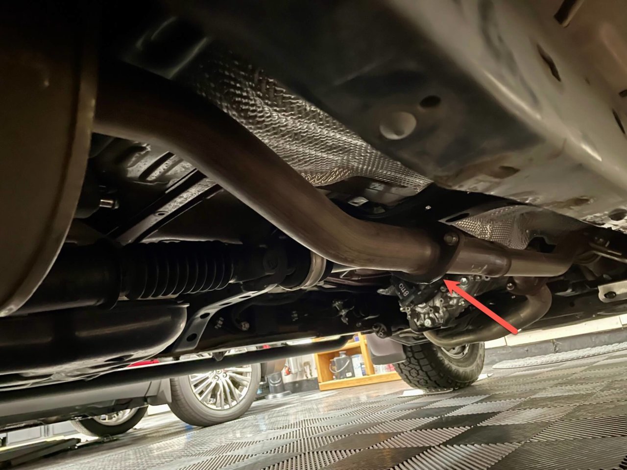

    I replaced a TRD exhaust/muffler with a stock exhaust/muffler (don't ask ;) ) and I'm looking to replace the exhaust gasket that is at the connection after the cat back pipe and just ahead of the muffler. I found two posts but each one suggests a different PN.
    https://www.tacomaworld.com/threads/2020-parts-list.619005/page-49#post-26329719 (suggests PN 90080-43033)
    https://www.tacomaworld.com/threads/2020-parts-list.619005/page-49#post-26394228 (suggests PN 90917-A6001)
    Can anyone kindly confirm which it is?

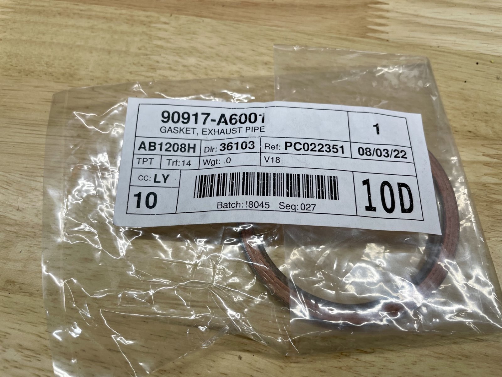

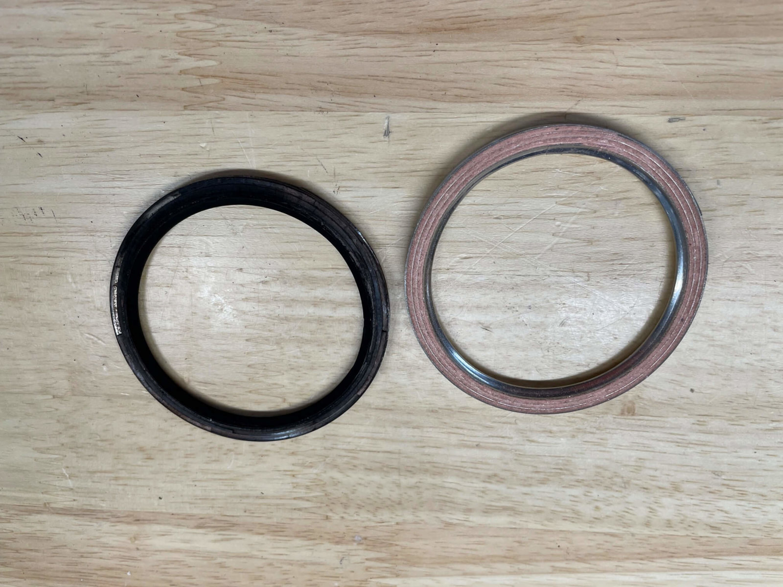

    Follow-up to my earlier post about the exhaust gasket for the connection just before the muffler for anyone that follows. It's PN 90917-A6001.
    I noticed some exhaust fumes when the rear cab window was open and after looking a little closer, found some condensation dripping from the joint when I first started it up. At about 45K miles, the old gasket was pretty worn out. Nice and tight now.

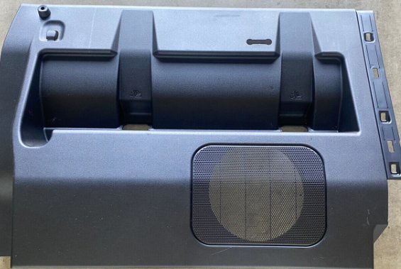

    Hey, I'm looking for the P/N for the Sub-woofer/backwall garnish/trim piece (for vehicles with a JBL premium radio, it would be behind the rear seat on the driver's side).
    Looks like the following:

    64429-04080-C0

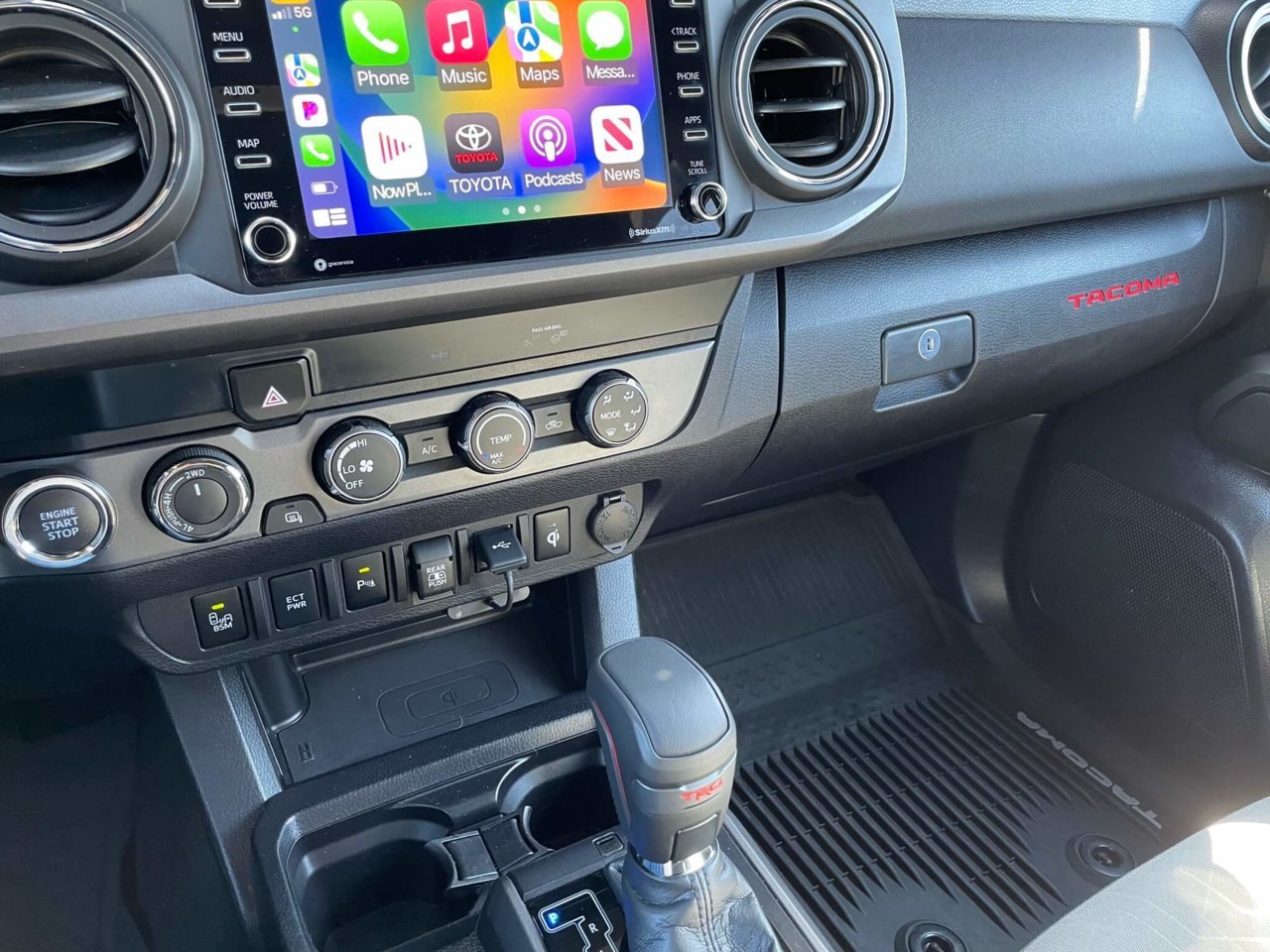

    Here is an option if you would like to add USB charging. I put on in my Taco and the wife's Rav. You will need an fuse tap, or similar to power it. It fits the spot the stock USB head unit connection on the dash.
    Cllena Dual USB Port Charger Socket Quick Charge 3.0 & 2.4A for Toyota

    Interesting. Do you know the trick to removing the switch area that it fits in from the dash assembly? I couldn't find a way to do it...
