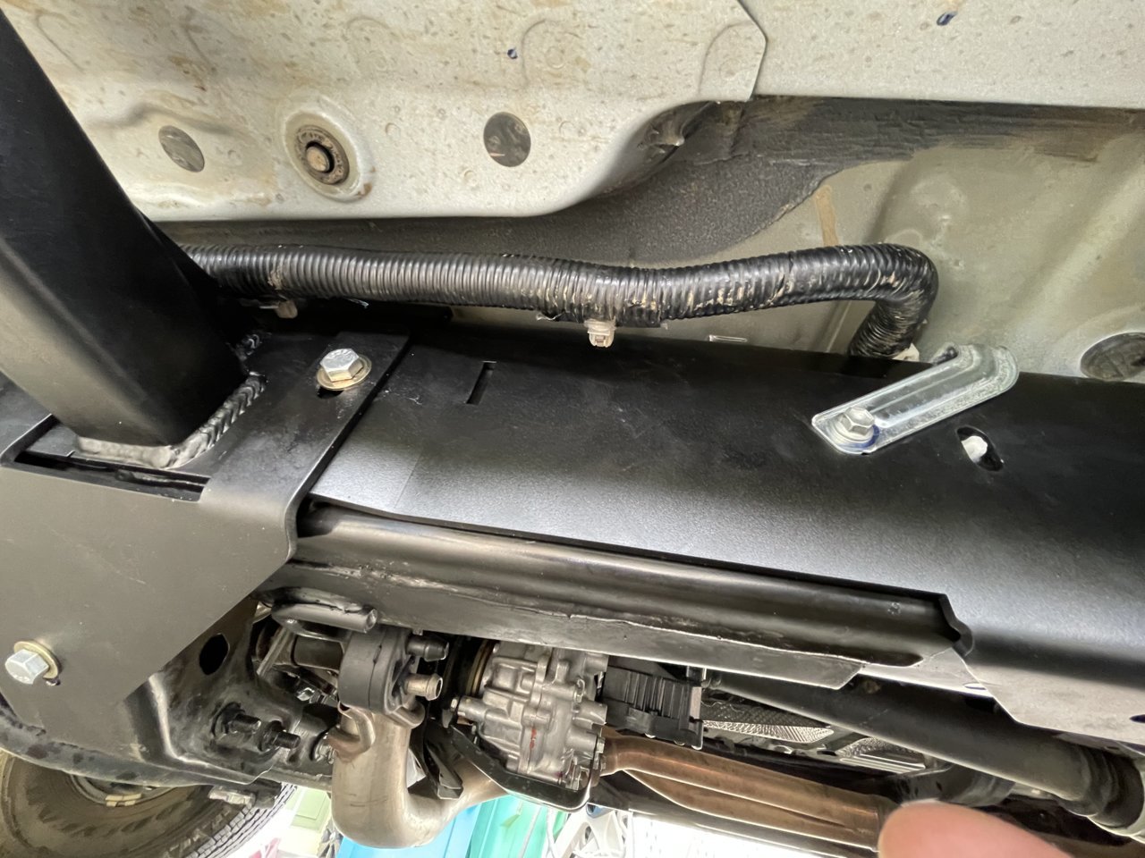

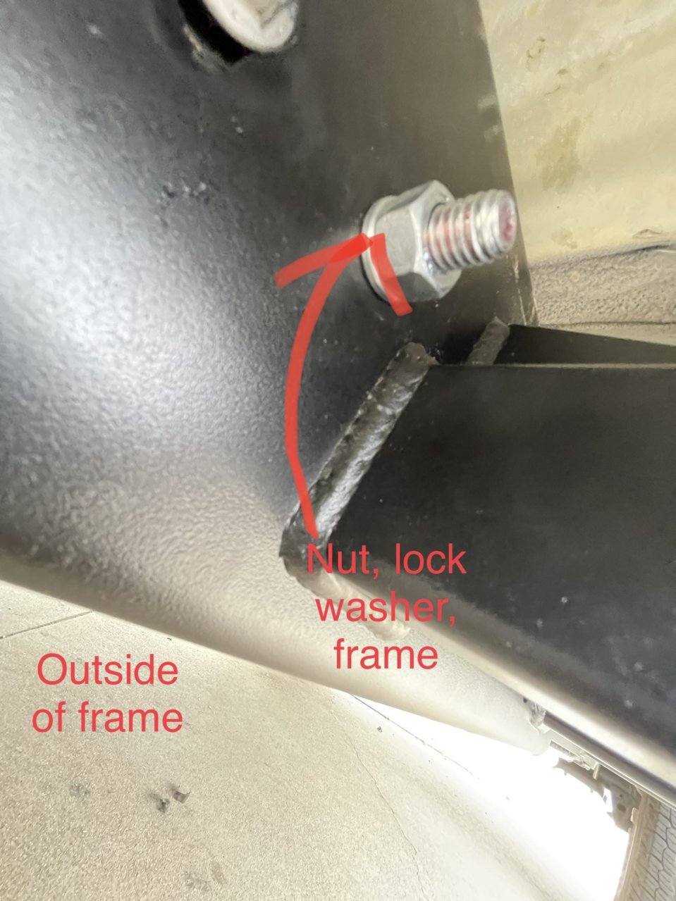

    I just installed my sliders. I did reverse the bolts on two of those near the brake lines. Codemancer, for the ones you reversed, did you put the nut and then the Locking washer on the outside against the slider? A00E4DA2-A049-4695-BBDD-9D4F40928ECA.jpg
    Also how did you deal with those wiring harness on the driver side?

    If you look at my #3 in the image you quoted you'll see that I did the same as you with nut, then lock washer, then slider. As for the wiring harness... I'm not 100% sure what you're asking? But I believe I only ended up reversing #4 in my images. #3 is the bolt that is located "inside" the box with the wiring harness and I believe I didn't have any issues with it.

    @Diesel156 oh do you mean how did I secure it since you had to pull the tab out? I had originally planned to go zip tie it, but I felt like it was actually fairly safe with little play in it. I probably should still go zip tie it though. Not exactly sure where, maybe that cross member between the first and second bolts?
