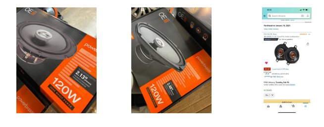

  13. Feb 14, 2021 at 3:30 AM
    captainvfr
    captainvfr Member
    Feb 15, 2020
    #319297
    21
    2020 Limited Cement
    I just upgraded my dash and door speakers via an car audio shop and notice a significant difference in sound. The dash speakers are much clearer and the base in the front of the vehicle is very noticeable.
    Dash speakers from Amazon. 2 ohm door speakers from Crutchfield. With install best ~$500 spent.
    Looking for some input on next steps with upgrading the subwoofer please.
