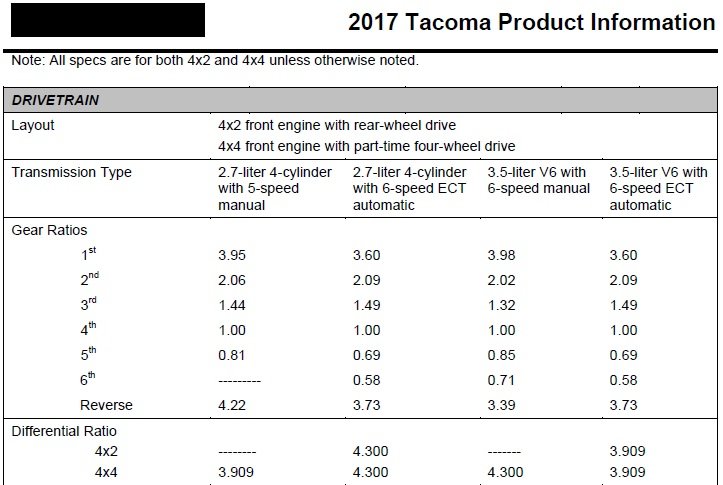

    It is kinda odd that they didn't use the 4.30 gears with the 4 cylinder Manual back when that model existed.

    Congrats on finding one, that couldn't have been too easy.

    Yeah it is, made me curious so I went back and looked at the specs, maybe it was a compromise due to the only 5 speeds in the I4 manual and the 5th gear ratio to ensure an adequate top end speed. Take a look at this chart and compare the I4 manual 5th gear ratio compared to the V6 manual 5th and 6th gear ratios:
    Edit, 2018 Tacoma specs lists a 4-cyl manual, however it was discontinued for 2018, so see the 2017 specs below:

    Thanks, I was actually trying to find that chart earlier today too, lol.
