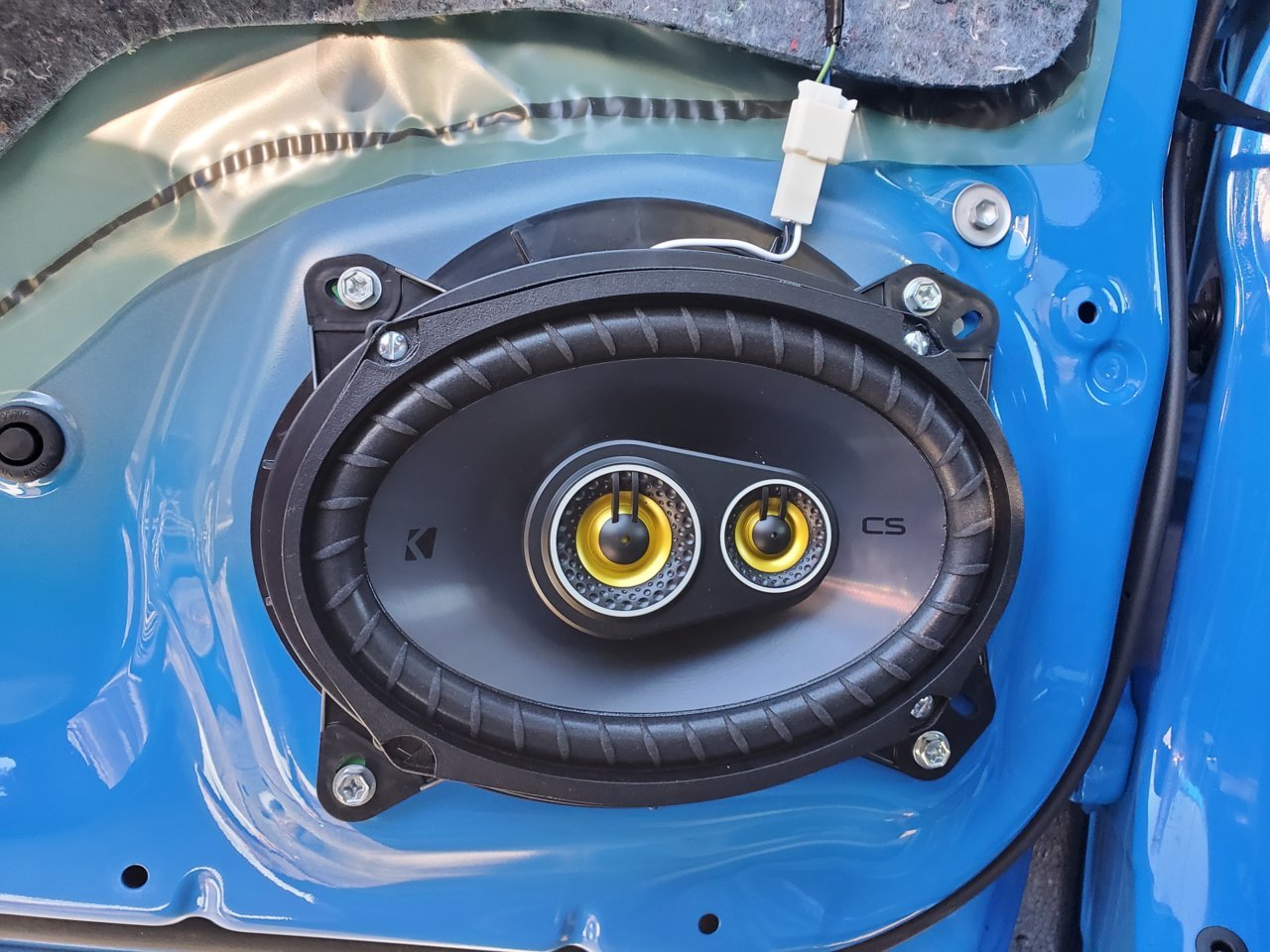

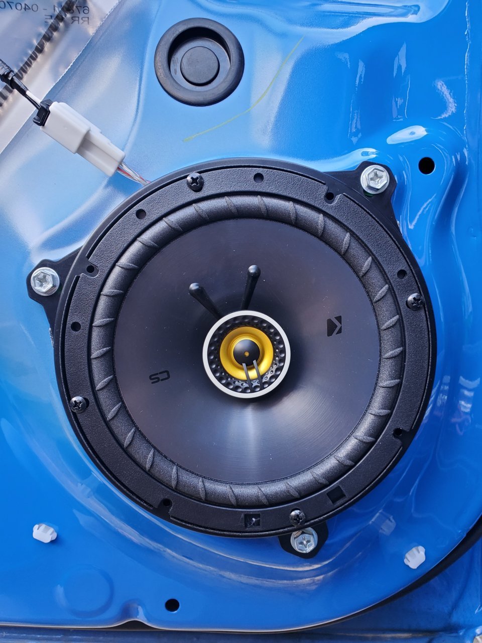

    Factory harness should define it by using an ohm meter. I would expect that of the 4 pairs of wire that 1 wire is common to 1 wire of the other pairs. I would expect to see 4 wires less than 1 ohm in an unbalanced circuit.
    The speakers I installed had a large and small tab so it would only connect 1 way. Either all the large tabs are common or all the small tabs are common.

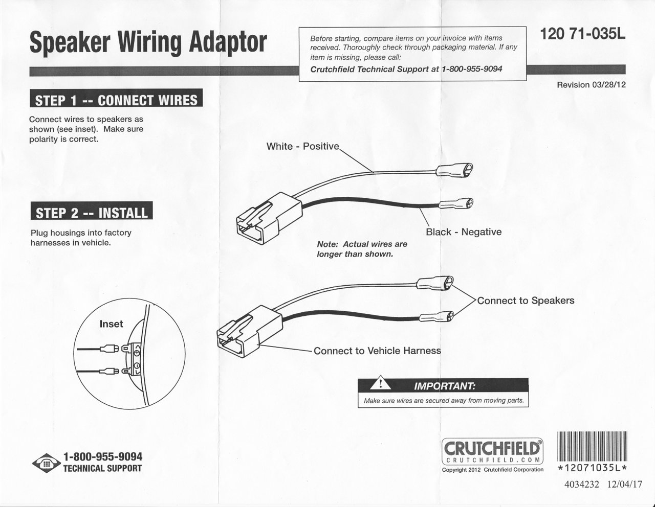

    Rear door speaker wire with ebay adapter cable/connector...
    Front door speaker with Crutchfiel adapter cable/connector...
    Crutchfield adapter harness...
    #33

    Thanks for the reply and pics, but the secondary reason I wanted the polarity is for powered sub speaker level input tap into the rear wires.

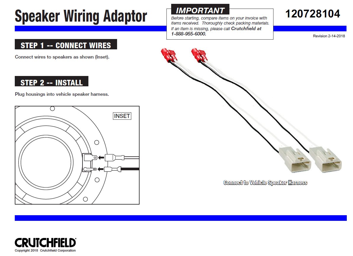

    Here is the actual Crutchfield sheet showing polarity. Small tab negative and large tab positive...
