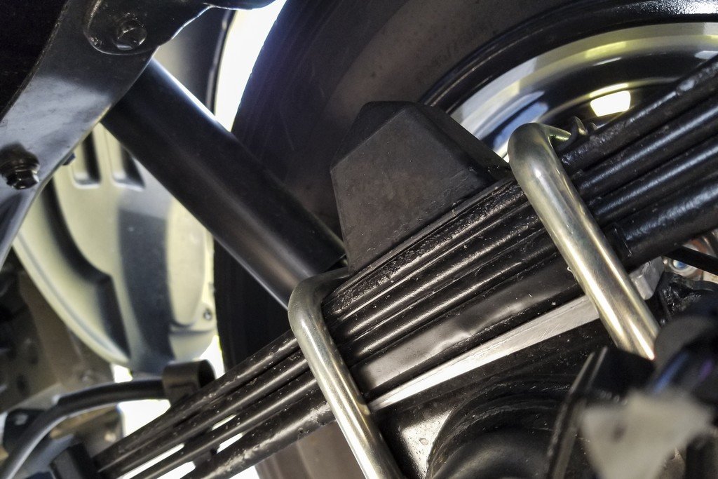

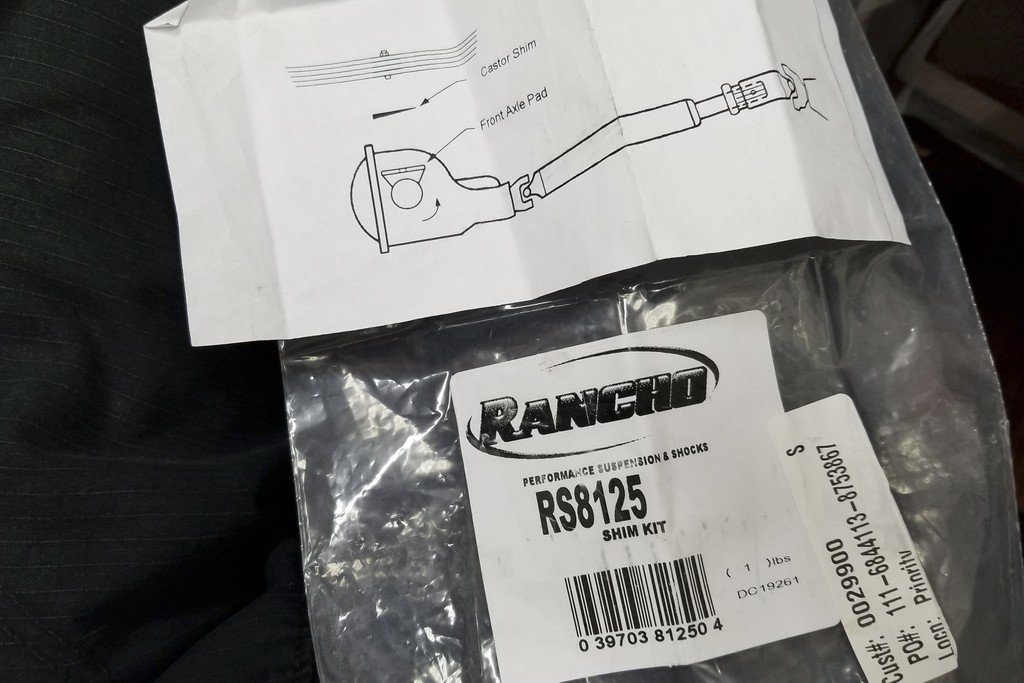

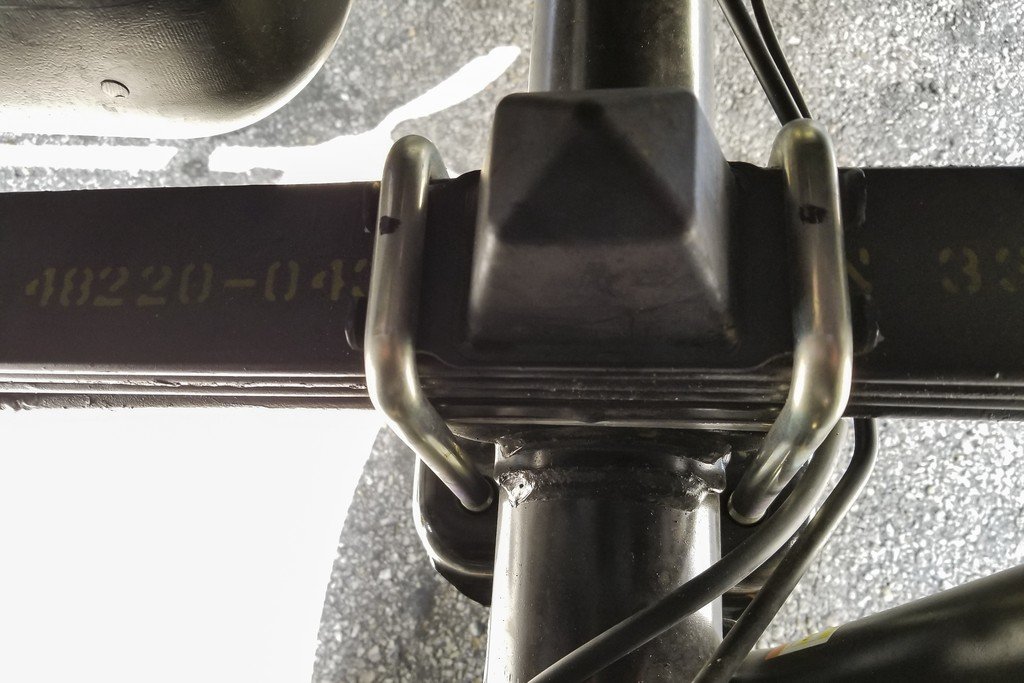

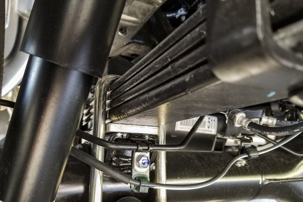

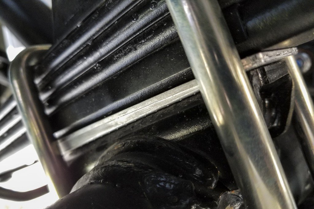

    I installed 2.5 Degree Axle Shims - Rancho RS8125 and fixed the vibrations! My all stock 2020 SR5 V6 4x2 DCSB truck drives smoother all together now! This did not require to remove the leaf bolt/pin and so it might not be recommend for hard core use since the leaf set pin is not set into the axle now. I torqued my U Bolt Nuts to ~57 foot pounds. I paint marked the brackets and u bolts to reinstall everything the best I could back into the exact same position as factory.
