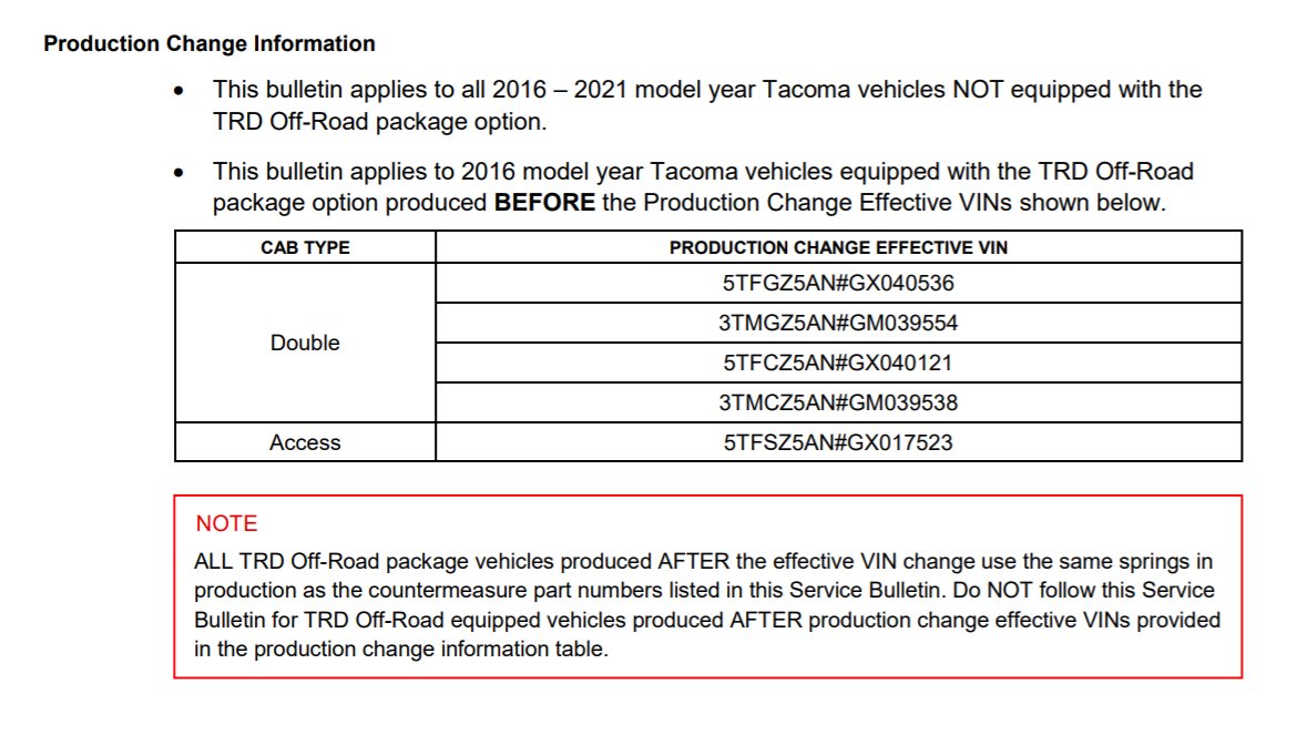

    TSB0092-20 will fix the transmission issues
    It should be available on your 2020
    I had it installed and it fixes 95 percent of the issues
    gearcruncher likes this.

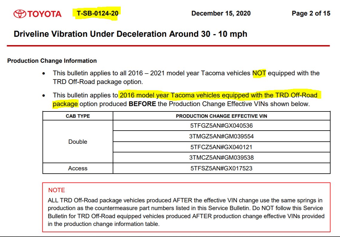

    Force your dealer to perform the tsb . There is $2500 bucks worth of improvements here only available for 3 years or 30K . I highly suggest you get this done
    The boys at Tacoma World want to see you guys happy . You paid a lot of money for your truck . Use the technical service bulletins to your advantage while you are within the rules of Toyotas guidelines . :thumbsup:

    An important part of the TSB provided is to ensure your Tacoma fits into the range of vehicles covered.
    Essentially, the TSB requires measurement of the driveline angles and if not in specified parameters, new leaf (revised) springs are fitted. There is also a change in the steering wheel dampeners.

    Wait, so if my VIN is 5TFCZ5AN#LX23#### does that mean mine “should” have the updated parts?
  11. Jan 14, 2021 at 6:46 AM
    #91
    Fast1
    Fast1 Well-Known Member
    Jun 24, 2009
    #18875
    1,138
    Minneapolis, MN
    2021 TRD Off-Road Access Cab
    that is the way I read it..

    Any chance you know the TSB number? I checked Google and cannot find this one.
  14. Jan 14, 2021 at 1:52 PM
    #94
    hotrodder636
    hotrodder636 Well-Known Member
    Jul 11, 2020
    #334136
    186
    2020 Tacoma TRD Pro (MGM)
    It is attached in post 86
