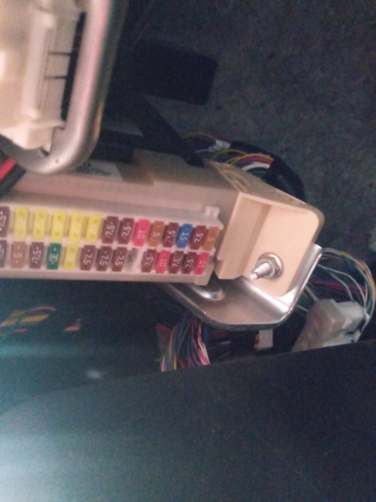

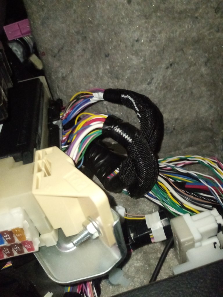

    I don't see anything that looks like that and it's starting to rain so I'm done for the day.
    Thanks I might need to take it to a shop. I'm looking at trading it in on a Tundra anyway.
    I don't see anything that looks like that. It'upload_2025-4-10_12-2-5.jpgupload_2025-4-10_12-1-15.jpg

    Those connectors are behind the left kick panel.
