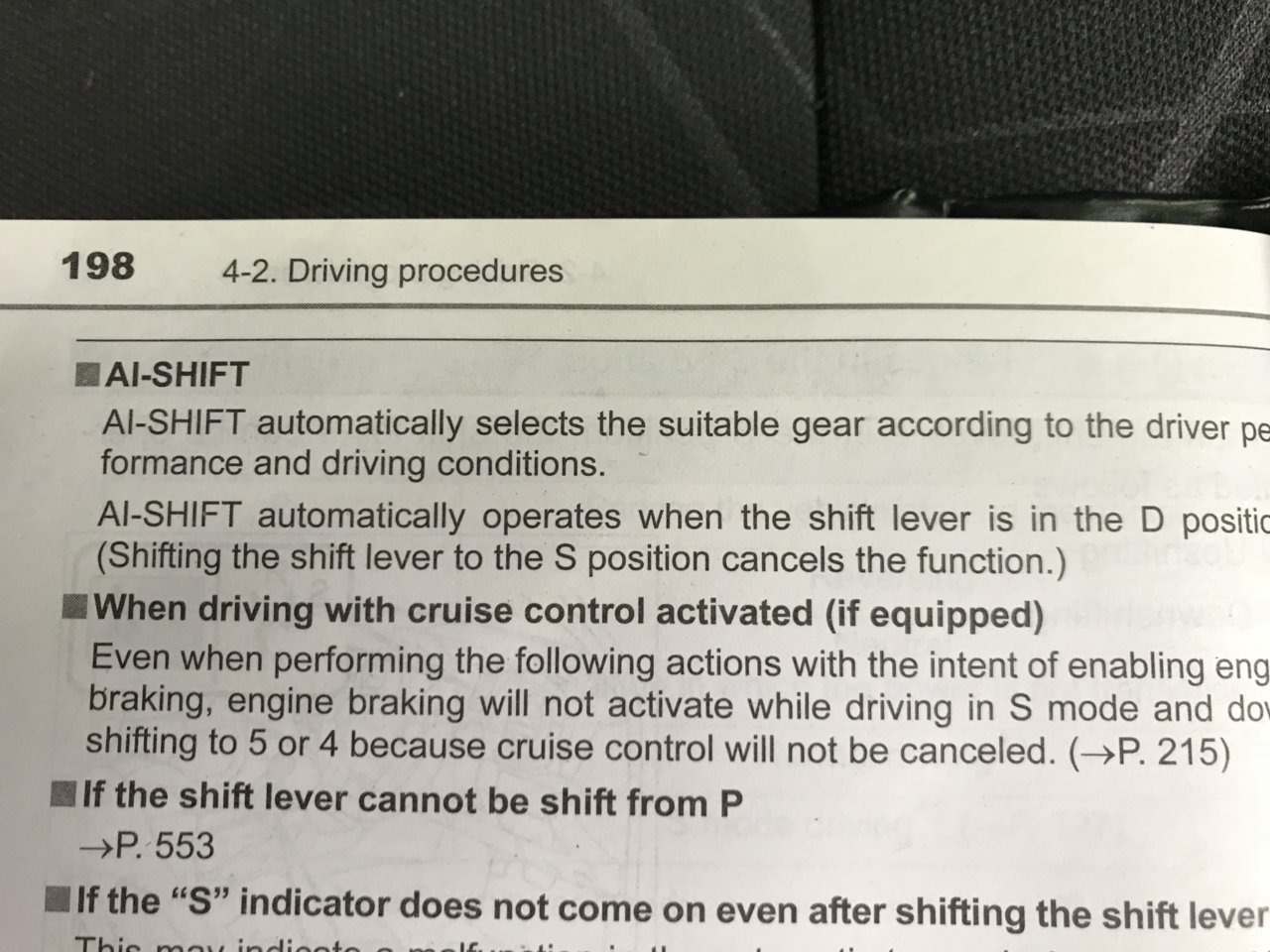

    Bach88
    Bach88 Well-Known Member
    Feb 8, 2018
    #243814
    81
    Florida
    2016 Tacoma OR DC
    Actually it’s the opposite. Driving in S-mode disables the learning crap in the transmission. It’s called AI-SHIFT in the manual. Once I read that in the manual I started driving only in s-mode and now it shifts like it did when I first got the tsb.
    Still a little lag in the throttle response but nothing like before. I don’t know why Toyota tried to put skynet in our transmissions we are already slaves to these trucks. :D
