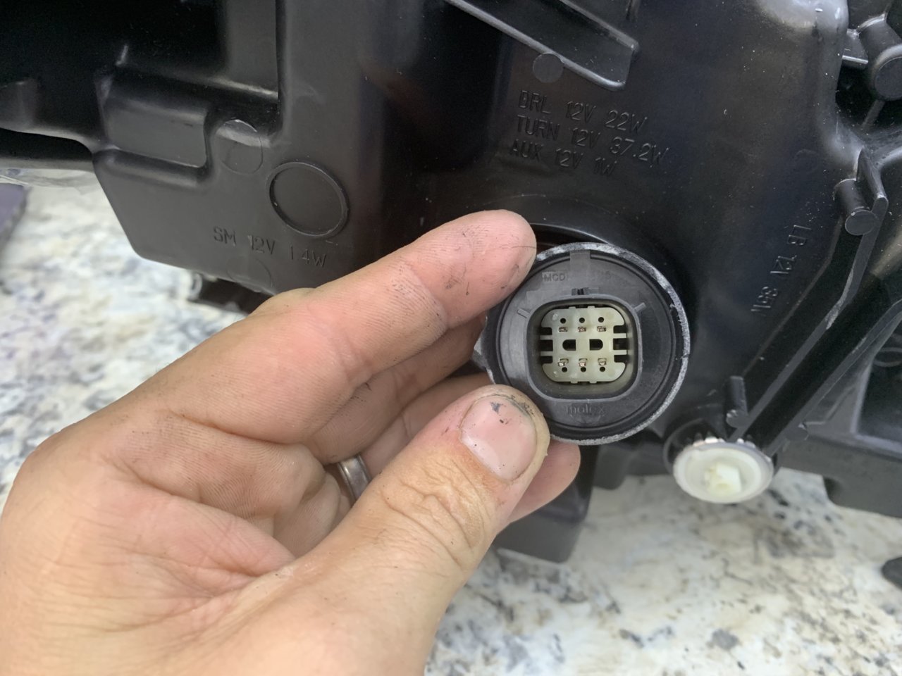

    I don’t remember which is which but
    33472-0601
    33482-0601
    those are the molex numbers

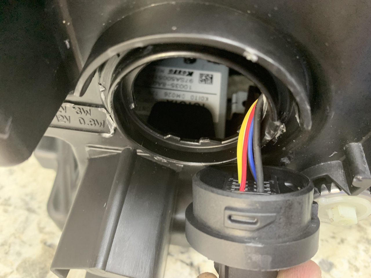

    So looks like we only need the male side and just repin it ourselves. Maybe we don’t need a conversion harness

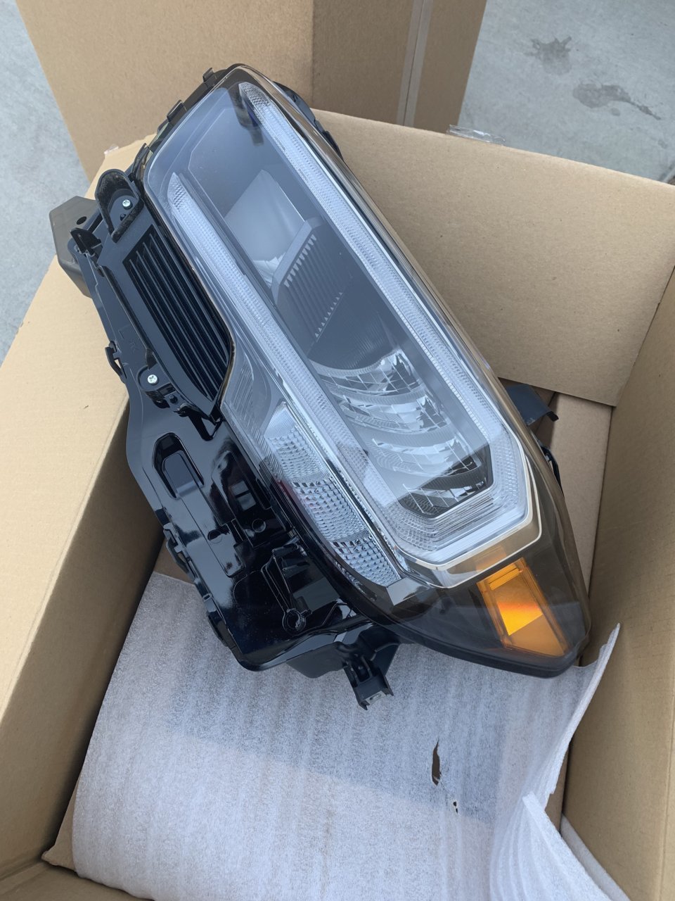

    Those are some nice looking headlights

    I powered up the headlight earlier and tested all pins. The parking light is odd, it illuminates the DRL as well the the little reflector light beneath(where the “TRD” and “PRO” sit). Otherwise pretty straight forward.
    GROUND
    TURN
    LOW BEAM
    HIGH BEAM
    PARKING
    DRL
  11. Oct 11, 2019 at 7:57 PM

    Didya test the DRL alone to see if the "TRD" and "PRO" stay off? (I'm thinking same as prior models, where DRL goes OFF with headlight select but Parking (TAIL) provides power of a dimmed illumination of the DRL's)

    Yes, the lower PRO does not illuminate on DRL mode. It’s tied off the parking light circuit

    So models with incandescent turn/drl lamps are going to run into issues...:pout:

    Yeah. Probably like the Morimoto headlights, you will have to run a separate wire and tap off an ignition source in the fuse box
