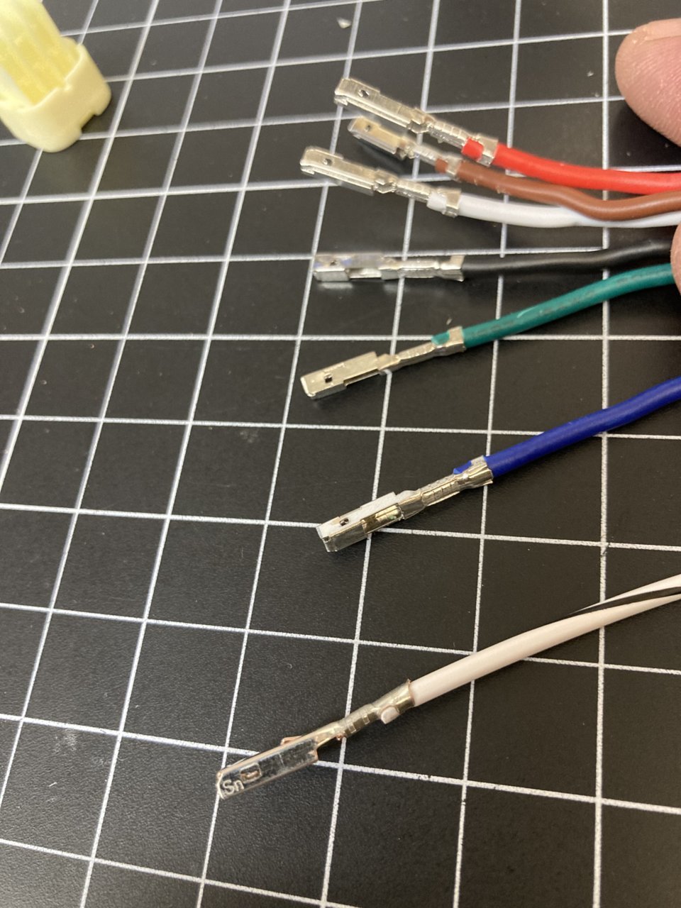

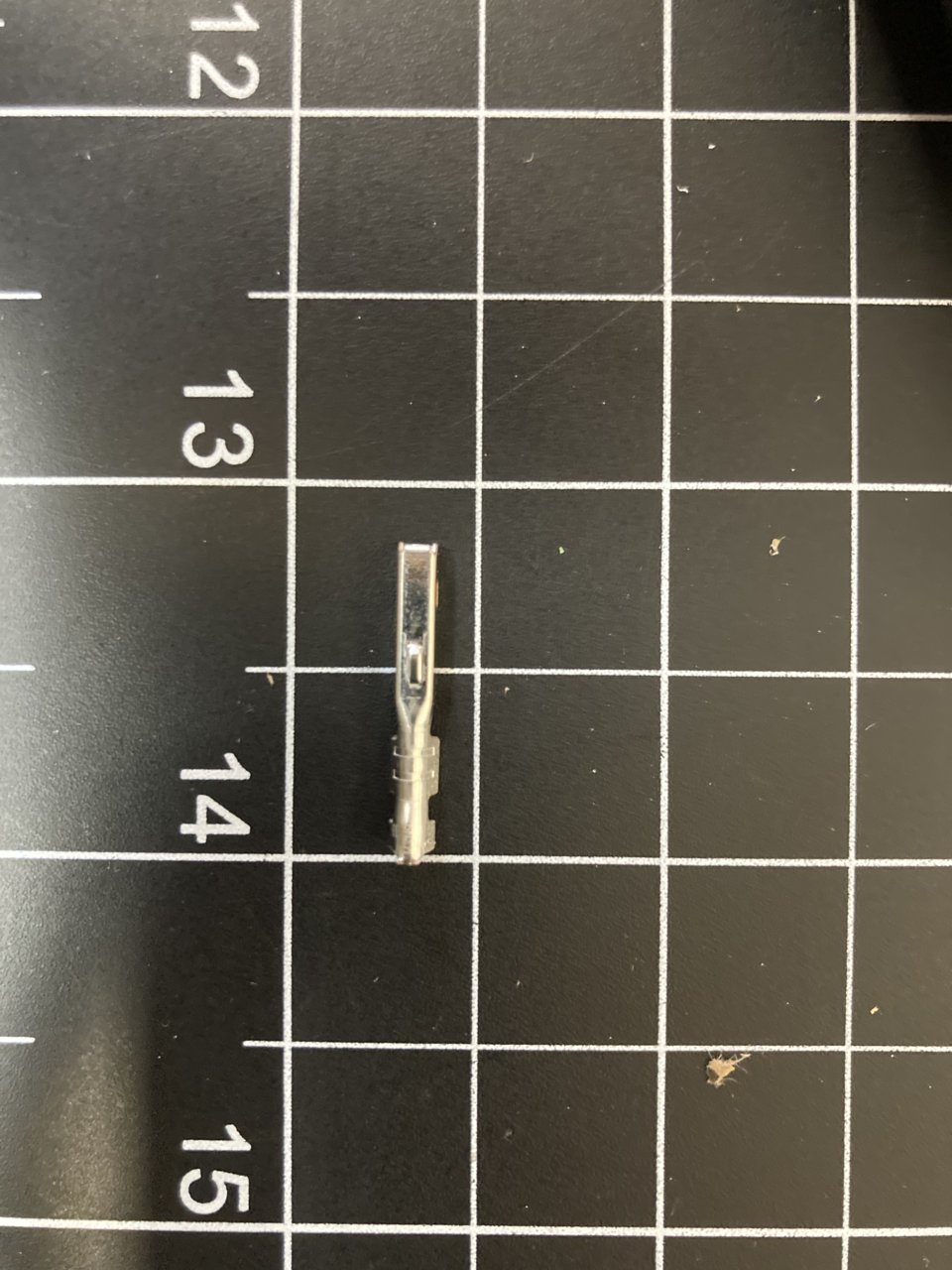

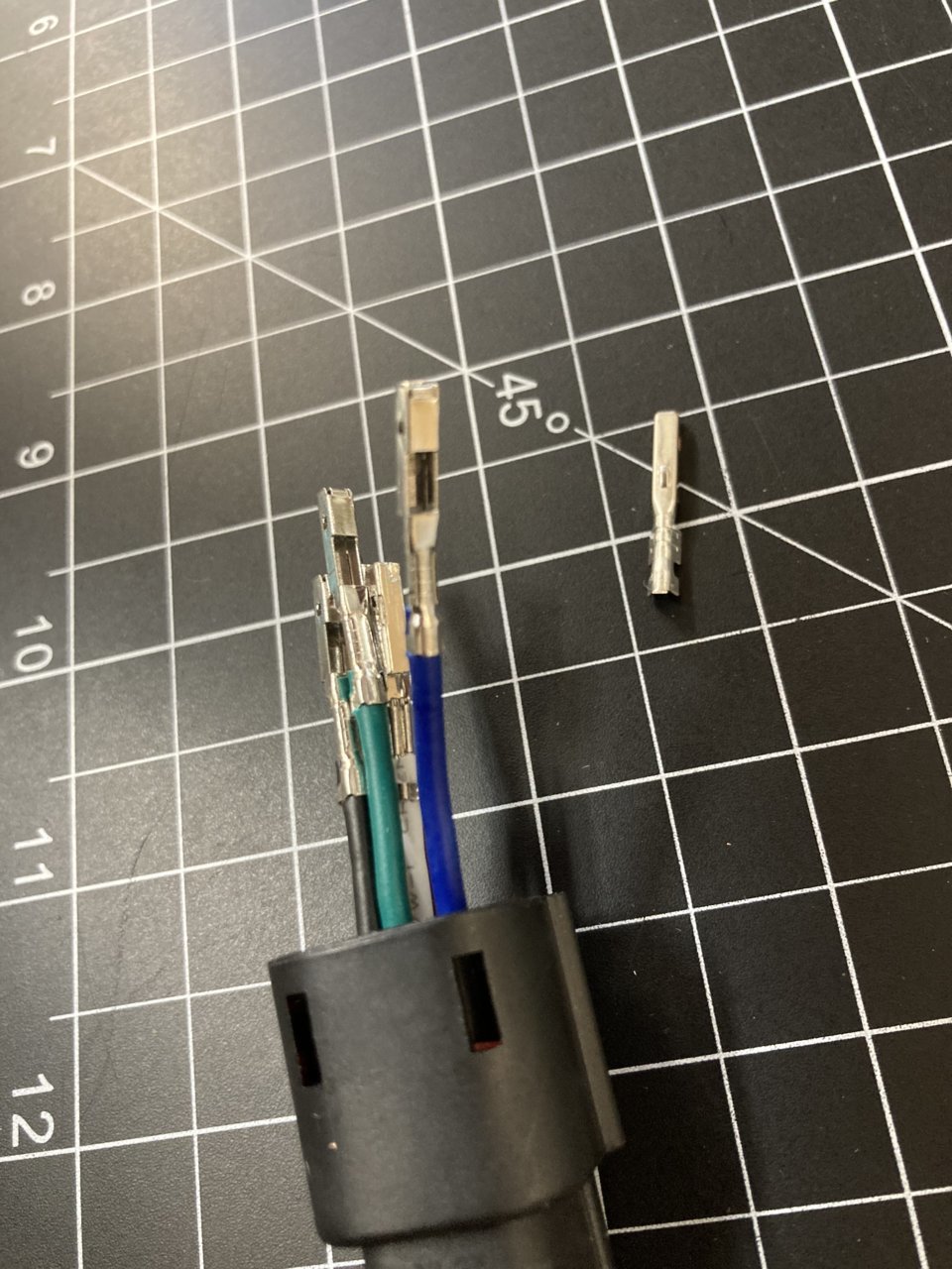

    I’m dissecting the @.J. harness right now which I believe is the eBay one I recommend in the info thread. It looks really nice on the outside. The terminals are different than the ones I receive from my vendor who is US based and reputable. This is common for harnesses made overseas though and all the crimps look fantastic. I cannot tell any difference in dimensions of the terminals with my micrometer, they seem a very close match.
    I’ll test continuity next.
    @Puppypunter anything else I should be looking at or checking?

    Everything about this harness looks great to me. They use 16 gauge wire to my 18 but if the terminal is sized to the wire it's never problematic to go bigger.
    My best theory here is that the terminals used are just not quite perfect enough of a match to hold tight and perhaps the unreliable connection (potentially experienced post install via vibration from driving/engine as the terminals settle in) causes the ECU to freak out a bit?
    That's total BS theory though, zero evidence to conclude that other than my visual inspection that the terminals are definitely not the same as the ones I receive when I purchase MX-150's.
    So as to not pollute this thread further, I think I'll move the in-depth discussion to the OEM LED Conversion Harness DIY thread.

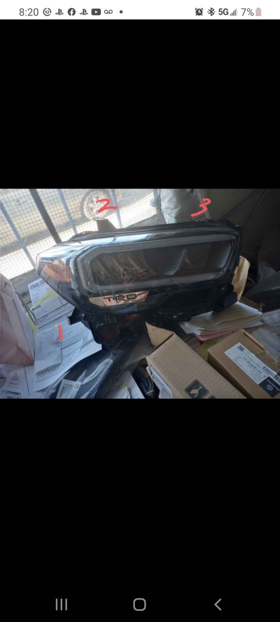

    Is there anyway to mount this headlight with a broken tab? #3

    Do you have the tab or is it completely missing?

    Guy says he doesn't have it

    What is his price? My over - under with a single broken tab and no other damage is probably $200. I think you could cut one off a damaged halogen and then just need to get it transplanted.

    Yeah he wants $200 for it.
