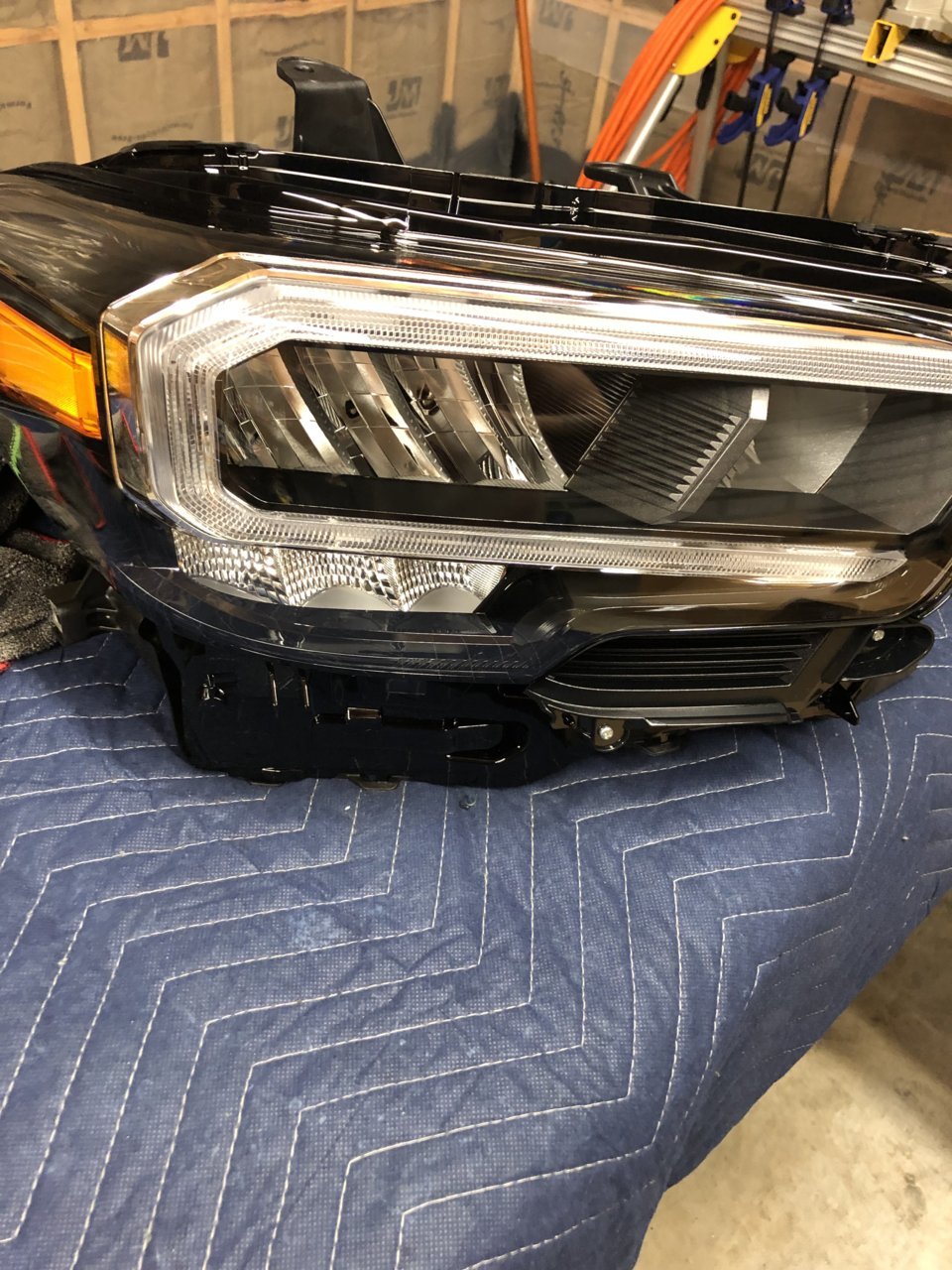

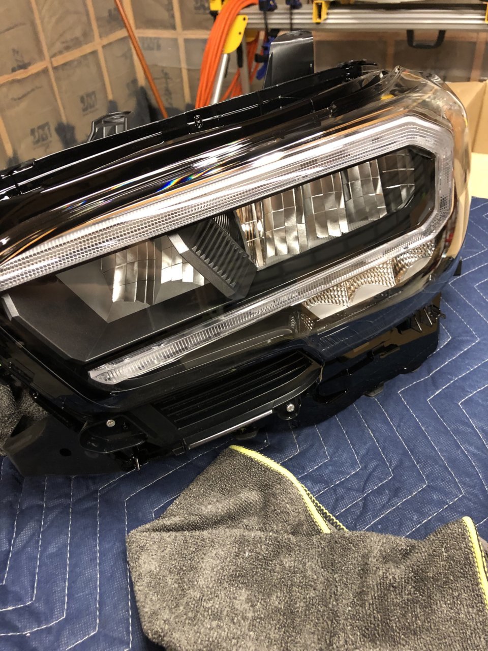

    FishnTx
    Mar 22, 2017
    #214004
    9,173
    South East Texas
    ‘17 OR
    Got em in no broken tabs that I see of

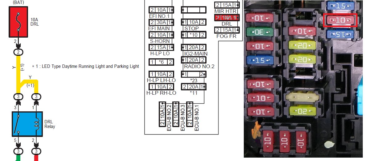

    wv_country_rds
    wv_country_rds New Member
    Mar 18, 2019
    #287110
    3
    2018 MGM TRD Offroad
    I am using the TRS Harness on a 2018 TRD OR. After I hooked everything up, the DRL lights will not turn on unless the stalk is turned to parking lights. They will not turn on if the stalk is set to DRL. Anyone have any ideas?

    #2138
    daveeasa
    daveeasa FBC Harness Solutions
    May 14, 2020
    #328079
    7,479
    David
    PNW
    2016 Tacoma OR DCSB 6MT, 2005 RC 5MT PreRunner, 2002 Tundra SR5 RCLB 4x4
    I suspect you may be mistaking the dim lighting of the DRL when the parking lights are switched on with actual full bright DRL which seems to not be working at all.
    or not so much mistaking but noticing and describing as best you can.

  20. Sep 17, 2021 at 5:37 PM
    #2140
    wv_country_rds
    Mar 18, 2019
    #287110
    3
    That is possible, but at any rate the DRLs are definitely not turning on. I’ll look for a fuse in the morning.
