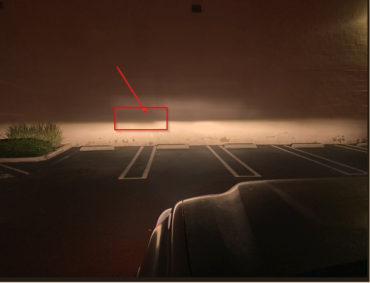

  13. Oct 13, 2021 at 10:26 AM

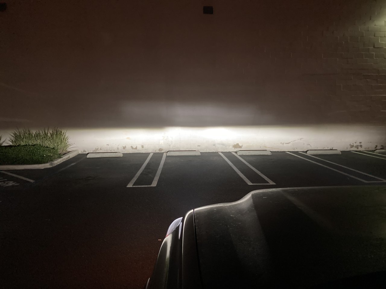

    Hey Dave,
    I have attached the photo with a spot highlighted, can you confirm this is the notch you are showing for the driver side.
    Also is that your photo? If so how far away from the wall are you?
    I will try to get a photo similar and show my beam. I think mine might be a little bit more drastic cut out.

    Yes it's my photo from my truck. Yes that's the notch I am referring to.
    I am not sure exactly how far away I was at this point. I'm also not sure I was on level ground. So I'm not sure I'd put much of any concrete value on the height above the ground if that's what you're looking for.
    The passenger side hot spot seems to be to the right of the red rectangle.
    You might also want to review crashnburn80's review of this headlight in the 3rd gen lighting thread but a quick skim there seems to show that he mostly uses the passenger side?

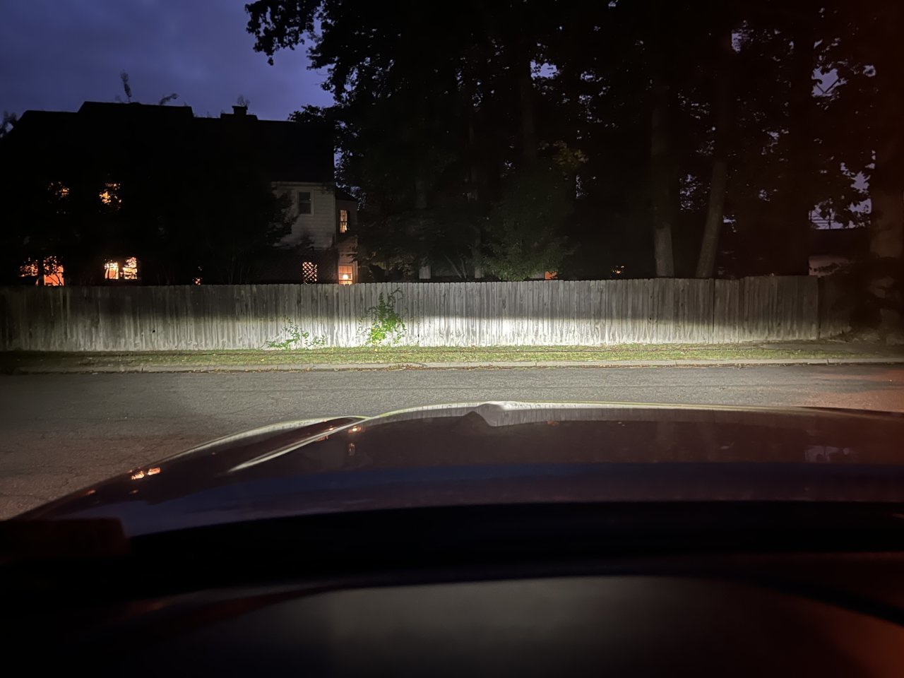

    I notice the notch and at first thought the driver light was just low. Up against a wall they are both level. You can see it against the fence in the pic below and yes my truck is leaning right because of the curve of the street.1BAD7802-22F1-40CA-97E3-49721CFFF5F8.jpg

    Woah, that is a good example, and looks similar to mine.
