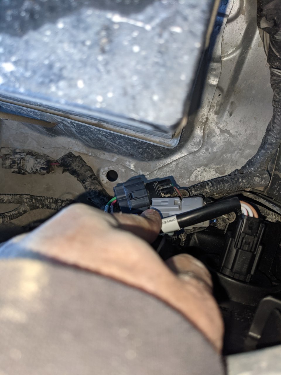

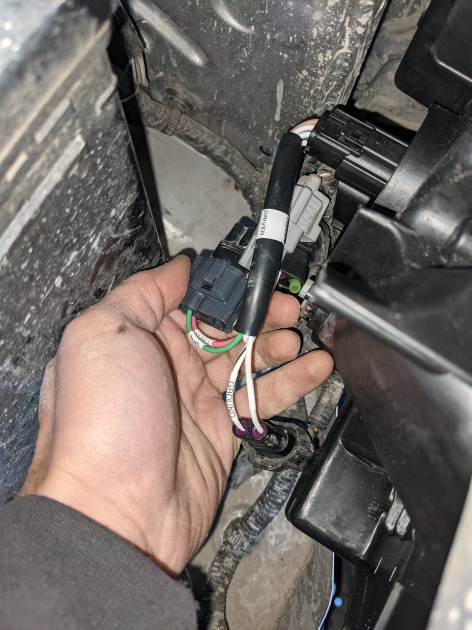

    Driver side. Let me know if you need a different angle or the passenger side also. Neither side drl turn on when I turn the knob to drl on the steering wheel with the car in park

    That’s one of my harnesses. It clicked in all the way? Wires look correct on the conversion harness side. Do the color match on both sides?
    the fuses are in the main fuse box so worth a peek there. I’m not sure I know exactly what position but the cover might have it.

    Oh but you did turn ignition on and drop parking brake, yes? That’s required for the ECU to fire up the DRL.

    Parking brake!! Good call. Everything works. Thanks for the help

    The ECU does not fire up the DRL signal until the parking brake is disabled. From there, it stays on if the brake is re-engaged.

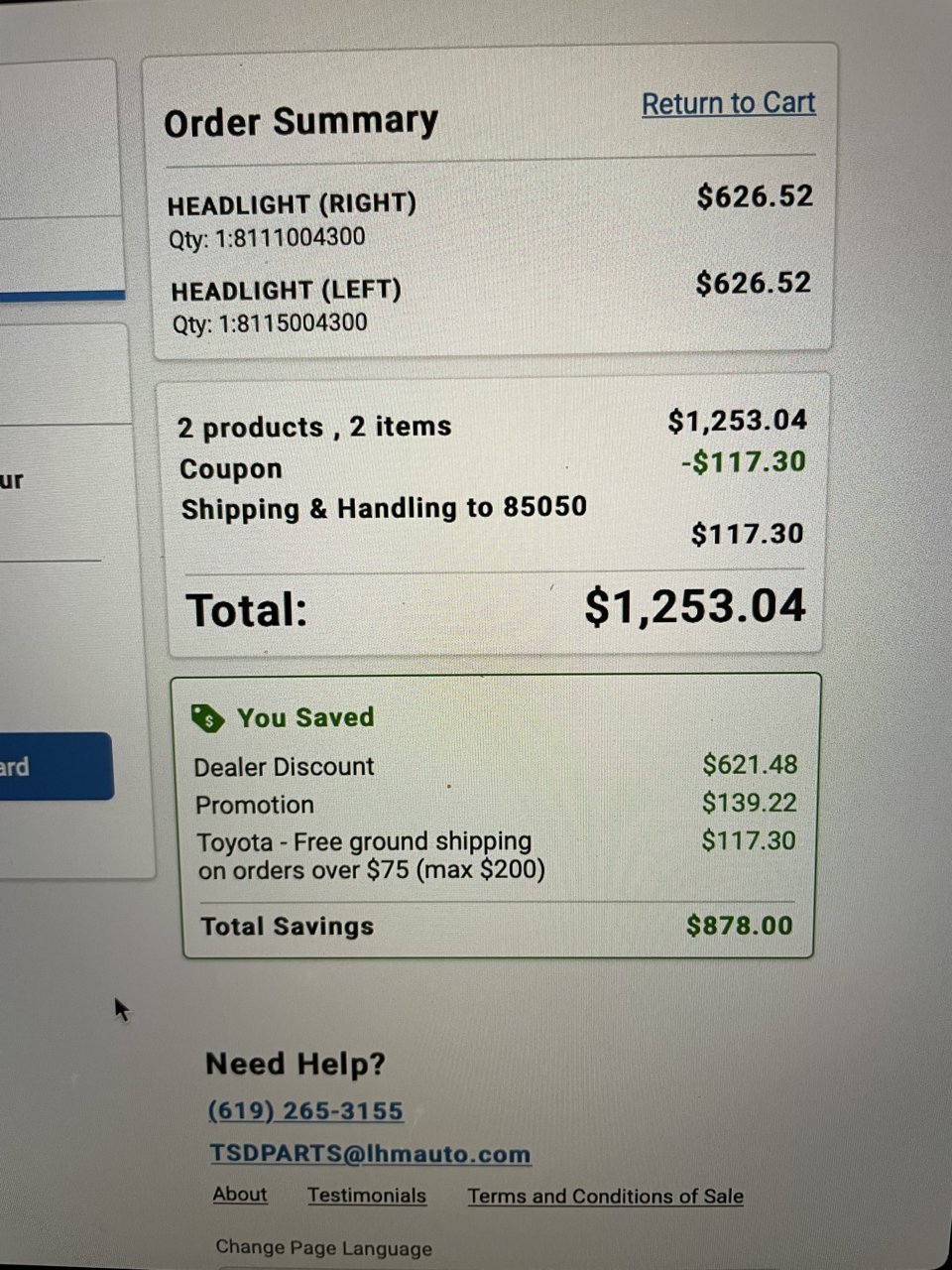

    This was the best I saw from several dealers today. And I'm getting chase freedom 5% back using PayPal during checkout. Limit of $1500 spend per quarter.

    So, I found the exact same deal at Larry H. Miller Toyota in Lemon Grove, CA. Same price, no tax, free shipping (using code FREESHIP), $1253.04 to my door in AZ. Offer is supposed to be good until 11/29. My card only offers 1.5% back, but that's still almost another $20.
    Going to sleep on this decision tonight and give it some thought. :notsure:
