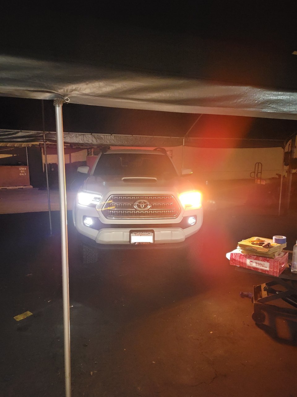

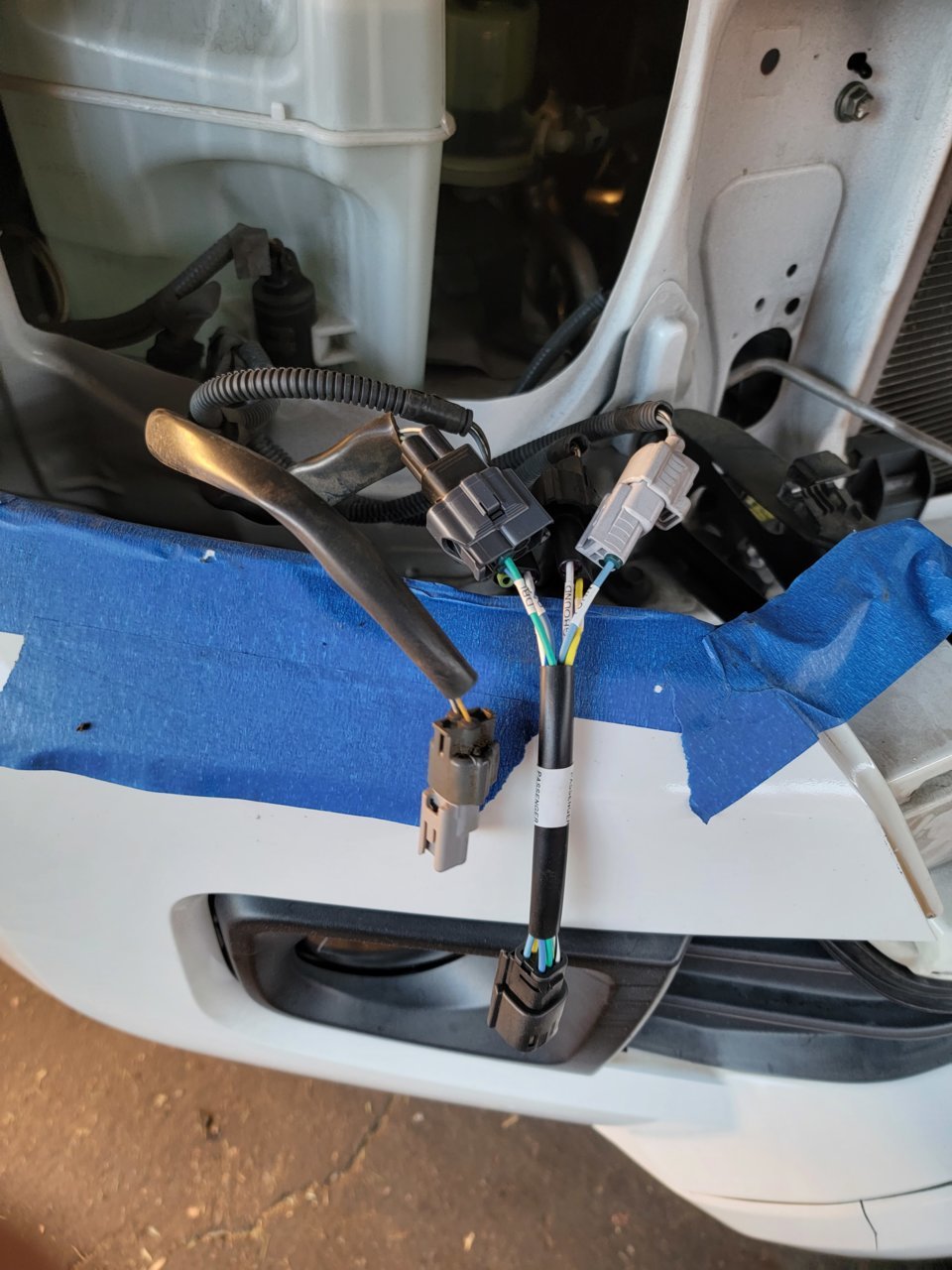

    Just installed the oem headlights and fogs for a buddy last night with Dave's harness. Wire harness was very easy to work with; labeled, color matched, and perfect length (not too long).
    Once I turned on the headlights, the passenger side was dim and the lower led was flickering, found out I had reversed the high beam plug :facepalm:

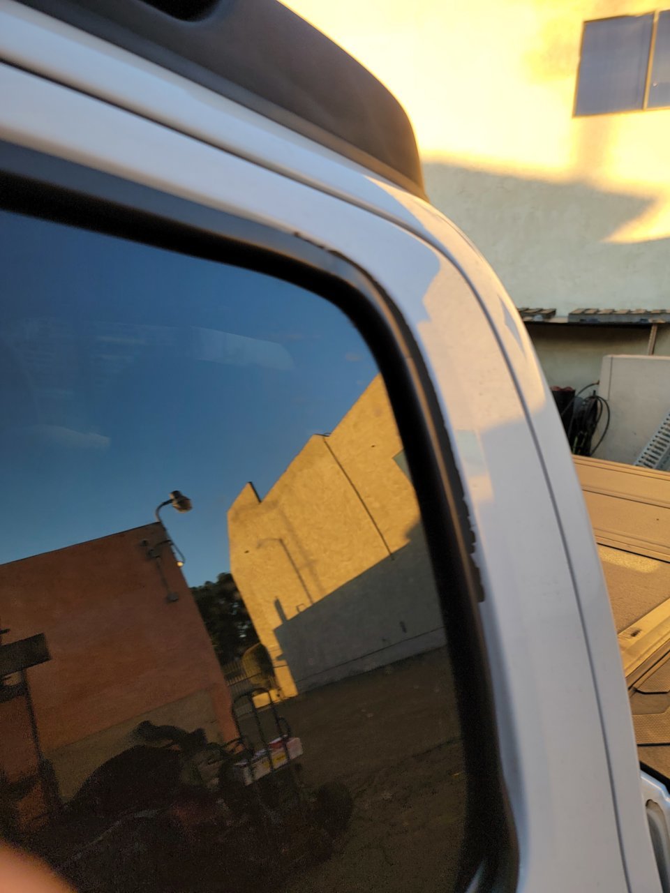

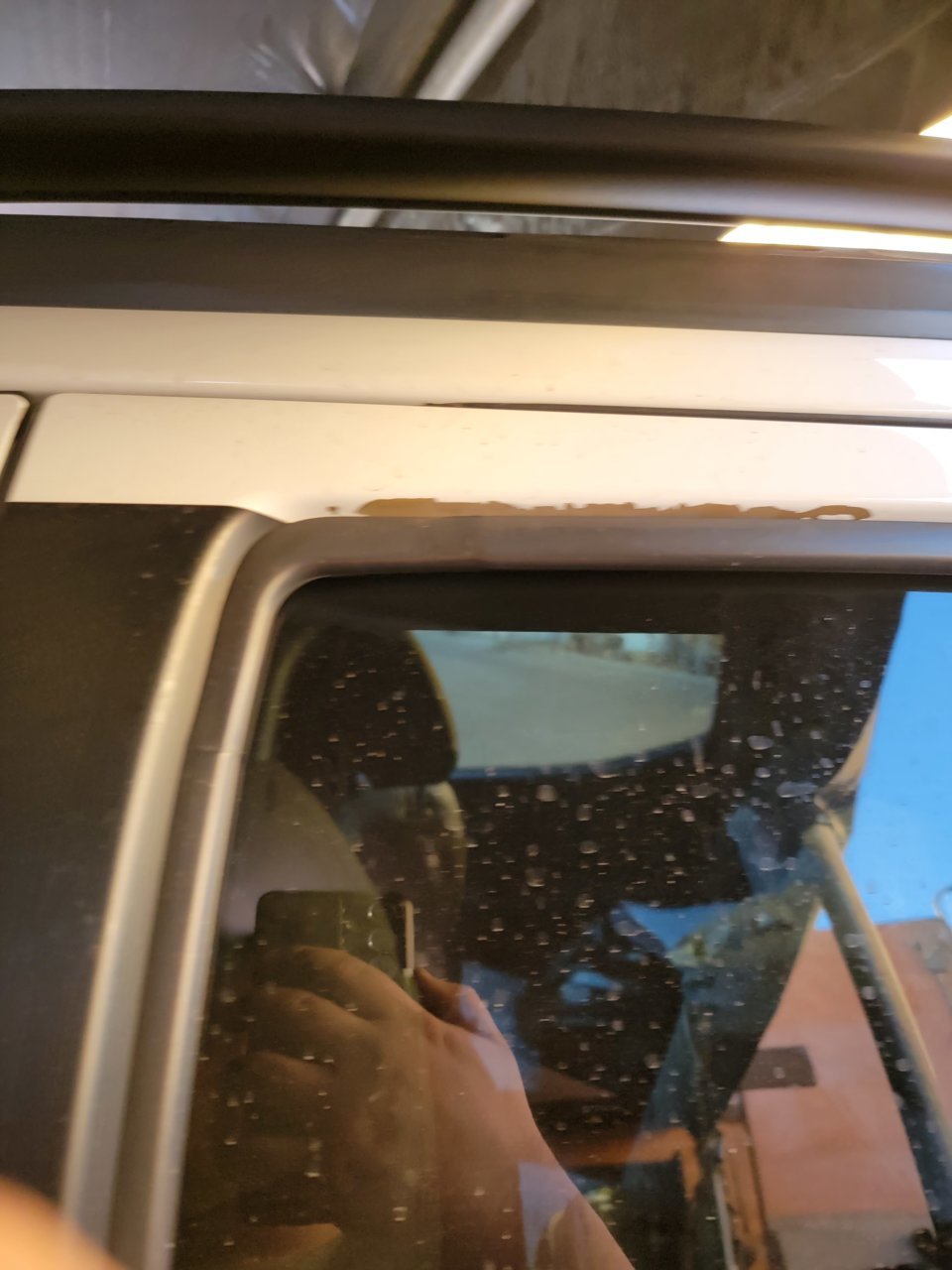

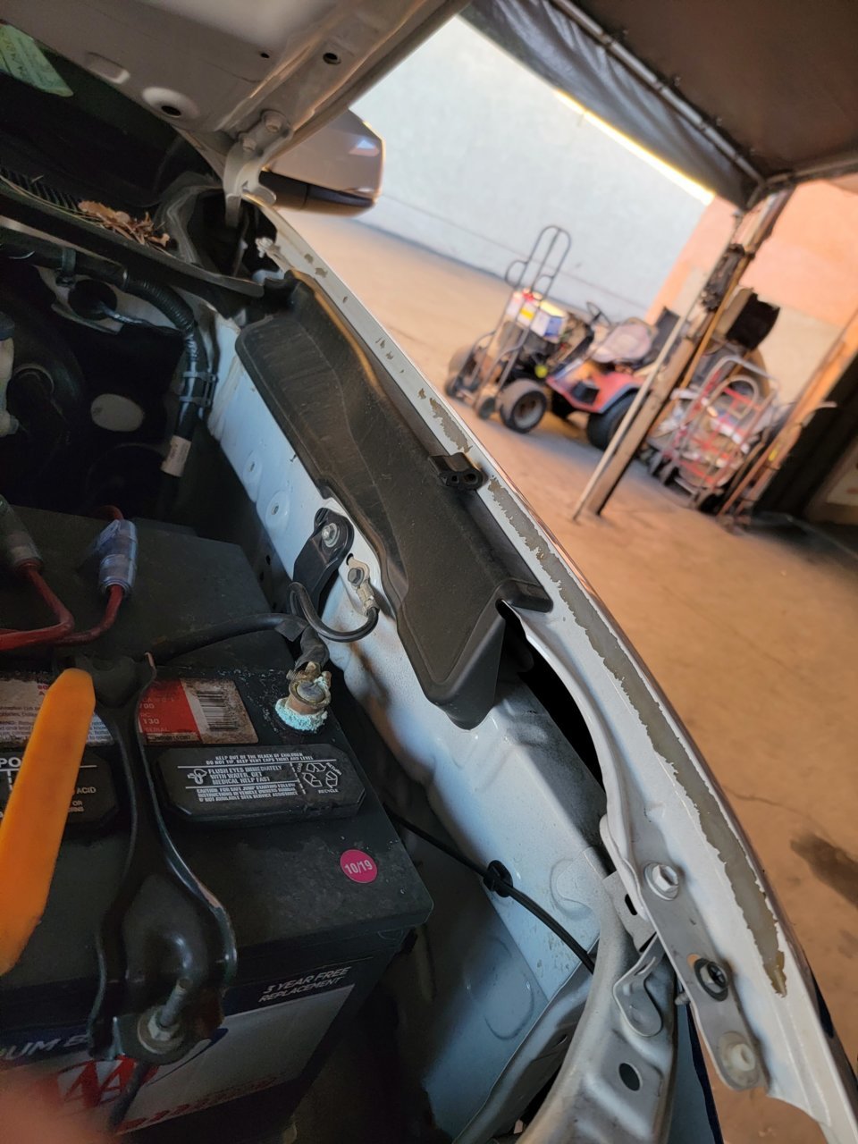

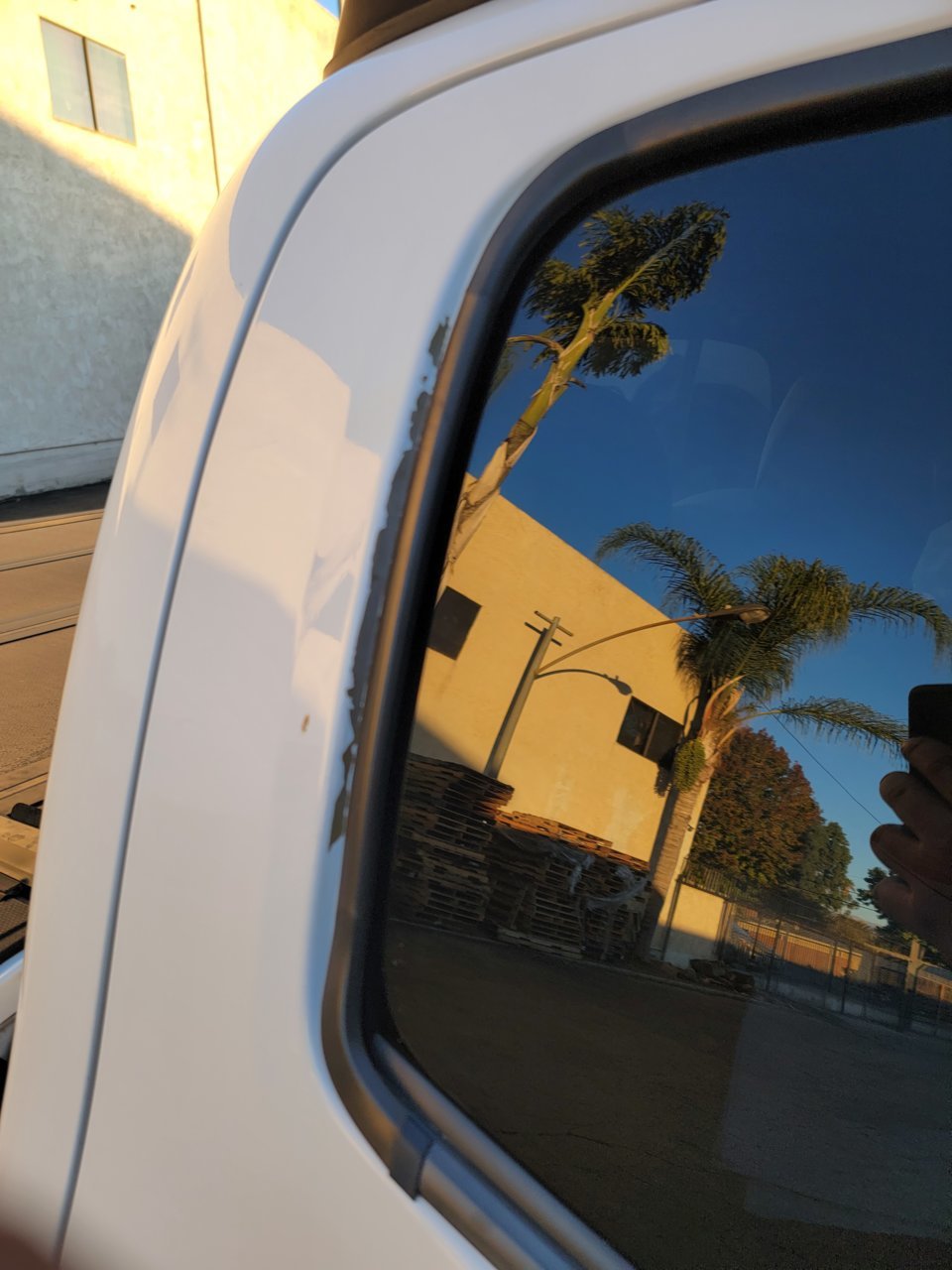

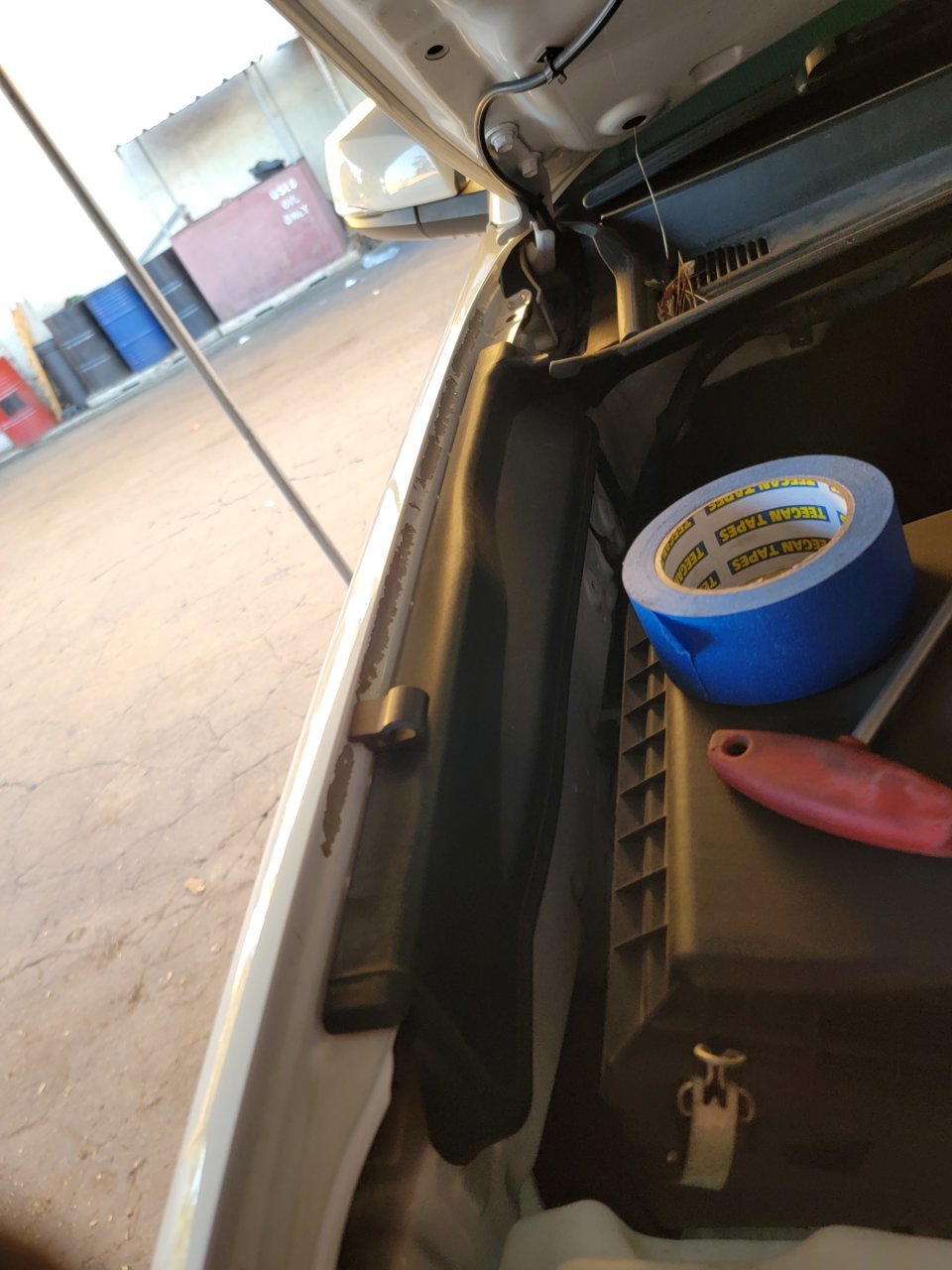

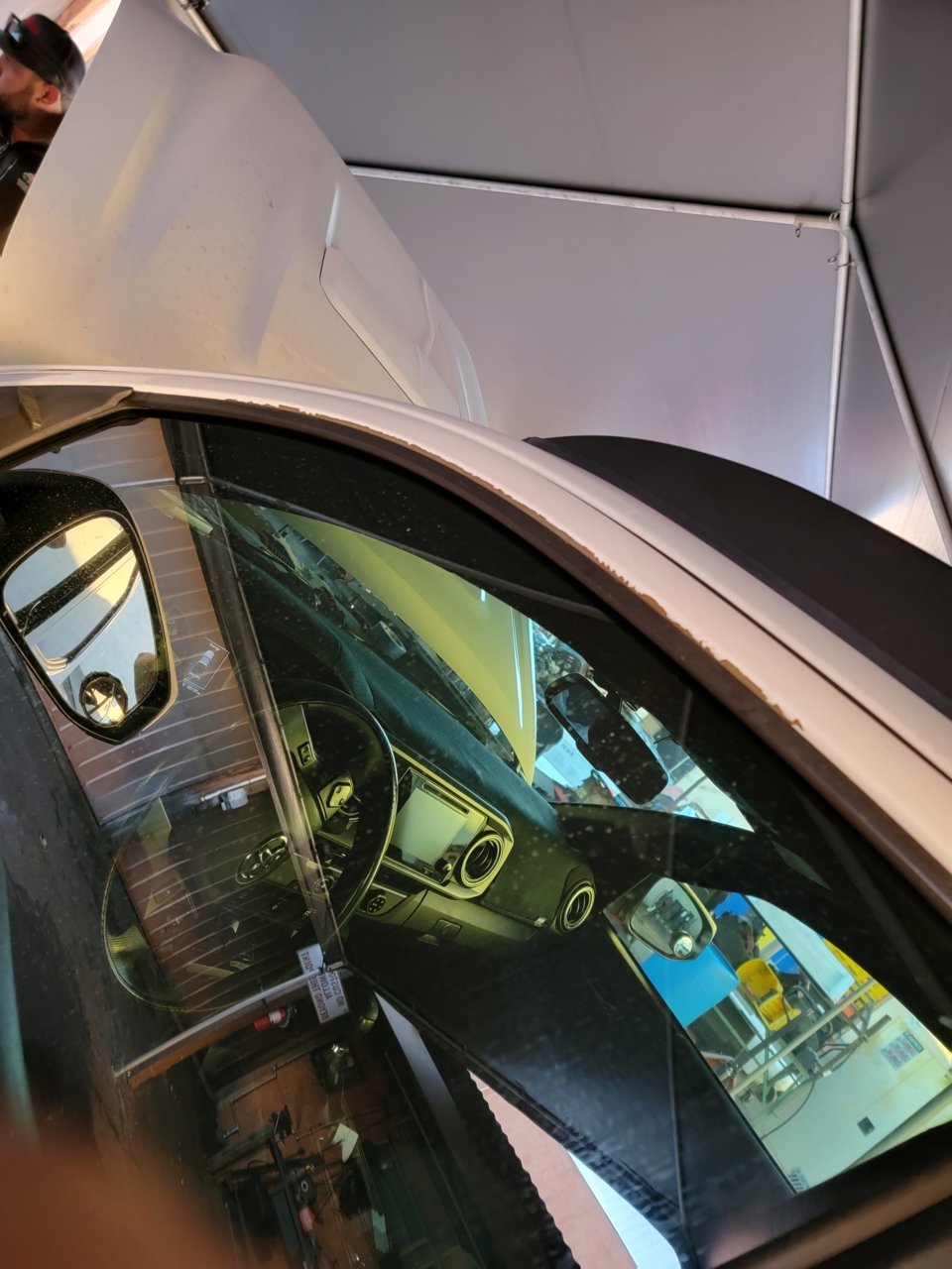

    Only one crappy picture, started late, was too dark. Also couldn't help but notice Toyota's infamous super white paint...

    Your buddies truck still under warranty? Toyota should be fixing that

    Might want to clean and treat that battery terminal.

    I was just going to say that! Mix up some baking soda and water in a small cup and pour it over that crusty terminal. It will dissolve the corrosion buildup. You can also apply some battery terminal spray from CRC if needed.
    Yep, get ahold of Toyota corporate and start a case for a repaint.
