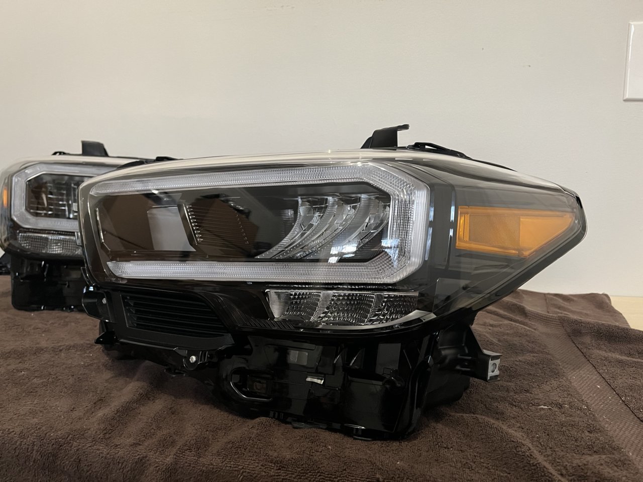

    “TRD” and “PRO” badging and black vs chrome on the internals.
    Leaving all of us with the impossible decision between poser pro truck or ‘80’s chrome truck or spending even more to have @no vtec 4me bake and eject the badging to your brand new already expensive headlights.
    I think we are close to 50/50 on the split for this decision but at least aligned in terms of making the decision based on avoiding the part that bothers us the most.

    Has anyone done it to a base SR? I couldn't find any youtube video, but I'm guessing the process should be similar?
    From what I can see the SR doesn't have fender flares, so maybe slightly easier?

    SR and SR5 do a combined DRL and Turn signal off one wire which must then be de-multiplexed to explicit DRL and Turn signal wires. The current solution to that involves a timer and relay per side. I've gone over the design with Johnny a bunch and at this point have no better options though I'll keep brainstorming. I do ponder a purpose built sealed solid state relay with built in delay but I am not certain we could get the price low enough or the labor low enough to justify it vs off the shelf products. Unfortunately this all means that SR/SR5 harnesses are double the price of the TRD version.

    We did talk about that and it's not as nuts as it sounds. Rear to front T taps of turn signal is a super long run but it gets a clean turn which is all that's needed since turn overrides DRL. Then the front turn/drl can just be a direct wire to wire connection as it's 2nd priority, only honored when turn is off so it'll either be +12v or nothing based on stalk position.
    It's just the long run x 2 which is sub-optimal from an installation difficulty point of view.
    If it were my truck I might go that route. It would keep costs down a bit. And I suppose a 2 conductor run to one corner and a cross jumper to the other side.
    If there were a junction inside the engine bay post flasher, that's where it'd get more appealing.

    Since you're an end user with an SR who presumably doesn't have time or interest in building your own harness, think you'd like to weigh in on the possibilities?
    The current agreed-upon "best" conversion harness has a timer and a relay, at a rough cost of say $30-ish of parts and labor, maybe closer to $40, not huge but not zero and that's per side, same story with the other side, plus it means extra parts to mount somewhere in the engine bay.
    The alternative we are mulling over would involve one long run from the headlight to taillight, either two such parallel runs along the frame rails or one long run from driver headlight to driver taillight and another across the rear to the passenger taillight, providing a clean signal for turns to the front (without DRL mixed in).
    The question boils down to, would you pay more and mount more stuff in the engine bay or pay less and route at least one harness along the frame rail to the taillight and then another across the truck to the other taillight?
