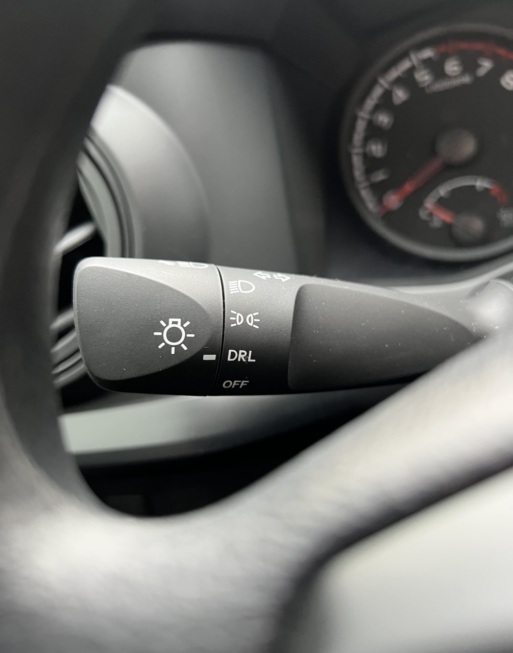

    Mine with SR convenience package and it has
    Tacospike and daveeasa like this.
