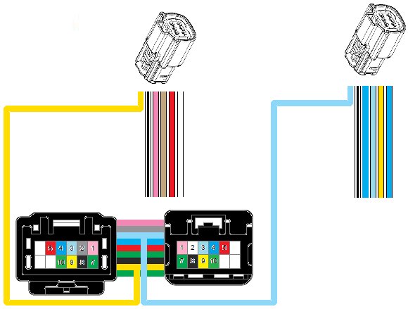

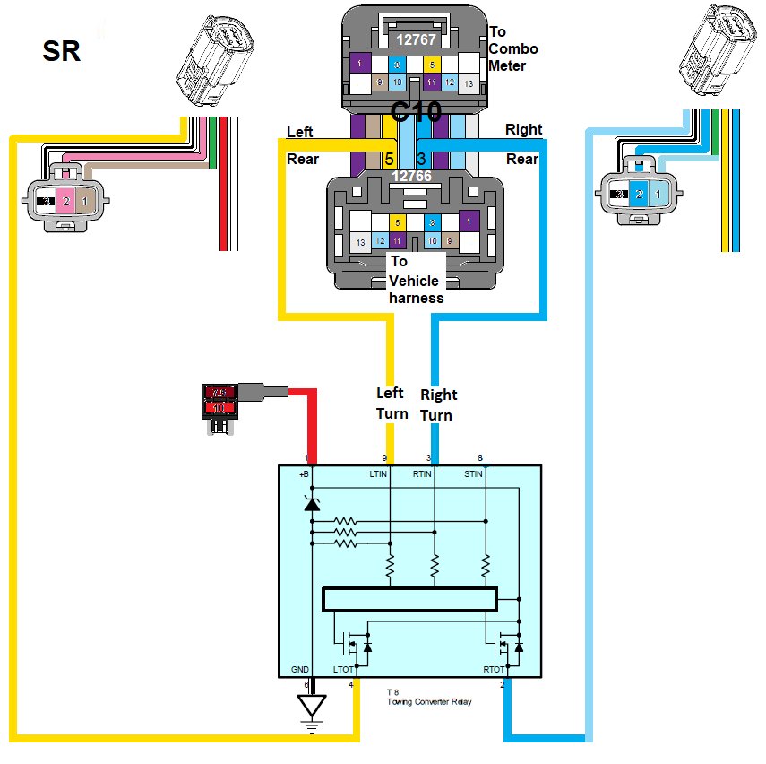

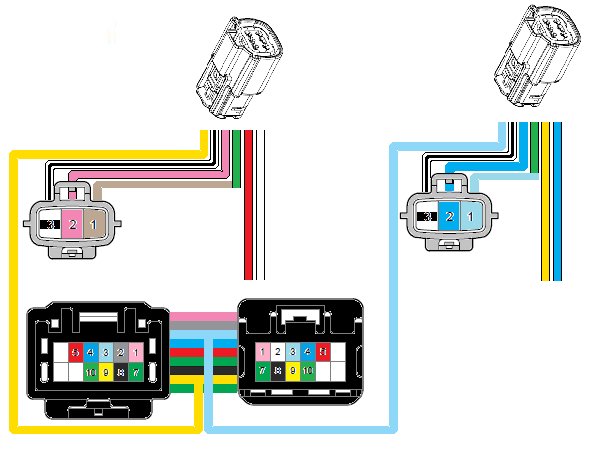

    That is achieved by the EB1 intercept.
    Erase what you see and "know" about Johnny's gadget.
    Look cleanly at the OEM circuit. You'll see my drawing is an almost duplicate. BTW, I worked a few already without the the intercept harness (EB1) due to owner not minding using posi-taps.

    Yes. The eb1 intercept is the key. The DRL can feed direct with no problem. No need for any extra there.

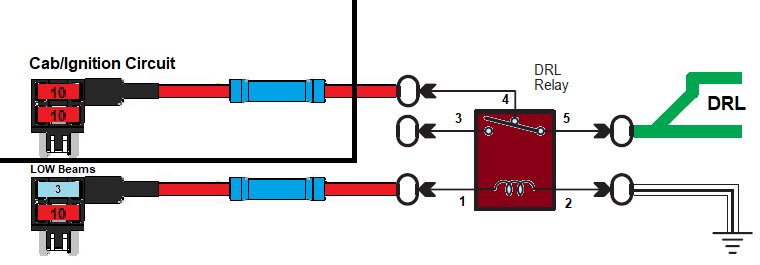

    Sorry, getting up to speed here. I have used EB1 for SR to TRD conversions. It is very load sensitive, and at over 2A, it overloads the rear circuit.
    @caribe makaira You can't just tap the DRL at the stalk unfortunately. It remains grounded when the Low Beams are selected. So you don't have a "Clean" DRL there. You would need to break that circuit when the Low beams are on. So that requires another relay. Also, you need to power that circuit constantly (at least when the ignition is on). So you have added a fuse tap and a relay, and assuming EB1 handles the load (which in my truck, it didn't), another tee that needs to be built. And to be built properly requires soldering or another creative solution as the 060 won't take two 16awg wires (or a 16 and a 20) so you either under size the wire feeding the rear turn signals (and given that the wire is that size for length as well as amperage, I would advise against it) or have to solder a tee together. Maybe milspec would work here, that I haven't tried. I chose solder on the ones I built. But these things are pretty labor intensive already. What time it takes to program and crimp timers to me was the better option. Also, I have had zero failures beyond a few that ended up needing resistors. Not to mention ease of install. Here are the directions I did for installing that EB1 tee if anyone is interested: SR/SR5 to TRD headlight conversion harness | Tacoma World Post #5 is just running that tee. You'll see it is longer than my whole post on how to install the SR to OEM LED harness I currently make. In my trials, replacing the rear with an LED still wasn't enough to overcome the load issue. That was just using a low resistance LED, nothing load equalizing. The OEM LED turn signals have resistors built in, that is why no resistor is required on the TRD conversions. The resistance of the OEM LED equalizes the load to that of a 7440 bulb (25W, or just at 2A). The reason I am including resistors on the new design going forward, is the SR is looking for 28W. Now, if you are anything like me, you are thinking "3W ain't nothing!". And generally, that is true. But it is enough of a difference to cause sporadic hyper flash.
    @daveeasa We can grab EB1 for turns, but see above for why I opted not to do that. I can build these though.

    1F_30 is NOT the stalk. Where did you read I was using the stalk?
    Another DRL I've used.

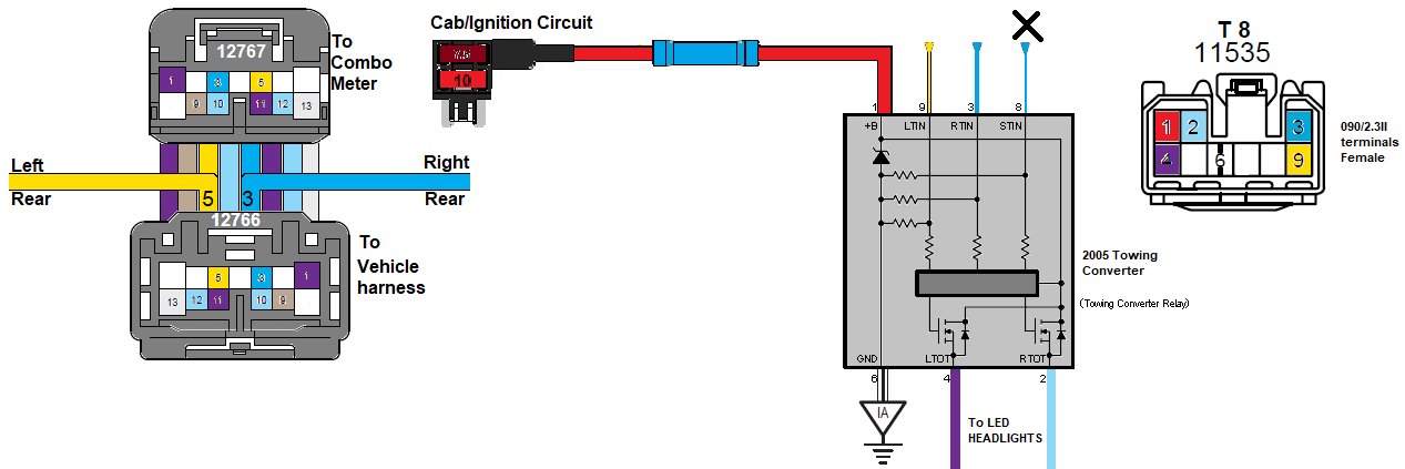

    "Clean" turn output with own fuse.
    C10 Intercept to 2nd Gen Towing Converter (no Stop Circuit Input [8])

    Sorry, misread it. Still need to get turn signals to it. So you are left overloading EB1 or turning off the DRL. And if you turn off the DRL, it defeats the whole point of going to the ECU since it turns it off there
