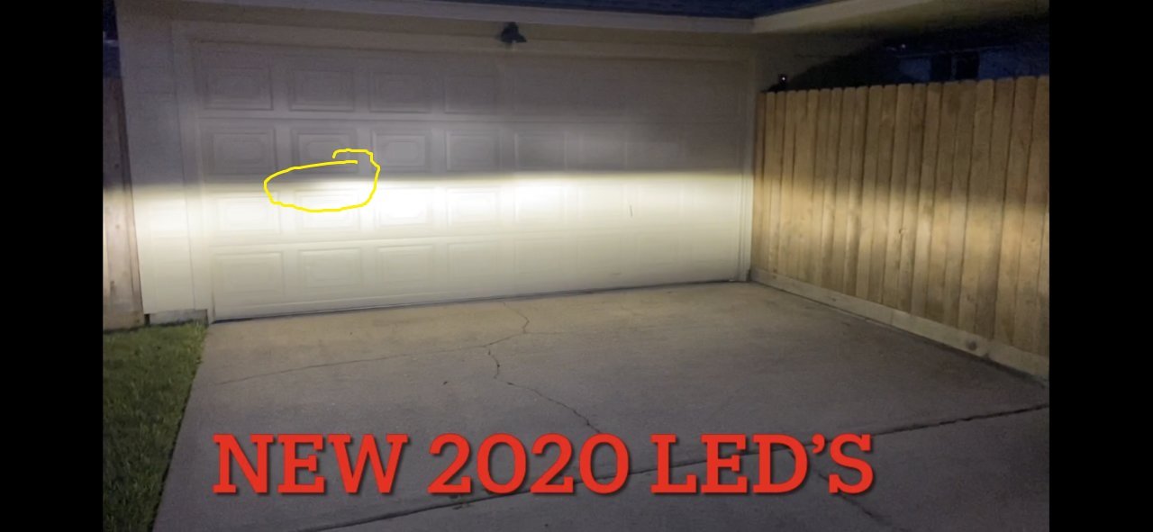

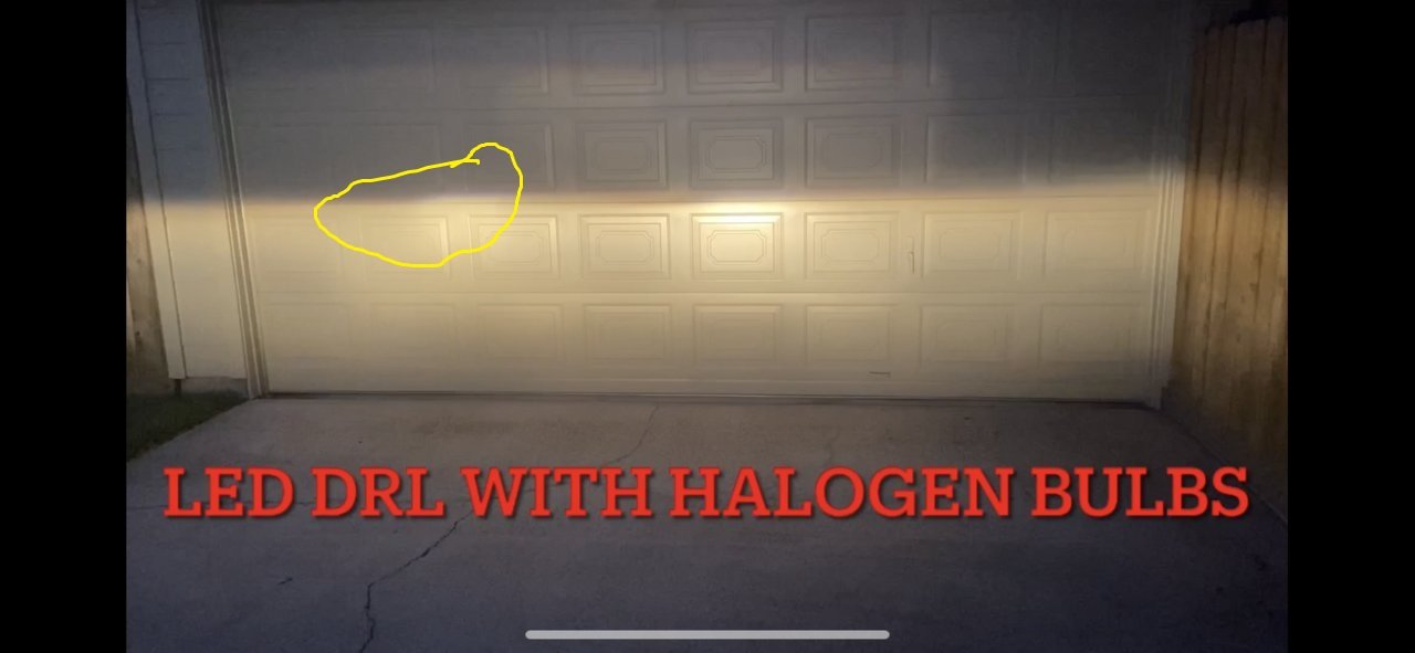

    Can the lights be adjusted horizontally? When I cover one lens at a time, the beam patterns aren't symmetrical left to right

    No. Are they mounted correctly at all four points?

    Everything looks ok but I'm going to loosen all of the bolts and reset them tomorrow morning

    No horizontal adjustment on these. The driver side is intentionally notched for oncoming traffic. Align the hot spot vertically per Stern’s article, use the brightest part of the beam which is higher and toward the midline.

    So the cutoff should be a little lower at the far left on the driver's side?

    There is a slight notch on the driver side inherently built into the light where the beam cuts off if this is what you're talking about.

    Yep, that's it. These LEDs are so much brighter I must not have noticed it with the halogens. Thanks for the info
